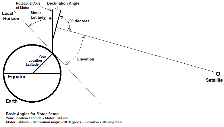

Someone mentioned 3 degree Declanation adjustment for my area. But, if I'm looking at the right chart, I come up with 7 degrees for my latitude of 47.18. So, if im thinking right, since top of arc angle is 35.8 degrees, then the elevation should be set to (35.8+7) and the declination adjustment should be -7 degrees. Yes?

Here are some angles related to setting up a polar mount to track the satellite arc. In the picture the Rotational Axis of Motor is also the rotational axis of the polar mount.
The dish looks out at 90 degrees with no offset.
