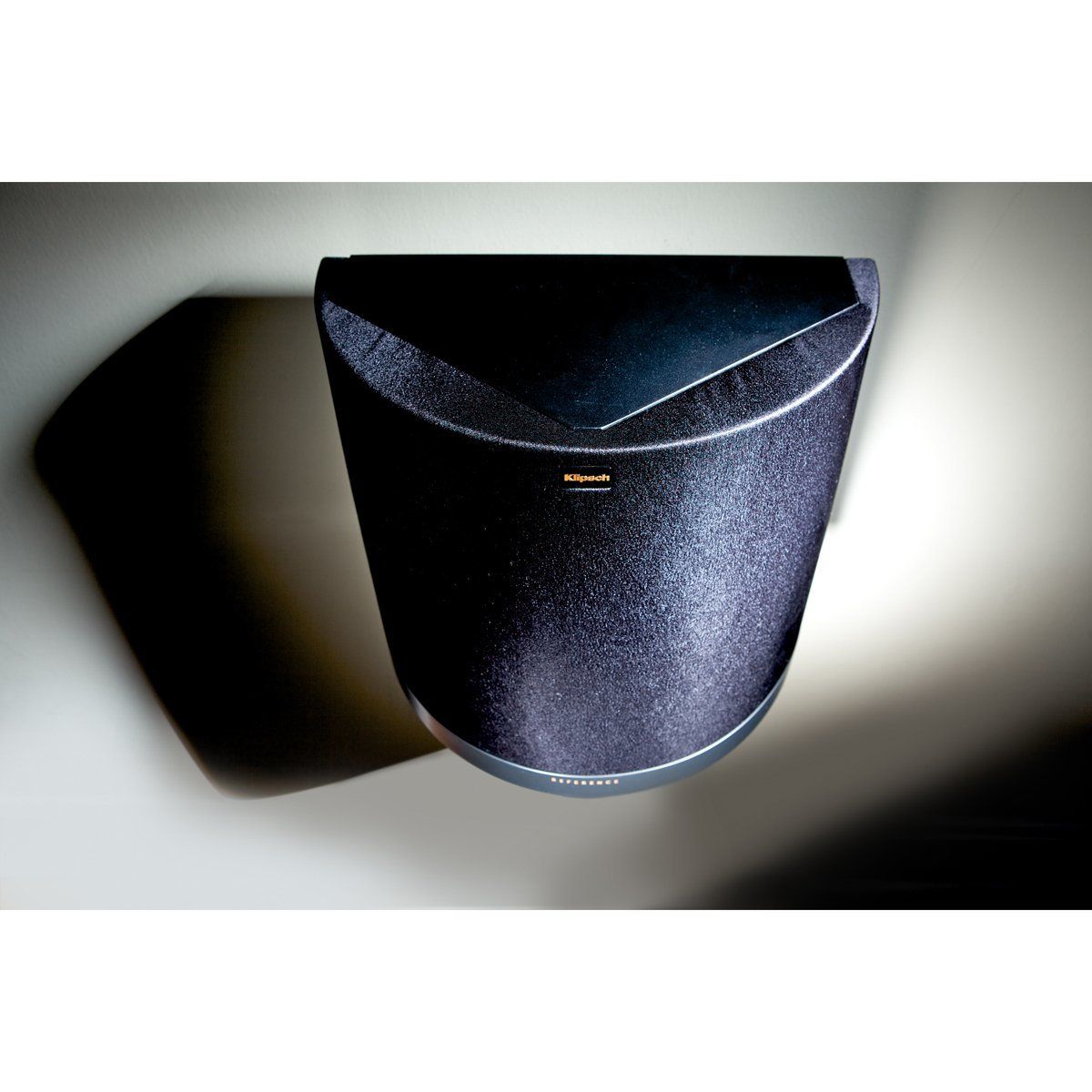

New question. If I chose to use these as my rear surround in a 5.2 system:
And have two rows planned (3x3 chairs with a riser for the second row. Should this type of speaker be mounted even with the area between the each row, to disperse equally to both rows, or even with the back row?
Klipsch shows mounting them up on the wall to each side of the listening position, but then says back wall mounting is OK. I was guessing 3 feet above ear level, side wall, even with area between first and second row was right...

This layout has them to each side of the room, kinda how I was thinking. I guess you could add one more to the back wall, firing forward, for 6.1.

Thanks, thats the diagrams I keep seeing.

you have to be careful where you place them. ideally they are to the side and behind the listener in a 5.1 system.
if we consider a line from front to back at dead center of the room as 0 degrees you want the surrounds from 135 to 150 degrees for both rows.
Do the best you can based on that guideline.
