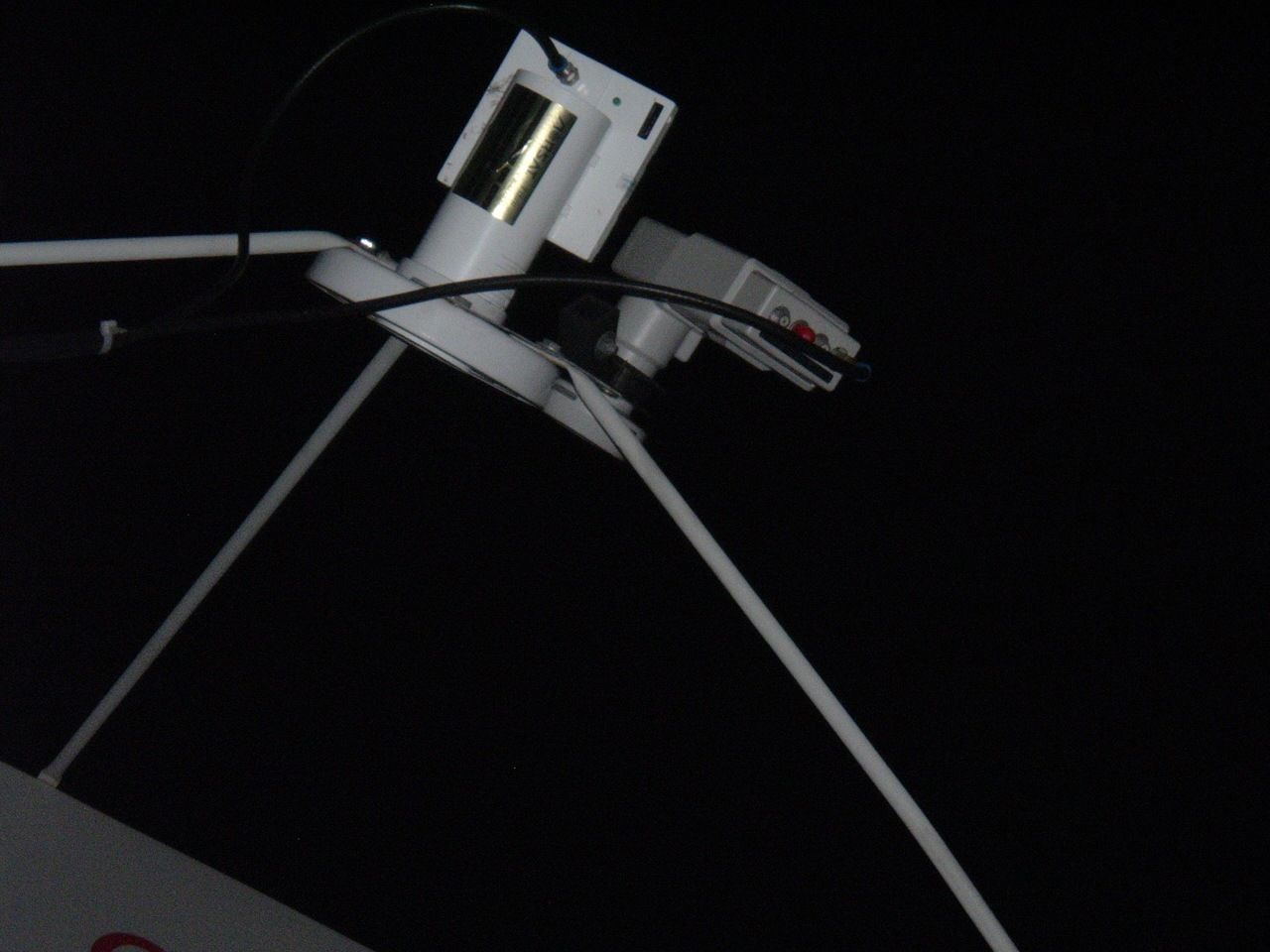

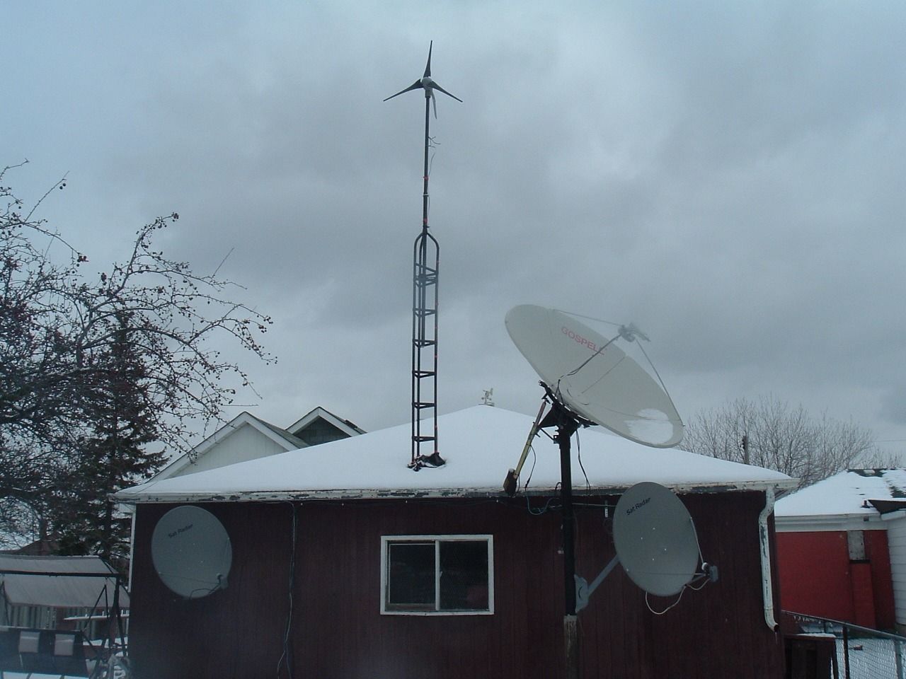

I hooked up the old pansat 2500 and the results are much better. I also tried a different lnb for c band. I have a some pics of the 6' dish that i'm working with before the c band lnb and after. Thanks for your help.
when cruising thru some Chaparral stuff on net I ran across a dual scalar mount they make
for C and Ku band. I cant find it on their website but know they make it.
It had the blue caps in a sort of figure 8 with the larger center throat being the C band.
The wind turbine is a air x 400 watt. This picture is fairly old since I now have solars as well powering my garage. My fta setup for the big dish is completely powered by wind and solar. The only problem with the air x is when the wind is above 20k it becomes fairly noisy for residential. No complants yet so testing will continue.
