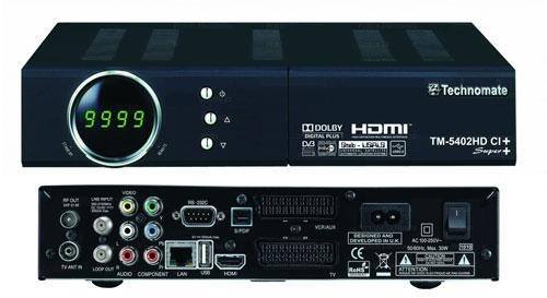

i will be getting my new technomate TM-5402 HD Super Ci+ soon ,shipped buy my cousin in Portugal.
now do i change the power cord in the back like the azbox to make it work in north America? TM-5402HD-500x500.jpg
According to the specs (SMPS power supply, 100 to 250V 50-60hz) hxxp://www.technomate.com/viewproduct2.php?product=81 Cutting off the European plug and putting on a N.A. plug should be all you have to do.
