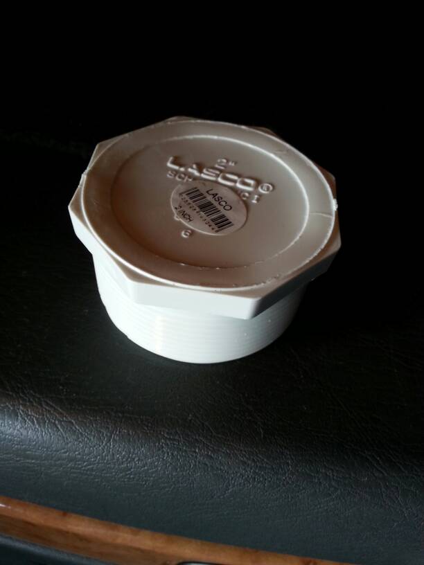

I bought this 2 inch plug at Lowes this morning for the modified pole mount. The thread part measures 2 inches, where the cap part it 2.5 inches, so it should just sit on top of that post for support when I bolt down the dish clamp around it. This is about all I can find there for the size I need and not crush the pole down. Hopefully this will work better than nothing at all. :-)
