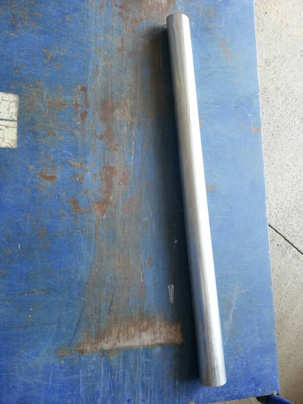

3 foot long 2.5 inch diameter galvanized steel pipe to go over the existing j-pole. Will this work better? :-)

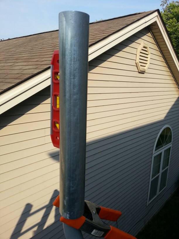

I cut the pole down to half of what it was, this should still be plenty long enough, just have to drill holes and run bolts through hopefully.

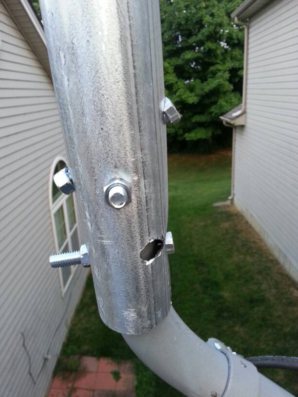

Well, that didnt work. Drilled holes through the pipe, run the bolt through, tightened it, the whole thing was looser than a drunk goose!! Back to Lowes a third time to get back the U-Bolts. :-/
Snap a photo of the bolt holes. Top and bottom bolts at 90 degrees from each other and the center bolt at 45 degrees will lock it place. You did go with a larger pole to sleeve than we recommended, so you might add a 4th bolt in the center on the opposite 45 degree.
Your getting solid advice. The guys on this forum(including myself) have installed thousands of dishes over the years, so it isn't like you are alone and reinventing the wheel.

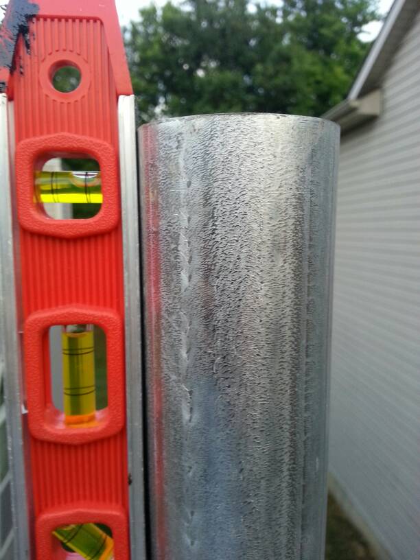

Bad news now is, its off level in two directions, so I will have to compensate for that in my elevation and LNB skew. Nothing much I can do about the off level now, pushing it doesn't help.

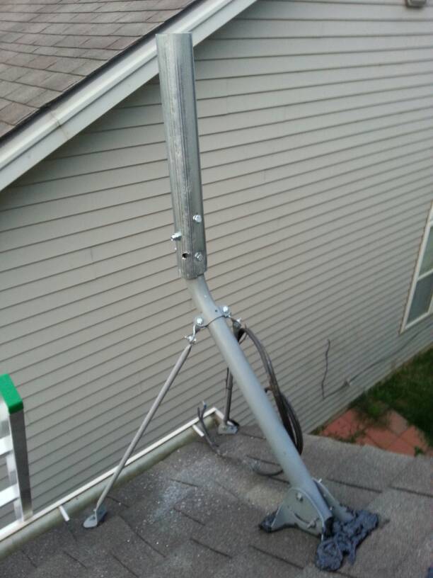

Looks like this, that's about all I can do for it, until more items arrive. I need a shower.

Yes, drilling and bolting at an angle would take the post out of plumb. No worries since you are not mounting a motor. Just add subtract a few degrees here and there...
I drill and bolt on horizontal axis. Here is an image looking top down:
