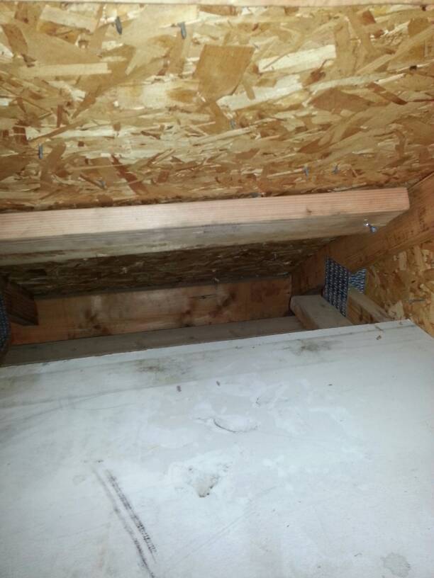

Added a piece of stud for the one lag screw. Since the other 4 lag screws are in studs already as far as I can tell, the mount should be secure enough.

I am waiting for a roof pitch pad to arrive this coming week, I will bolt up an additional brace into this stud when I get there. :-)

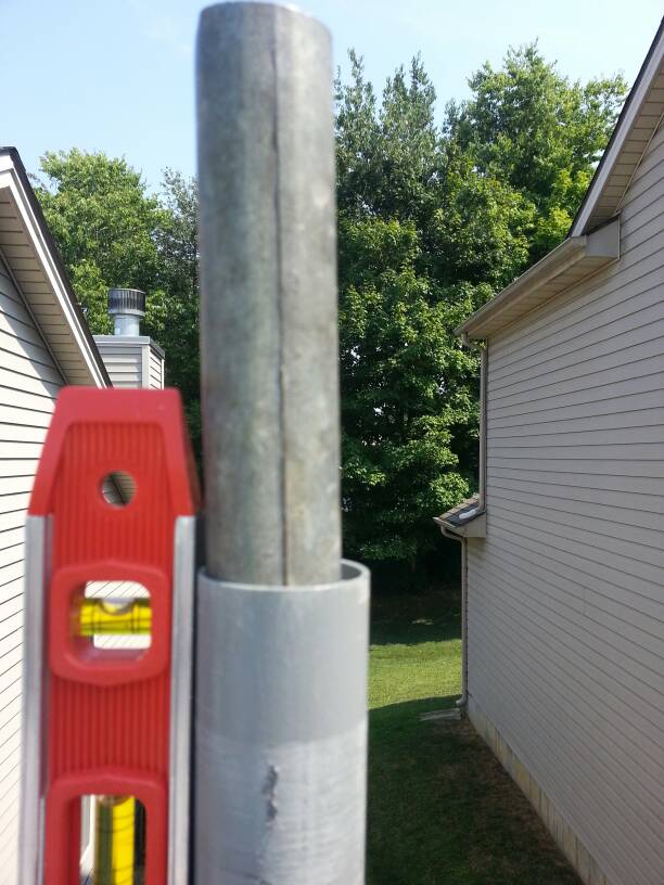

I aligned the J-pipe, it was off level, as you can see, the dish will be looking right through the big trees. I tightened everything down, and measured the j-post, it's the 1-5/8 inch variety. I added a smaller piece of metal, dont know if its galvanized or not.

I will head to Lowes and see what I can find. They told me they aren't sure if they can cut a pipe like that to size, much less have it all fit in my wife's little Honda.

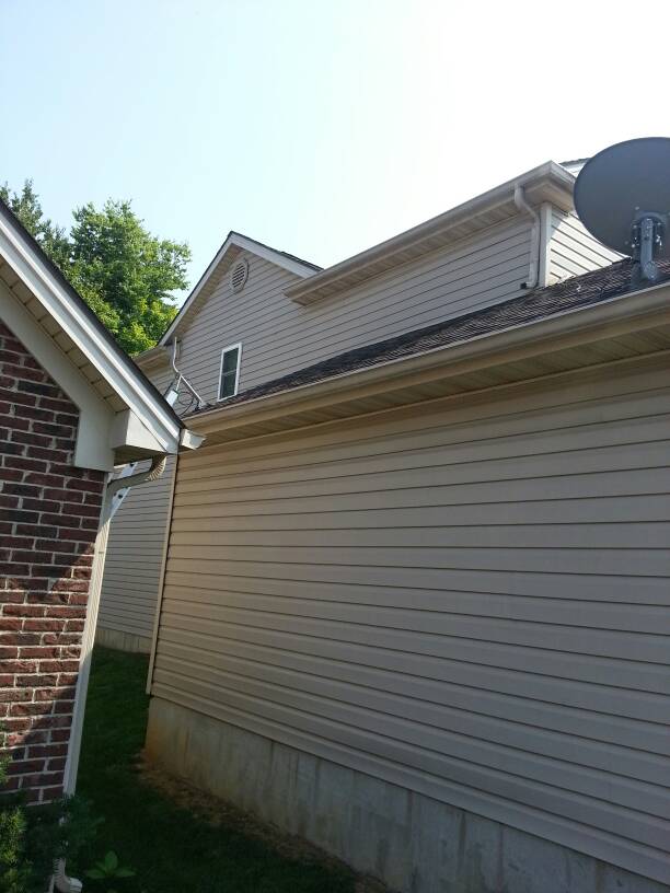

This is the east side of the house where the 1.2M dish is going to go. The majority of the winds come straight from the west and break over the higher peaks of the house. So the winds really wouldn't be much of a factor being that's its sheilded.
