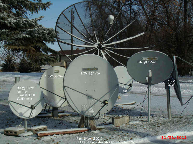

If your's looks like a radio station, mine must be looking like a deep space listening post.View attachment 99614
(Right in the front yard just off the sidewalk)
What satellite for a good chnnl selection? 99W on C and Ku. But unsure if the C is miniBUD friendly.
If you do find a 1.2 meter - I don't think I'd put it on the roof. But in the yard - and maybe paint it to blend in or stand out. Don't need 60 mph winds on a 24 sq ft sail up there.
Has anyone tampered with your dishes since they're so close to the sidewalk ?
In many neighborhoods, the location of those dishes would make them targets for vandalism.
