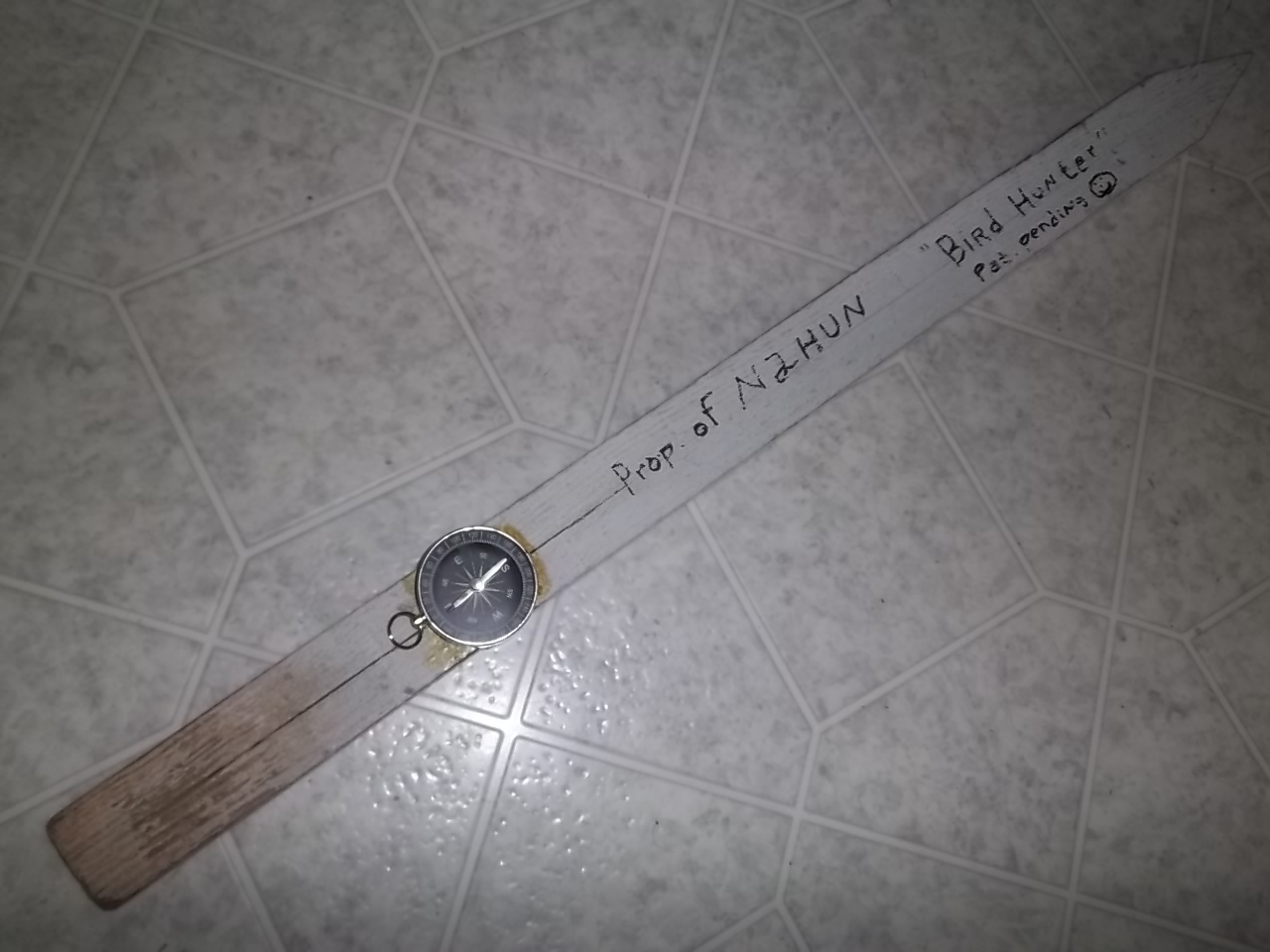

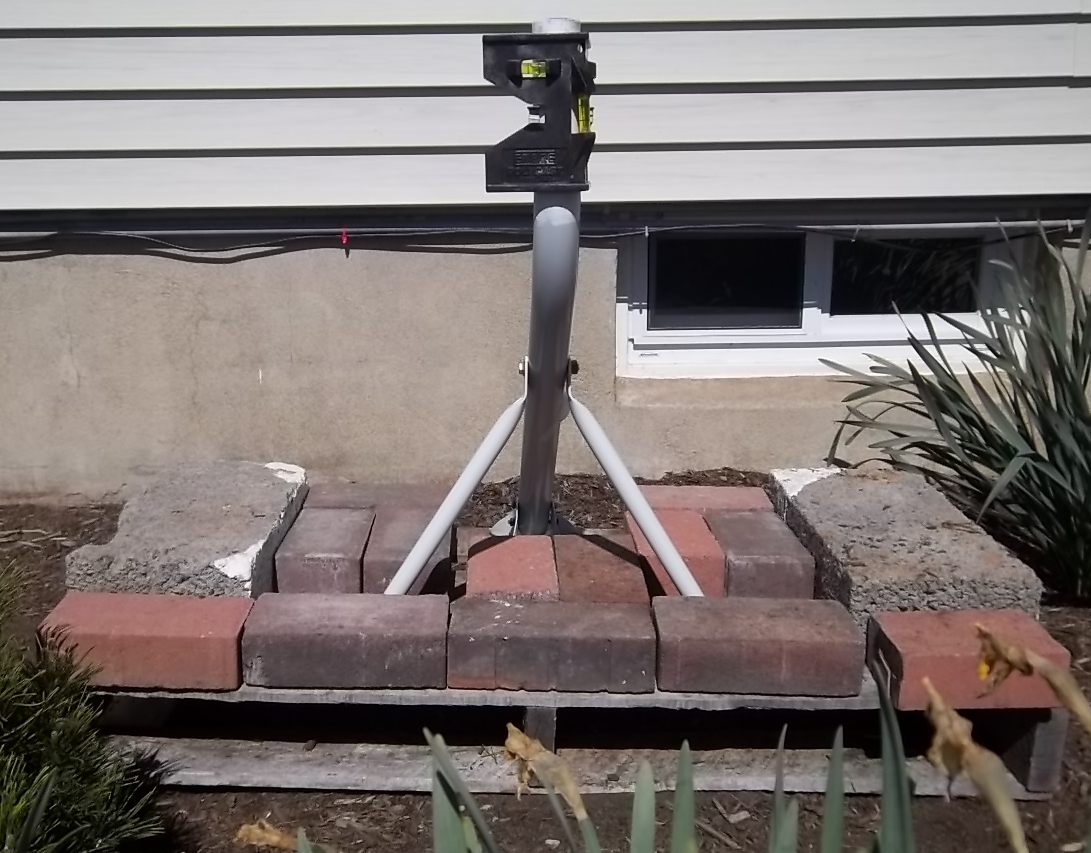

Welcome to the hobby. Keep at it. When I first started in the hobby 12 years ago it took me 3 months to find my first satellite. But, I was working completely on my own and in the dark. One thing I found out pretty quick was that the location of your dish will affect reception. Moving the dish a few feet can make a difference so I used a dish mounted on a wooden pallet weighed down with bricks and tried different areas of my 3/4 acre property. See photo - note that a liquid level is attached to the mounting hardware to assure the mount is plumb. That is important.
Also, I found that a compass is very helpful for aiming your dish in the general direction of the satellite. Use a lookup table (found on-line) to determine the azimuth of the satellite from your location, then use your compass to point in that direction. Note that lookup tables give you a choice of true- vs. magnetic azimuth. It's easier to use the magnetic azimuth IMHO for pointing your dish. I use an old liquid-in-glass compass (see pic) attached to a stick for pointing. I've also used digital compasses and they work fine but have to be calibrated prior to use.
Hope this helps.
Reactions: KE4EST and FTA4PA
