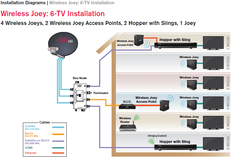

I know this thread is kind of old but I came across some Wireless Joey diagrams and thought I'd post them here. These show how you can use a HIC in order to get more range from the Wireless Joey.

what is the normal range and how much do you think this adds?
thanks
I'm not sure on the normal range because it depends on the house but by using the HIC you can extend the range about as far as you want. Just need to get a cable off the client port of the node to the HIC and then connect the WAP to the HIC. This allows you to get the HIC and WAP to the closest point to the Wireless Joey for best performance.
