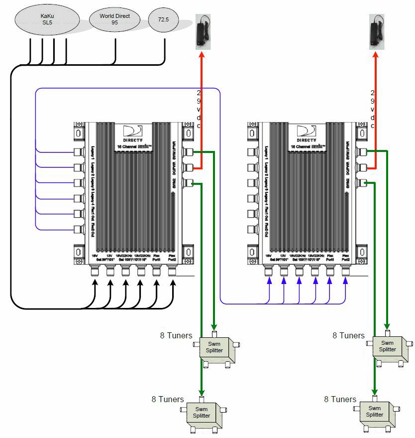

You can do it with two swm16s daisy chained. That will let you run 32 tuners.
Really? No weird crap? What about features such as Whole Home DVR? Where would I get the SWM16s? If I was daisy chaining, wouldn't I have to give up one of those output ports? How would the exact setup go? Etc.

I attached a graphic. You wouldn't need the 72.5 and 95 orbitals of course. So it would just be four lines from the dish.
That is INCREDIBLY helpful! Question though, what I have to get the LNB replaced with one that has four lines out? I have one that is the SLS3 (I believe) with one output line, but, I assume that would NOT work in this case. Also, could I get an SLS5 and make that work somehow? Sorry again about all of the stupid questions! Again, that graphic is IMMENSELY helpful!

The SL3 LNB,whether SWM or 4 cable output,covers the 99,101,& 103 satellites(covers 3 satellites). The SL5 LNB,again whether SWM or 4 cable output,adds 110(which doesn't really have anything on it anymore) & 119(which is where Spanish programming,some PI channels,like the Jewish Channel,& some local channels are located) satellites(covers 99,101,103,110,& 119 satellites).

That said, one last question, since the SL3 or SL5 would theoretically work, I guess I would just run the single line in to the SWM16 multi switch to a single port. But, which one is the question? Are there any special configurations that need to be done? Or does the multi switch automatically pick up that the LNB the line is running in from is picking off of all applicable satellites?

You can't use a typical SWM LNB on a SWM 16. You will need 4 lines from your LNB to the switch as shown in the pictures provided
That's kind of what I figured. So is this essentially the only way they do it for larger installations? How many tuners could you run off of one of the one line LNBs with integrated multi switch?
