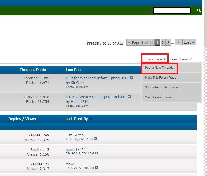

see attached: when you are on the DirecTV thread "home" (not in someone's post) just click the FORUM TOOLS drop down and select POST NEW THREAD in the far right side of the page
