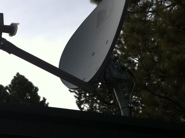

Slimline Multi-satellite dish with integrated Ka/Ku LNB's & built in multi-switch
slimlinephoto4.jpgslimlinephoto2.JPGslimlinephoto.JPGI have an opportunity buy a HR24-200 to replace my D12 non-hd receiver but don't know if it will work with my current slimline dish.
Can one of you experts advise me on this?
:welcome to Satelliteguys!
Yes, your HR24 will work with a Slimline dish. Depending upon your setup you may need other equipment. Do you have a SWiM lnb or regular? How many other dvrs/receivers do you have?
No other receivers or DVR at the cabin other my D1, two coax cables coming off the dish with a regular lnb
Does the dish say Slimline on it?
Never mind! I just saw the picture you added. You should be able to simply exchange the D12 for the HR24. Both cables from the dish must be connected for both tuners in the dvr to work.
Most directv dish photos I've seen while researching this normaly show 3 LNBs, is this single LNB going to give me good HD quality?
Yes, this is a newer SlimLine with 3 SAT capability housed in an all-in-one LNB array; 99, 101, 103. It is perfectly fine.
Thanks for your help
One last question..... In satellite setup on my current receiver, the dish configuration is set to 04:Slimline 5, will that be the correct setting on the HR24 as well?
One last question..... In satellite setup on my current receiver, the dish configuration is set to 04:Slimeline 5, will that be the correct setting on the HR24 as well?
IF this Slimline is a SL5, your fine ...
How many Sats are you recving, 3. 99, 101 and 103, or are you currently seeing the 110 and 119 as well.
If your not seeing the 110 and 119 (which is what I'm guessing) you'll want to change the setting to Slimline 3
