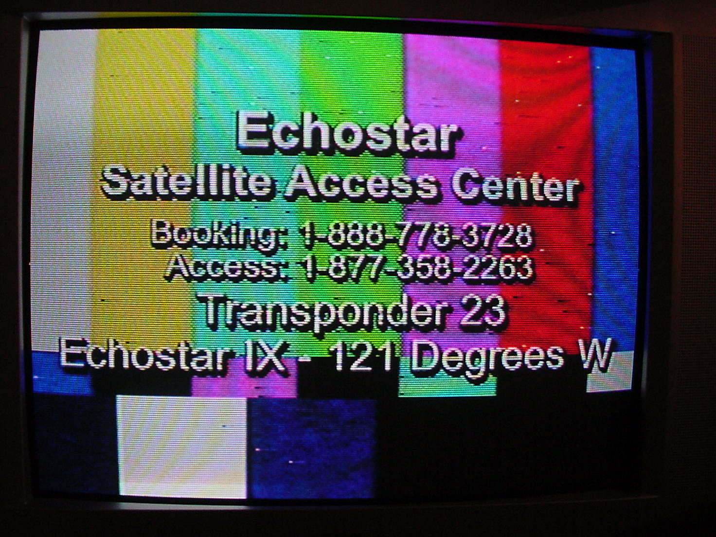

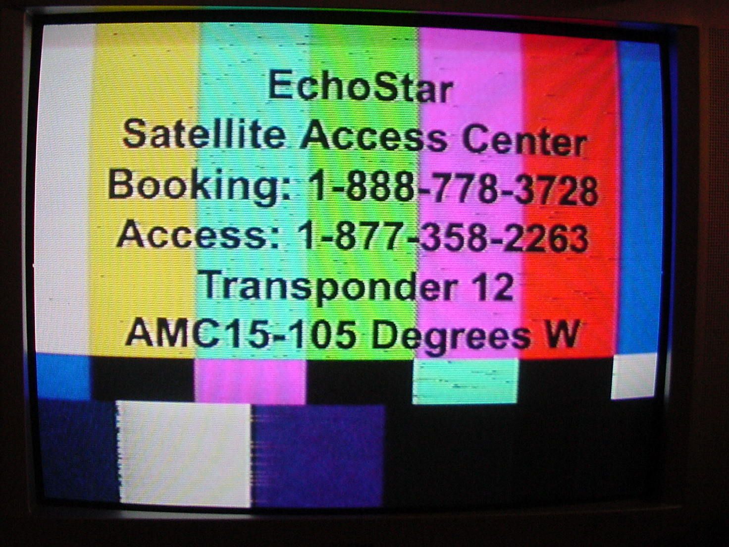

I'll post some pics of active Test Cards and Satellite info, just so you can test and play around with the receiver.
Maybe we can all learn something.
Good Thread by the way.
Ok here's 2 test cards on 24/7, just click on the picture all the info is there.
