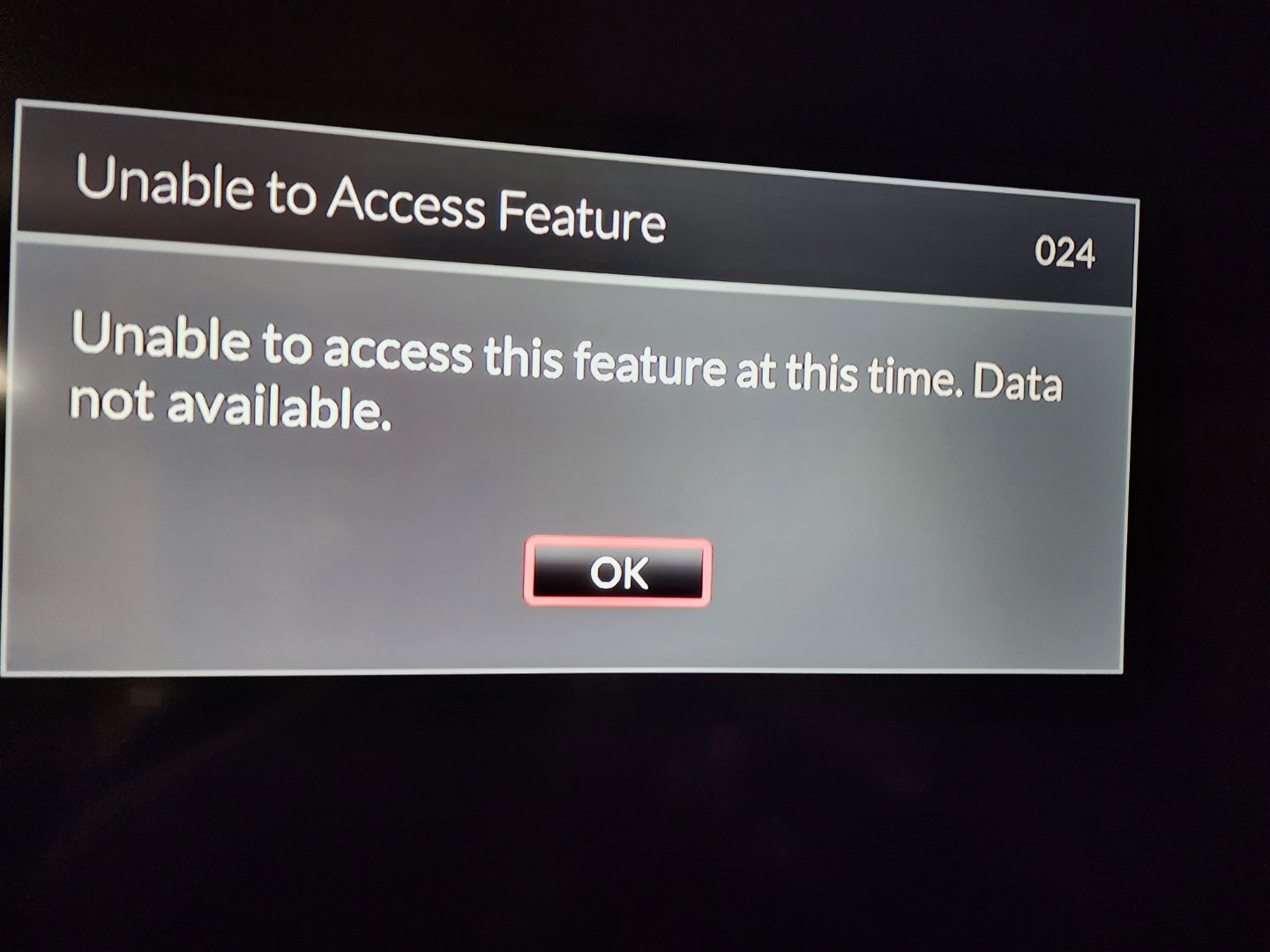

We just had super severe bad weather roll thru the St Louis area and lost Sat signal. In the past when this happened I would go to the guide and select an OTA channel so we could monitor the local TV channel and follow the bad weather. Doesn't work any more. I get a popup that says can't access this feature. This is happening on both my Hopper Plus and Hopper 3. I guess I will have to install a 2-way switch in the OTA cable going the Hopper and run a second cable direct to the TV.

I tried everything. I did not have Sat signal for both Hoppers. The only thing that worked was the Hopper recordings folder & I could also get to the apps thru the home button. So we watched recordings & apps. Reason for no sat was a GFCI had popped cutting power to the DPH42 switch. Sat signal working good now. In the past I could always get to OTA local channels thru the guide when sat signal was lost. This needs to be fixed.

It might well be that your issue was caused by no power to the 42 switch. That messes up the hybrid side of your Hoppers. You might have been able to reach your OTA channels if you had lost just the satellite signal. Just musing here.

Good point. When ever I get a no Sat signal outage again I will check it out. Thanks

Do you have your OTA direct to Hopper or are you using some kind of pass through?
Do you have your OTA direct to Hopper or are you using some kind of pass through? If the latter, you are using your OTA outside of the recommended installation. It works properly during weather events if connected directly.
OTA is direct to Hopper3 Plus and also my other Hopper3. What about the guide not available during no Sat signal condition? Could it be from no AC power to my DPH42 switch? See post #9.

Bobby brittanygarden, that was it. No power to the DPH42 switch caused the issue. We have real bad weather rolling thru the St Louis area and I lost Sat signal. Guide was still available to get to the OTA channels. Good idea Bobby.
