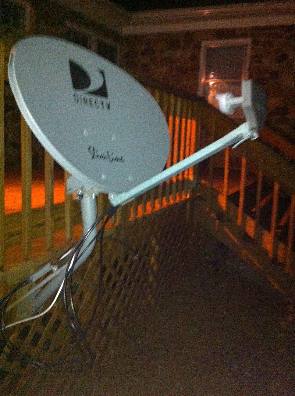

I have the receiver and this dish with Directv SL3K4NR1-03 4 Outputs pictured below
I cannot dial in HD channels, From what I remember I can't find 103 or 99 ( i may be wrong here ) and if I attach the BBC I don't see anything.
I'm thinking at the very least I need to purchase new lnb that is able to tune in 5 sats, and I may have to purchase a new dish. Anybody able to help me out here?
I can provide any more info that I missed, but I just need some direction from somebody who knows alot more than me.

Let's start at the beginning! Is your mast plumb? This is very important! Go to www.dishpointer.com and put in your address and change the satellite to multi-sat Directv 99,101, 103. This will give you the numbers for azimuth, elevation, and skew. Set your receiver/dvr to the 101 signal strength screen and see if you have any signal. Leave the bolts loose enough to move the dish without it flopping around. Move the dish a little at a time until you do. Give the box enough time to register any changes. Once you get numbers around 80-85, you are getting close. Push gently on the back of the dish on all four "corners" to see which way it needs to move and make the necessary changes. This should get you even better numbers. When they are mostly in the 90s you have 101 all set. Then check the 99c and 103ca and 103cb signals and repeat the previous procedure except when you adjust the dish use the little dithering knobs for the fine adjustments. Good luck and come on back if you need more help.

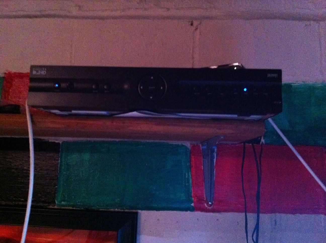

Reciever H21/200

If you have the SL3 LNB,you shouldn't be able to pick up 110 & 119. The SL3 only picks up 99,101,& 103. The SL5 picks up 110 & 119,along with 99,101,103. All of the HD channels are on 103 satellite. When you so "Satellite set-up",do you have it set up for SL3? Also,if you have the 4-cable out SL3,then yes,you do need to put a BBC between the coaxial cable & receiver. Do you have just the H21 receiver,or do you have a HD DVR which requires 2 coaxial cables hooked up to it?
Why don't you try satellite set-up with the BBC attached already,instead of what sounds like you did the satellite set up first,& then you put the BBC's on. Do SL3 on your set-up,DO NOT do SL3 SWM,which is the 1-cable LNB.
I only have the H21 not DVR

So got to adjust some on the dish tonight, got some HD channels coming in!!! woohoo
99 is coming in at 80 right now, but everytime I get it tuned in I lose 103. Just gonna take time and get things dialed in I believe.
Got it dialed in, thank you guys so much for your help.
Biggest difference was the correct dish choice and the BBC. although my BBC doesnt seem to screw in properly and I have to tighten it VERY tight to get it to make contact. Can I replace the end on it without causing problems?
