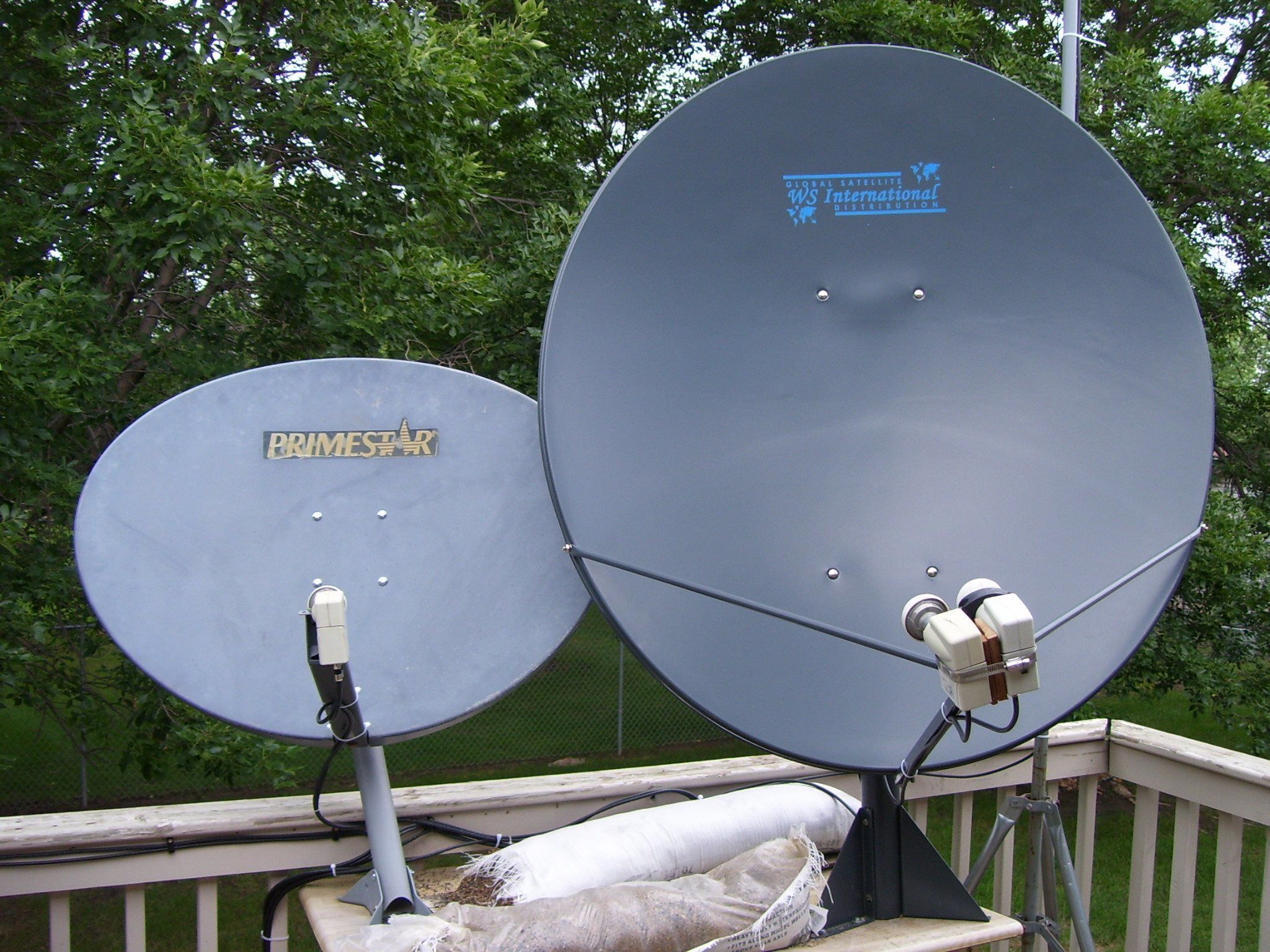

I have a 205 that was previously authorized (not anymore as I upgraded to 505) and I still use that receiver to tweak the dish for F2. I have 111.1 boresight and 107.3 on a 4 footer (dish on right)
