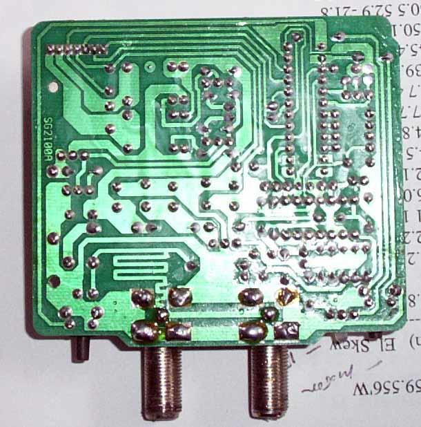

I think I found out why I had so much trouble ever finding a signal in the first place.
I noticed that when I was hooking up the signal strength meter that I had to rotate the coax connector to the left to get a signal and a polarization light? if it move to the right I would loose the signal!!
So I removed everything, disassembled the rotator(yeah I know) and found that all the contacts for the input and output coax connectors where loose?
after looking closely I discovered all 5 points on each connector had cold solder joints!!!! It almost looked as though the pins used a 'push through type of contact and relied on friction to maintain contact (POS). I looked at the quality of the unit and it was very good except for those contacts.
I soldered all 10 contacts and am now back in business. i mention this only because others have or will have a problem with this. I have a photo of these contacts if needed by anyone.
A channel that is actually broadcasting "LIVE" right now, glad to hear you got it going, thanks for the tip : ) Pictures would be nice.
Here is the pic.
