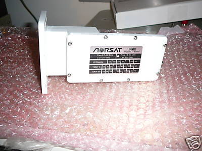

Guys I have a questions. I have used many KU types of LNBs but very new to C- Band LNB's
I have this Norsat 8000 Series digital C-band LNB 3.7 - 4.2 GHZ.
Specs:
3.7 - 4.2 GHz
60 dB gain
30K
L.O. 5.15 GHz
L.O. stability 500 kHz
My question is this LNB changes the polarity automaticlay ?
can I directly attach this LNB to the dish? Or I should use a feedhorne??
pls help.
when this lnb is attached to a feedhorn a servo motor changes the polarity
use a feedhorn , this is a c-band lnb it usually attaches to a polorotor or a corotor type feedhorn
