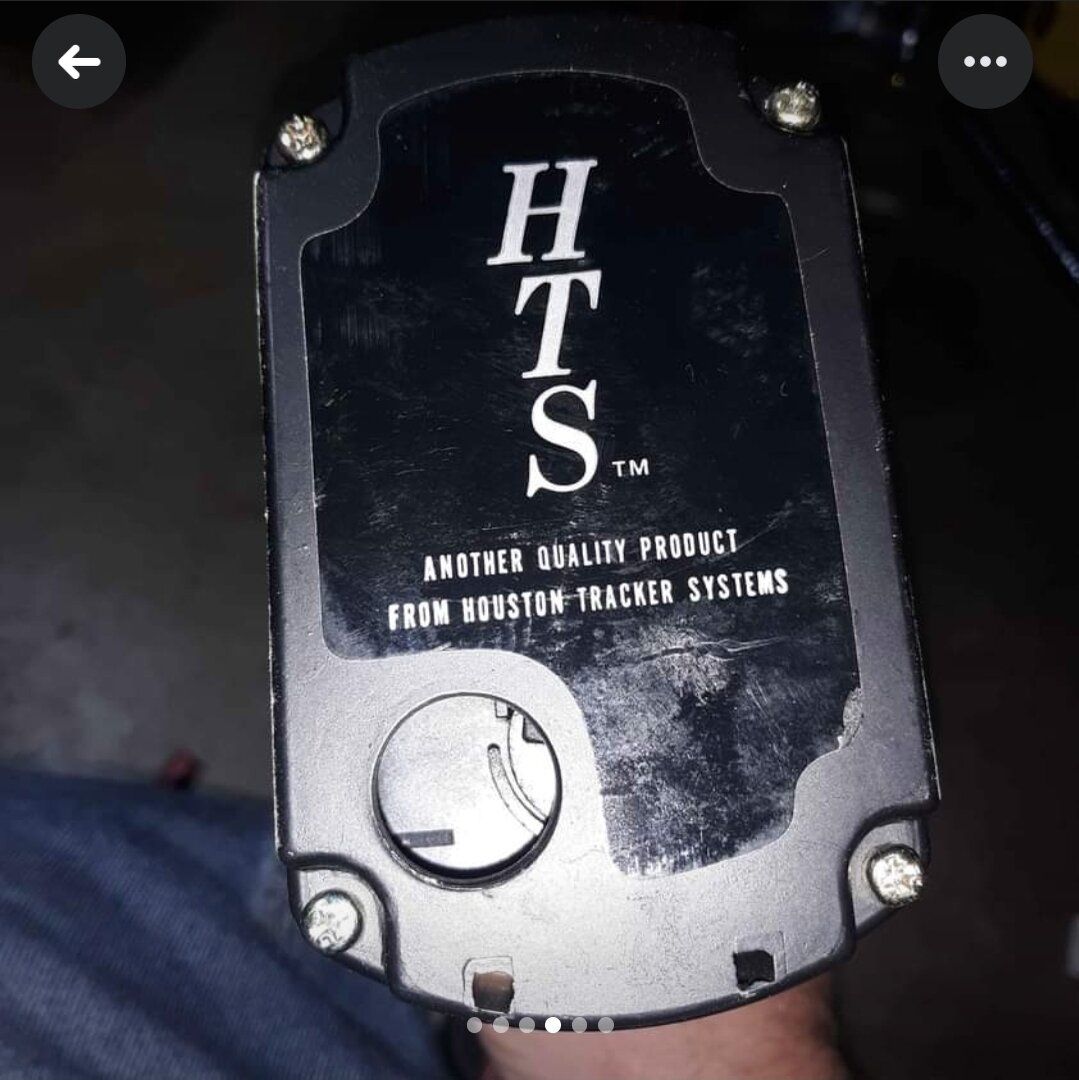

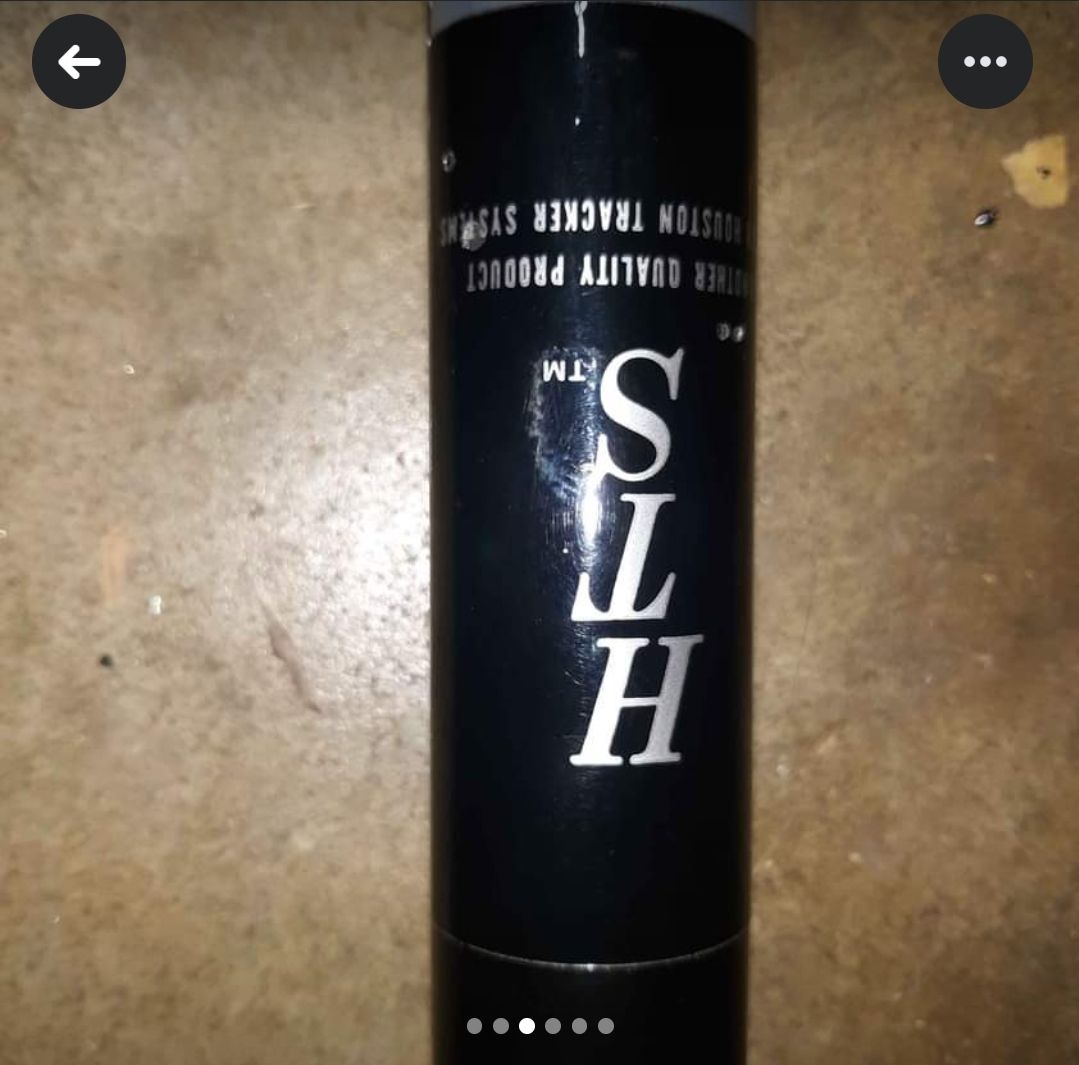

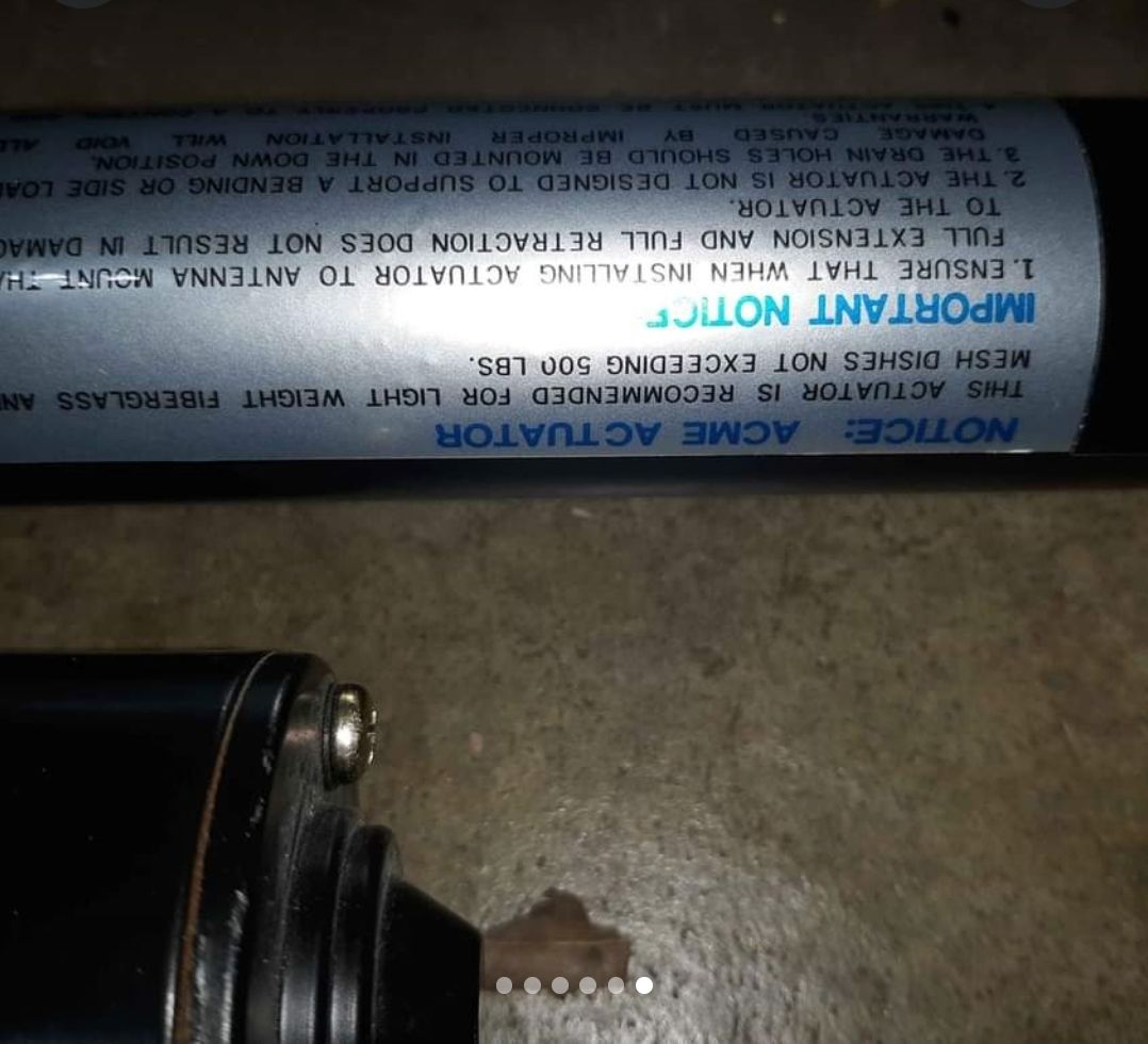

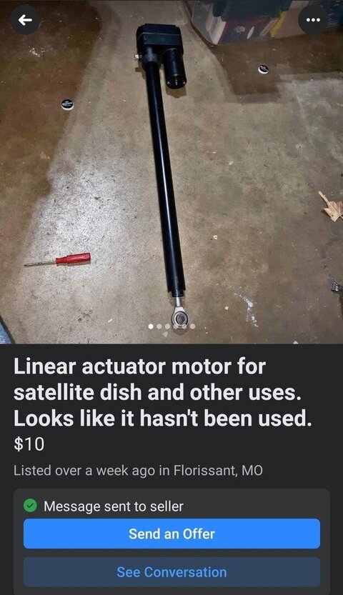

I just bought this and it is in transit. $10 +shipping was enough for me to chance it being untested. It looks new. Anyone know what company HTS sourced actuators from? Or perhaps they made their own?

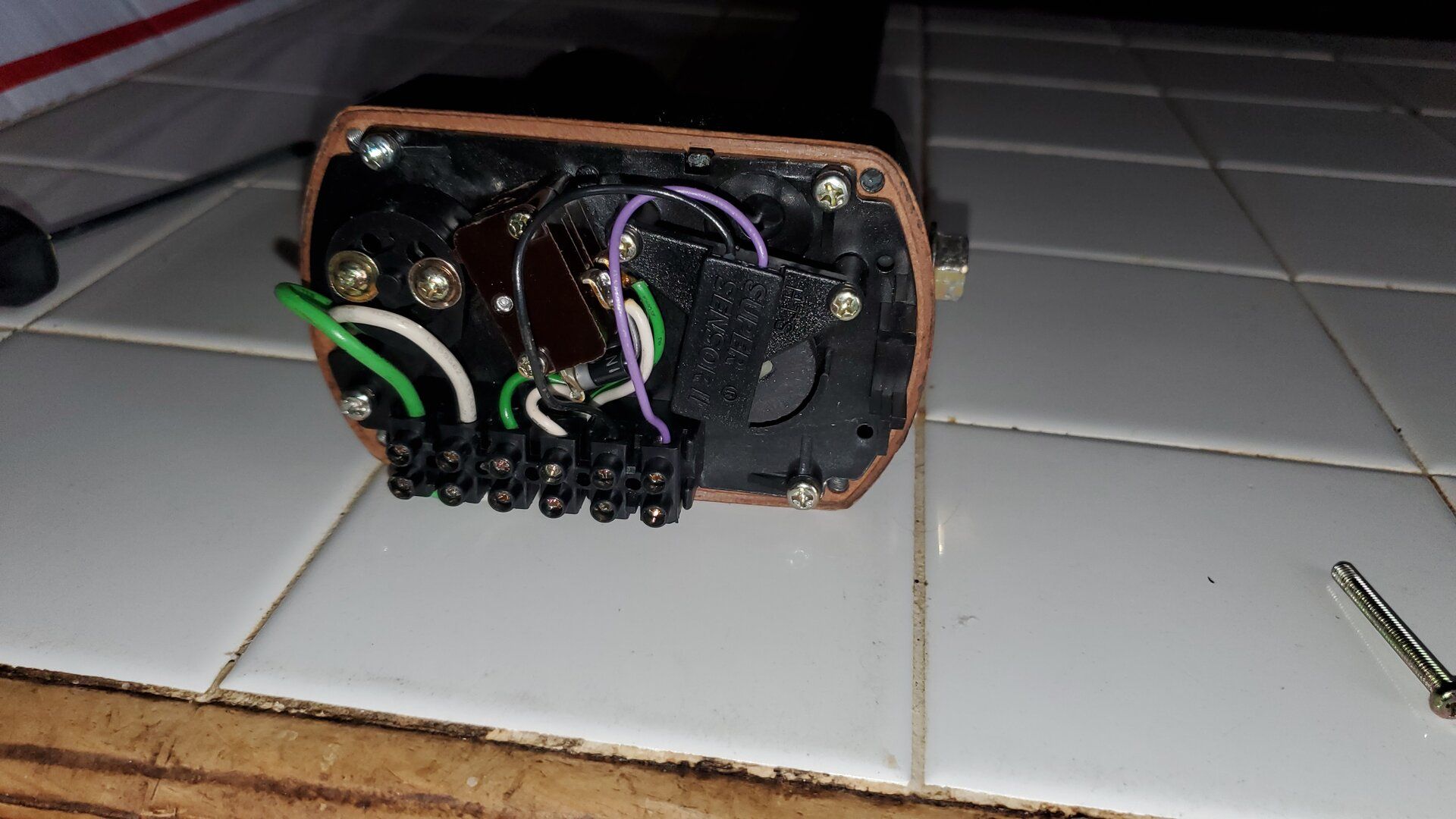

Looks like an original manufacturer Super Jack. Hopefully it's a reed switch model. Get a photo of the inside motor assembly, and we can likely tell for sure with that.
Reactions: FTA4PA
A 'Super Sensor II' is just a reed switch, so that's good. That might be a Venture actuator. It looks like a keeper anyway.

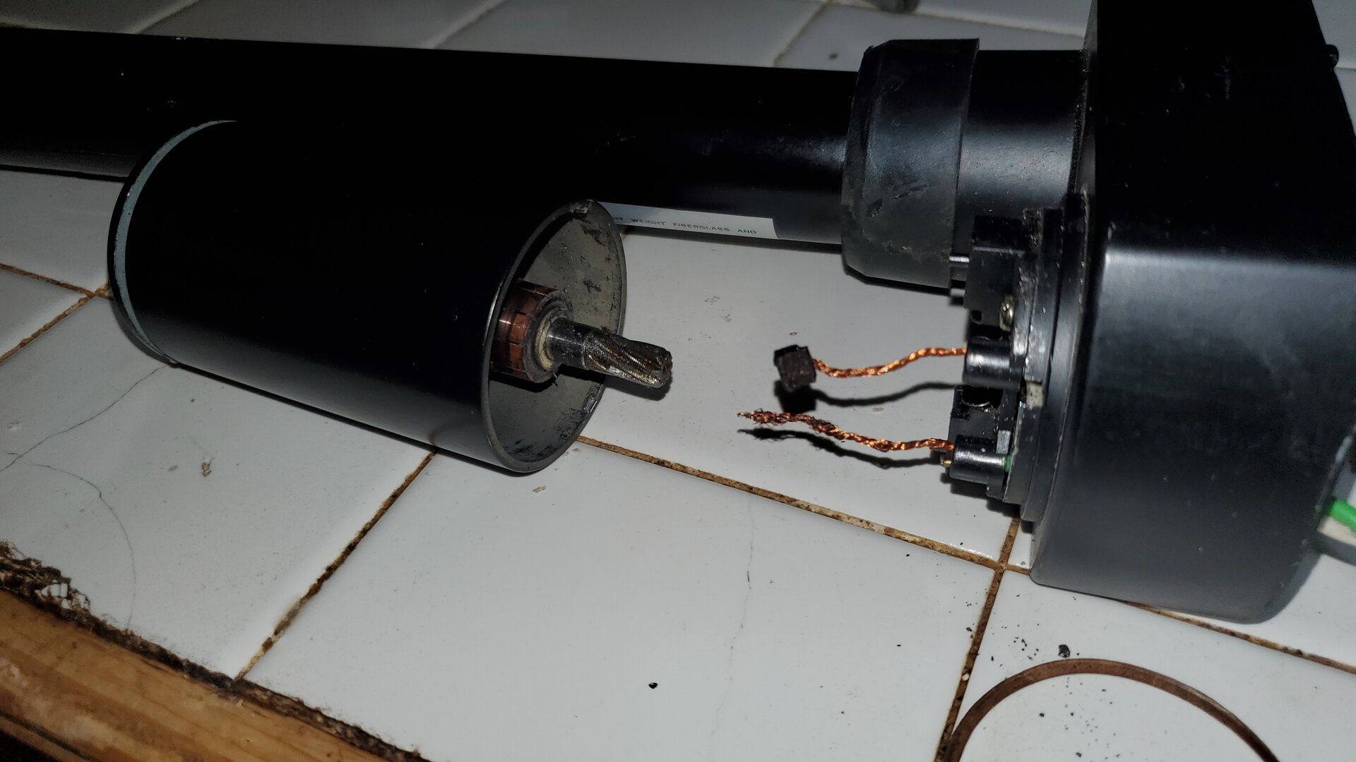

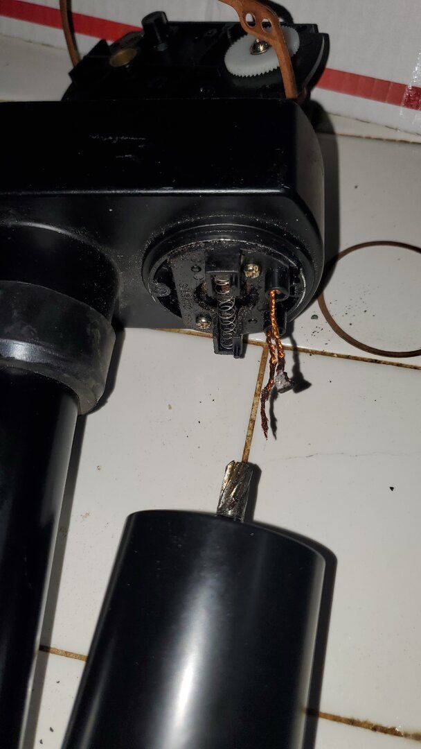

I started to smell a little bit of that "motor smell" and took it off... Well I had never done that before. I reassembled it the way I thought it was. And this is the result. These magnets are pretty well crushed. Is there any hope for repair? I feel like a huge idiot.

Yes you do have a problem. BTW those are not magnets, they are the motor brushes that pass electrical current to the spinning armature.

Wow, sorry to hear that. :( If you go to Amazon or eBay and search for the term 'motor brushes' you will get a ton of results. You may be able to find something that looks like the originals that will work for you. Worth a try anyway. :)
Older electrical shops carry motor brushes. If you can find one of those. Or, search Ebay, Amazon, or just Google for "motor brushes". Better yet, contact Venture, send them a photo, and ask them if they have brushes that will work. IF that's a Venture actuator, they might be able to supply them. Venture Mfg Co Contact Us Today!

My actuator was a 36" Digiwave. Both brushes were gone and one magnet came off. I checked Amazon and could not find the same brushes but close. I bought some brushes a little bit bigger and sanded them down to what I needed. I had to reuse the old springs because the ones that came with the new brushes were wider. I also reuse the old brushes wire with the connector because the new ones were different. I just cut both wires ( new and old) half way and soldered them. I also sanded the motor wall inside and glued the magnet back with two types of Cyanoacrylate: mid to be able to position it properly before it got stuck and then aded thin on the borders with a catalyzer. Let it dry for two days before assembling it back. Since I had to dissassemble the full actuator, I added new grease to the gear and lubricate every posibble part, plus remove all dust a repainted. It is working like new. My point is, don't be afraid to try to fix it. If everything else is OK, replacing the brushes is not a big deal. Just be carefull when inserting the rotor back to push the brushes away. You can use a small wood stick to push them apart.
