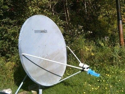

I am now a proud member of the 1.2 meter c band club :D Today I had some free time so I decided to slap a c band LNB onto my 1.2 p* dish. My mounting technique was quite complicated, consisting of a single zip tie to hold the lnb in the same place the P* lnb was mounted :)
After playing around for about a while, i got my first digital signal off of g16 (alas, not the networks). A few more minutes worth of aiming, and I was hitting Anik F1 with signal levels around 60%. Mind you, this is without a scalar ring of any type, and with an old 65 degree Drake LNB. Also, I didnt really have time to properly peak the LNB, I am sure I could have done better with higher resultant signal quality.
All in all a fun afternoon project, next time I try this I am going to have the proper scalar ring and a lower noise temp LNB.
Attached is a pic of the p* with LNB ziptied in place.

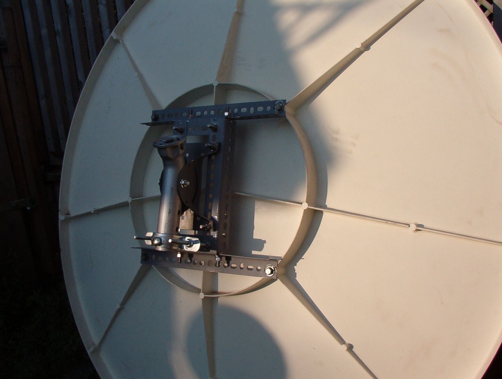

I have one of these dishes too and I actually got the Andrew C band feed horn for it. I since taken it off but I had pretty good success on the newer Cband birds. I put the Ku feed back on because I wanted to see KU. Anyway has anyone figure out a way to make this dish steerable? Andrew told me No but there may be some after market thing. So anyone got ideas? Mind you I don't have a metal shop or place that can make me anything I am hoping someone figure out something though. Thanks for any suggestion.
Are you talking about something like this.See pic.
Dave
Dave
That's pretty neat. I see the angle iron there but I don't know what the rest of it is there? Can you tell me where you got that, etc? Please.
