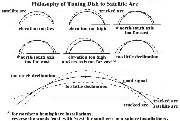

And not just for fast channel changes. Today I spent a couple hours of quality time up on the roof with my TV, receiver and a couple of wrenches attempting some minor tweaks. What I found was that I could get a good Azimuth adjustment across the arc but I never was able to nail the Elevation for some reason. My true south satellite 107.3W Anik F1R doesn't give me a good baseline. By that I mean when adjusting the angle of the dish bracket either the signal stays about the same and is there or not in about a 5 degree range of motion up and down. When I go to my favorite sats 87W AMC 3 and 123W Galaxy 10R I can tweak one end or the other but not both for full quality on the meter. Basically in the end I wound up "splitting the difference." The pole is plumb so I'm starting to think that the angle of the motor might be off a little bit. The picture is very watchable but being a perfectionist I'm not satisfied yet. Any ideas?
My Latitude is 35.1 (Abq. NM) and I set my motor angle to that. And my system consists of a Viewsat VS PRO, SG2100 from DMS international and a 90 cm Azure Shine (3ABN special).
Take a look at this image from Geo-Orbit
With a correctly aligned dish you should be able to get the best possible signal on the whole arc.

Usually when the ends of the arc differ much from the middle, you have declination off somewhat. You may be able to get it closer, but for me, I find I 'split the difference' sometimes too.
