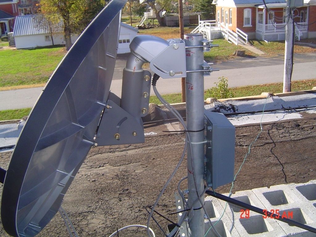

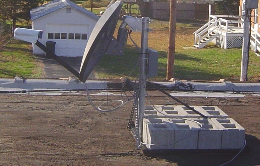

The pics that follow show what I have for my motorized Primestar 84e. I took the standard NPRM and modified it with the 2-3/8" schedule 40 pipe you see. I wouldn't use anything less for a motorized dish.
For a pitched roof, you could get two of these and have the pole in the center with the two NPRM mounted off each side.
Here are the pics:
Yep, Linuxman, that looks familiar :) I've got similar NPRMs for both my motorized and the fixed Channel Master on G-18, and they are rock solid.
Comptech, as far as hurricanes go, just remove the dish reflectors and you'll be fine in anything. That's what I did with both the Channel Master and my motorized setup when Katrina hit, and the mounts stayed put (and precisely aligned!) throughout the whole 140 mph. sustained/180 mph. gusts ordeal. I ended up with a much better LOS (nearly every tree in the neighborhood was leveled). If only my house hadn't flooded...
