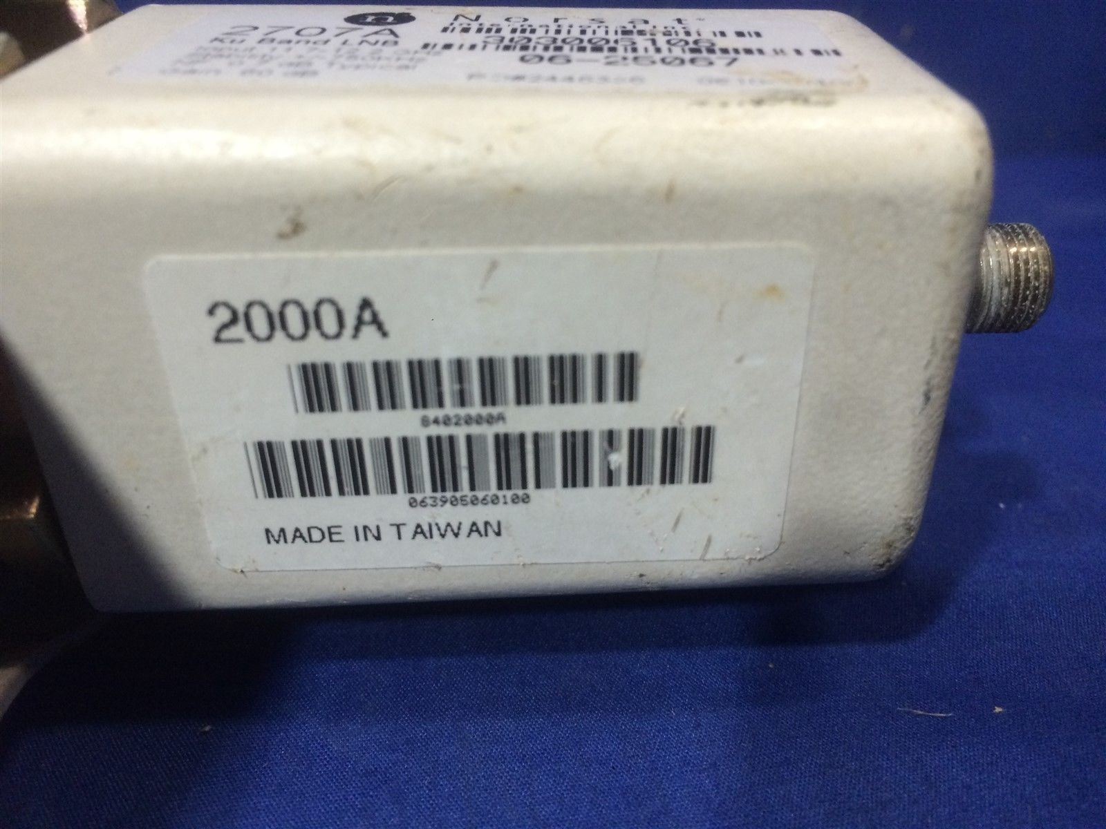

I'll try it with a PLL LNB on there. I have a spare, more modern DTN "oval" dish I could sub-in there, too. Would gain maybe be better on their "pro" LNBs (it's a single polarity)...and, since my memory's bad, how do I know which polarity the LNB is set-for by visual? I may have experimented on this dish, and I know I didn't write down what I was hunting with it last! Thoughts welcomed!
Nope, it's a DTN dish, used for weather and farmers. Has the original single polarity linear, but I don't remember which way it mounted last....so, when you look at it, is it as simple as the element going horizontal IS horizontal and vice versa? This is the "style"
Jim you beat to the explanation of DTN. :)
Yes if you look in the end of it and see the little antenna. If you mount that horizontal it will be horizontal polarized.
So, do you think the elliptical, newer DTN has a better chance at the "retro" (formerly off-skew) signal than the older .75m round?
For a fixed dish and with the DTN feedhorn, yes.
