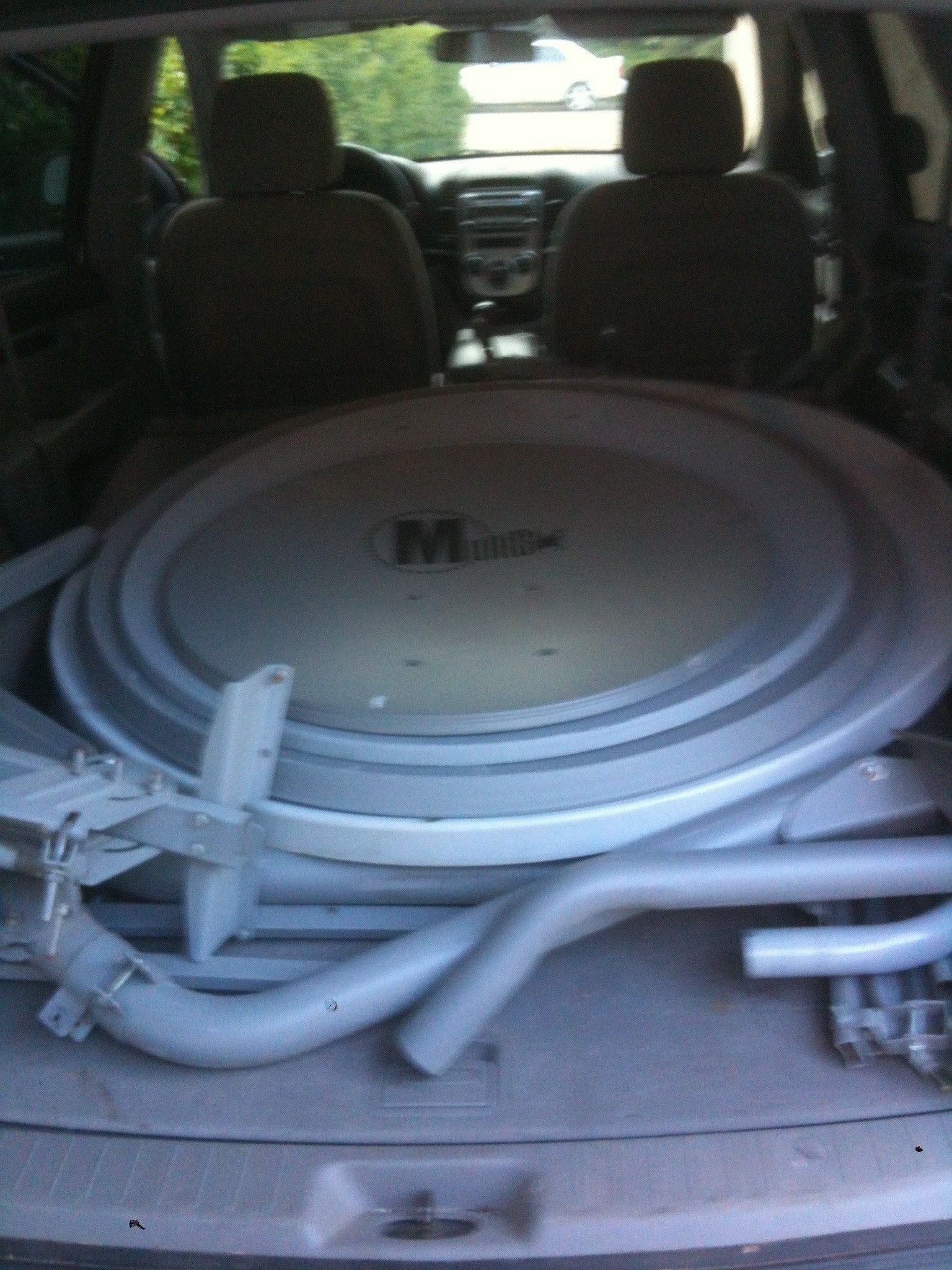

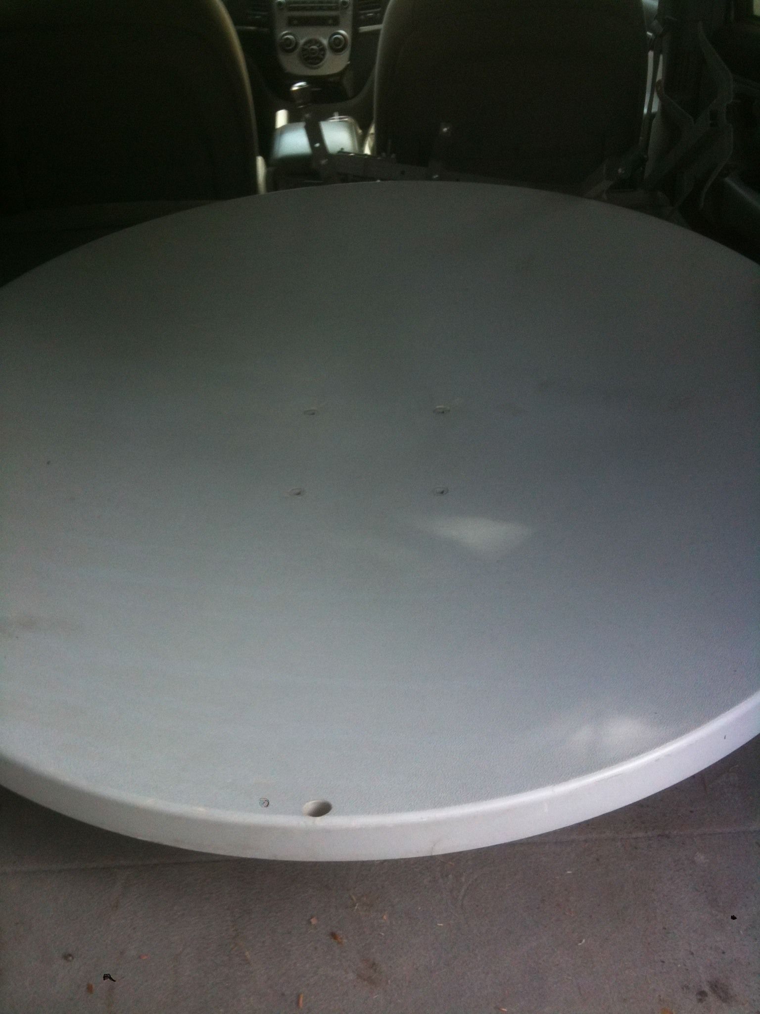

I went on a short journey across the city tonight to see if a guy was really advertising a ChannelMaster 1.2 metre fibreglass dish for 10 Canadian plastic dollars, and came away with 5 dishes for 50.
Now, they aren't all 1.2 metre fibreglass - after all, I am still hoping to win a real lottery some day, but this comes pretty close. The CM is on the bottom of the pile, then I have 4 other metal dishes with their mounts in decreasing size from ~ 42, 39, 30 and 24 inches.
So, what's the collective wisdom say for the best use when installing a CM 1.2 at a northern latitude?
1) dedicate it for a fixed mount on 125W? Previous discussions have suggested I will need a 4 footer to get PBS on Ku in HD at my latitude. I thought I would try a 39, then a 42, then finally the 4 footer in order until I get a good enough signal.
2) jury rig a small dish motor then see how long it lasts? I have a SG2100 I am willing to sacrifice to the experiment.
3) order a Primesat mount/actuator from Europe? Any feedback on these? Brian from SatAV had posted about them around Christmas.
I still have a BUD to put up- which means buying a single output LNBF, tracking down a reliable V-box/G-box and I need to see if either of the two actuators I have acquired work.
I have to plant a couple of poles out in the yard for the motorized dishes.
For the overall plan I am thinking I can locate the C-band dish covering from ~72W to 111W, with the Ku from ~79W to 125W .
If I also have a fixed dish for 125W, and I am not expecting to view on more than 2 receivers, I think with proper wiring and switch planning this would work for my needs.
Thanks in advance, all feedback appreciated.

Let's see proper pictures of the 42 & 39.
Include their mounts, and Feedhorns.
Those and your 48" dish were well worth the $50.
People do wonders with 30" dishes, so you might get some value from it.
If the 1mtr (39") isn't too heavy, it might make a good candidate as a motorized dish.
Id think about using the others fixed...maybe even with more than one LNBF on it.
You could grow quite a dish farm, there. :up
Also, the dishes should be taller than they are wide.
Those are "Round" dishes. Tell us their width.
You can use any common round LNBF on them.
If you have any which are wider than tall, those are "elliptical", and are best with the original matching feedhorn.
(but will still work on round feeds, if you want to experiment)

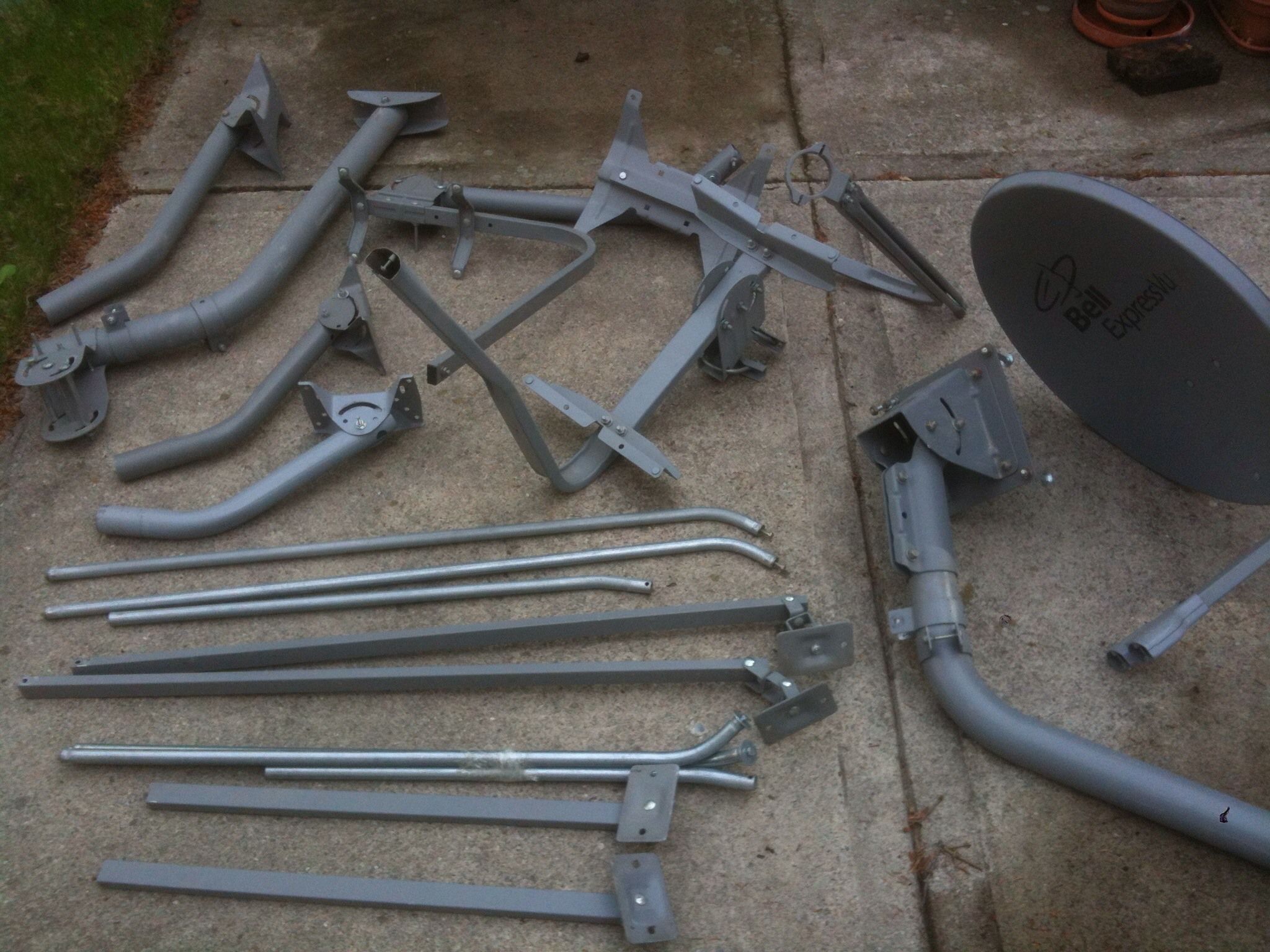

First, pile o mounts. I appear to have all the mounts and arms for the ChannelMasters. The LNB support arms for the generic dishes have standard 30mm ends, while the two Bell dishes have DMount style arms.

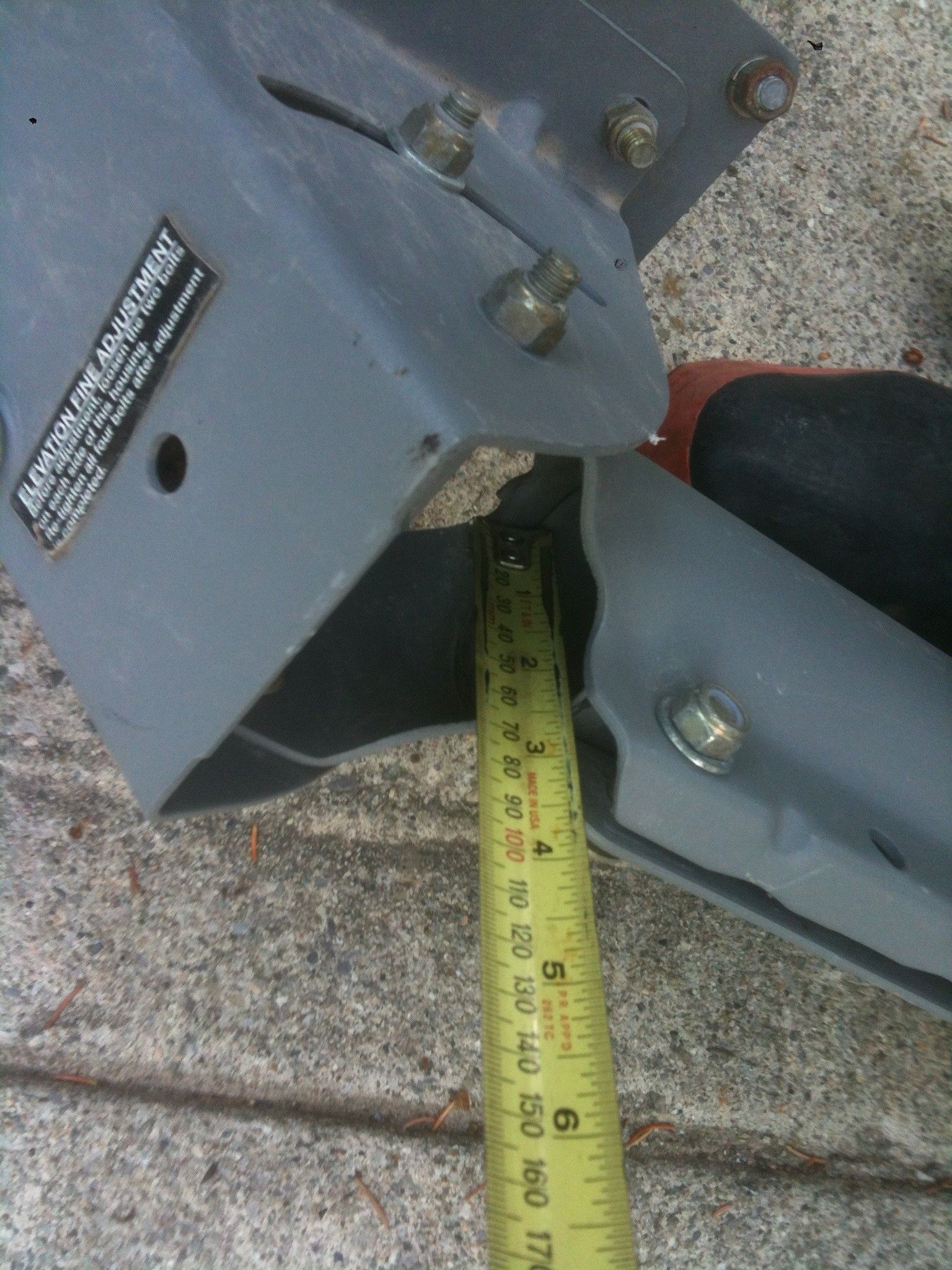

Next, ChannelMaster 1 metre dish and mount

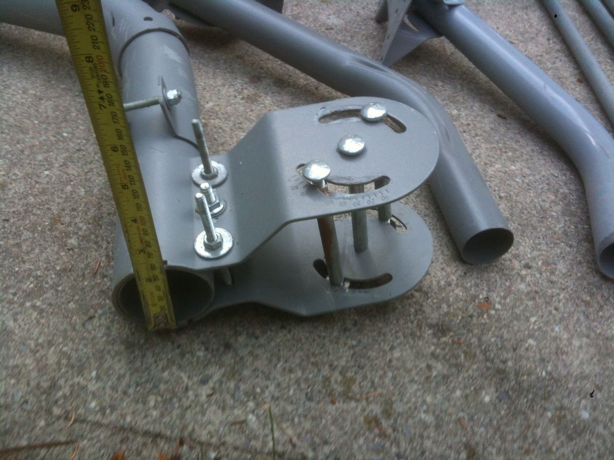

Finally, ChannelMaster 1.2 metre dish and mount

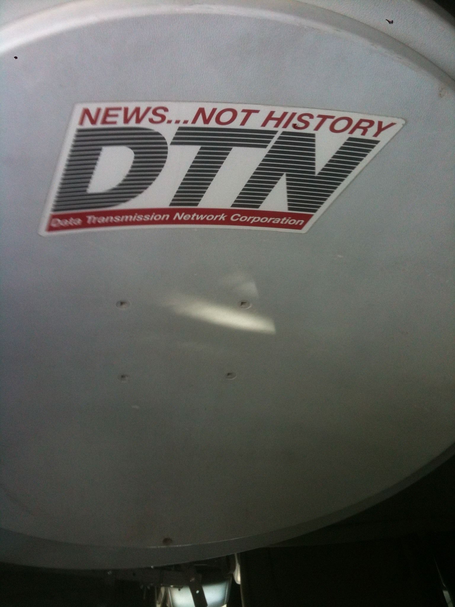

My 1.2's have their original black composite LNB mounts. I'd say they were from the early to mid 90's (Ex Primestar) Same vintage for the (2)30 inch. (Ex DTN) Just use some anti seize lube on the bolts. (they tend to rust quickly)

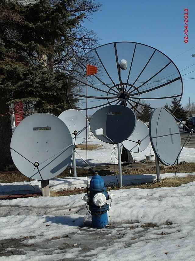

"Bell dishes" attach a conduit hanger with a long bolt to hold a 'proper' LNBF at the focal point. (if contemplating using them)
I think I've got enough dishes. I'll show the CEO and head gardener that picture from your post FaT Air and see what she says.
