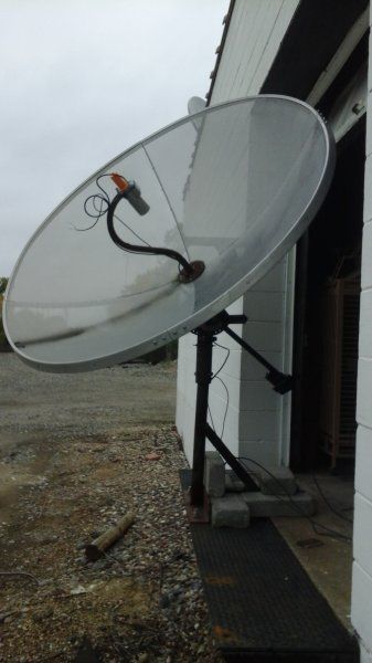

20161015_143532.jpg Thanks Mr. Titanium. Here is a picture of the dish.

Titanium's advice is spot on, pick one band or the other. I would not try to use a C/Ku with that dish size.
The 10' Winegard Pinnacle has a FD of .278 They are perforated not mesh. I suspect the 6 footer may be perforated as well. The Pinnacle is a very stout dish :)
