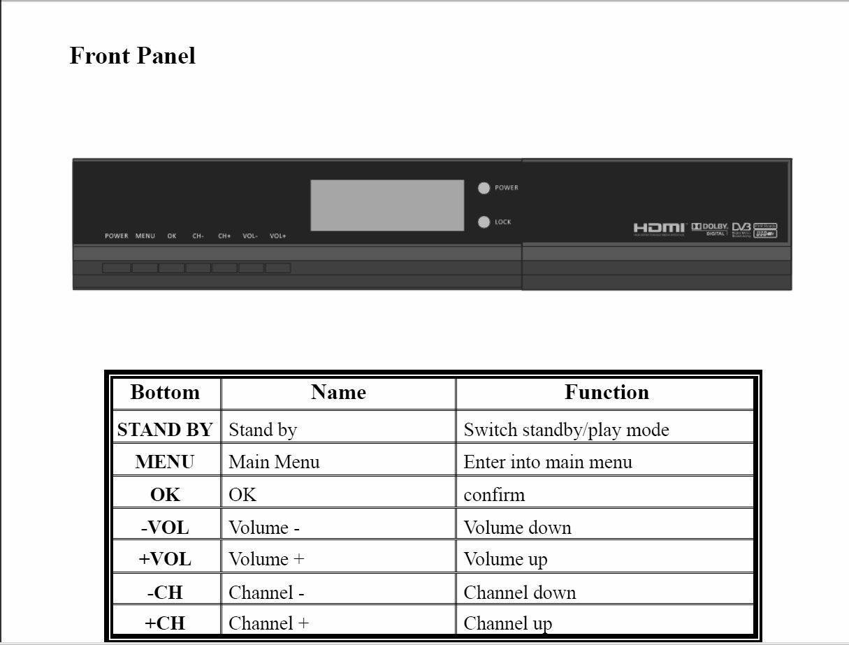

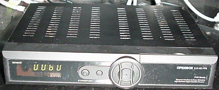

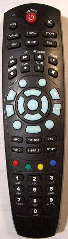

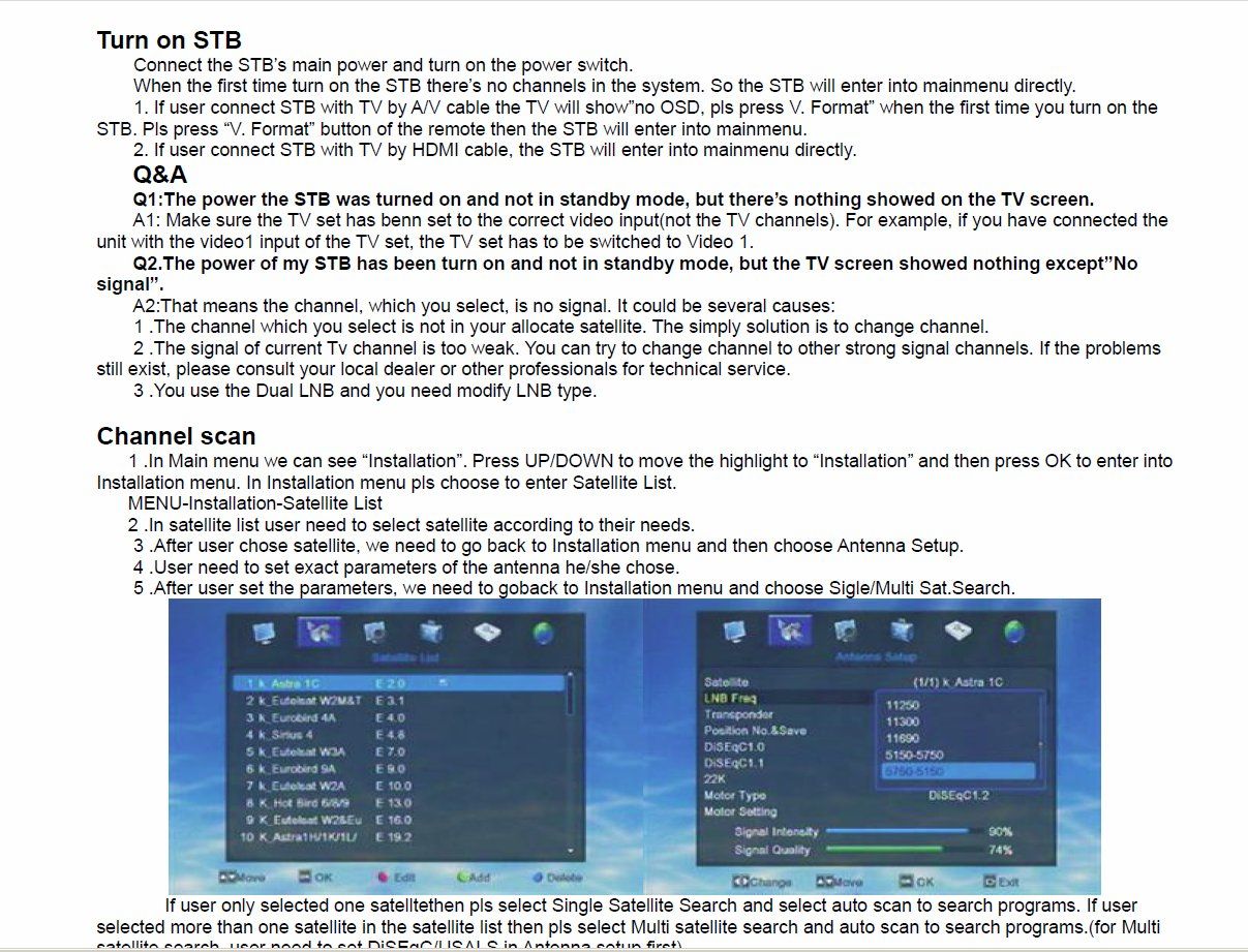

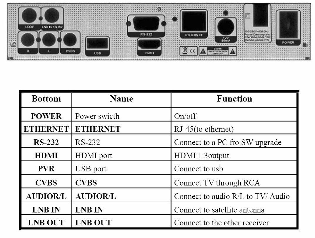

View attachment 71214View attachment 71215View attachment 71216View attachment 71217View attachment 71220

That pic you posted shows a mute button, does it just not function?
I also see in the pic you posted the Speaker with a X in the upper right corner of the remote. That's the Mute button

One of the most important point that should be mentioned is that the S10 doesn't have Component Video output as an alternate for HDMI HD video. On the other side we should mention that the new firmware version allows the S10 to fix the clock problem something that the S9 still missing.
