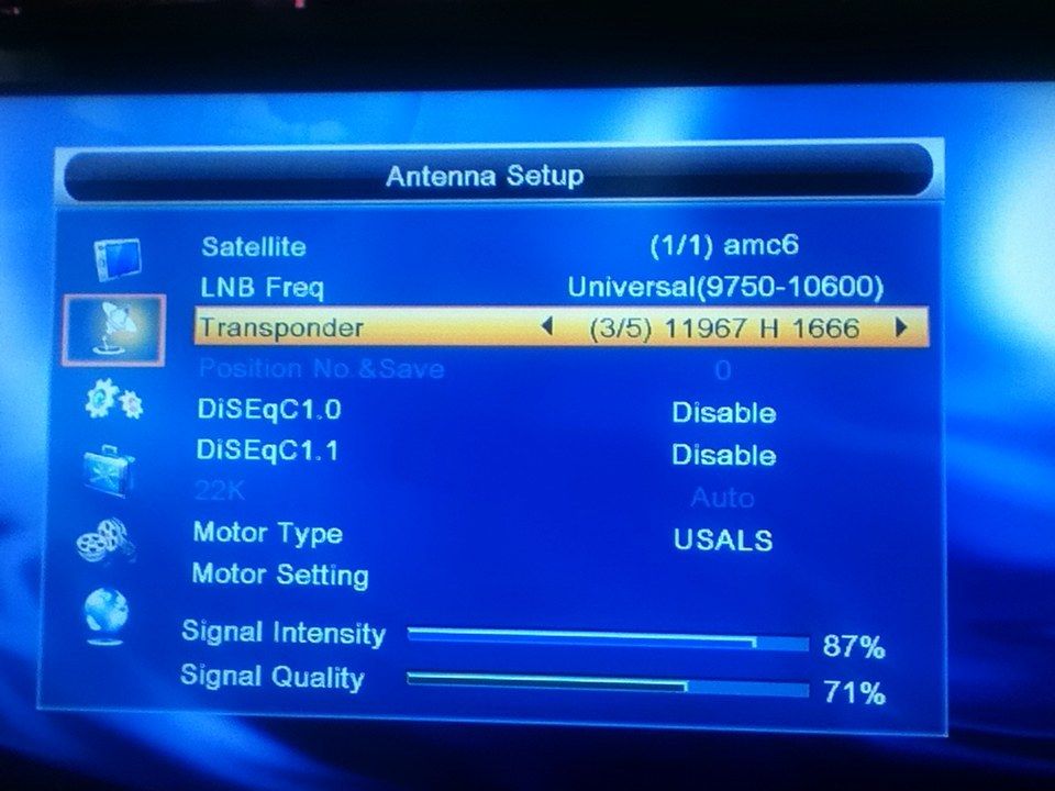

couple of screenshots:
Screenshot of signal screen KFTL transponder
