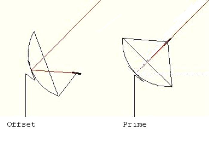

Prime focus isn't related to what the reflector is made of.
