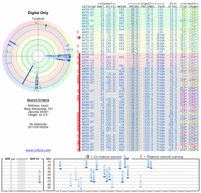

I am trying to get the Columbus, Ohio stations in all of the time if possible. I get them usually pretty well in the late evening and into the early morning hours and sometimes randomly through-out the day, (esp. WBNS channel 10). These stations are close to 80 miles away with WWHO being 73 miles away according to tvfool. I can manually tune to the transmitter number and see a little signal there, but not enough to capture it.

Go to tvfool and click on the other option "Start Maps" and enter your exact address. You should get a list of stations in order of strength. Find a Columbus station and click the button in front of it to get a map of the signal from the transmitter. In your zip code there are blank areas and light pink where the land is slightly higher. If you are in a pink area I think you have a chance at getting these stations.
