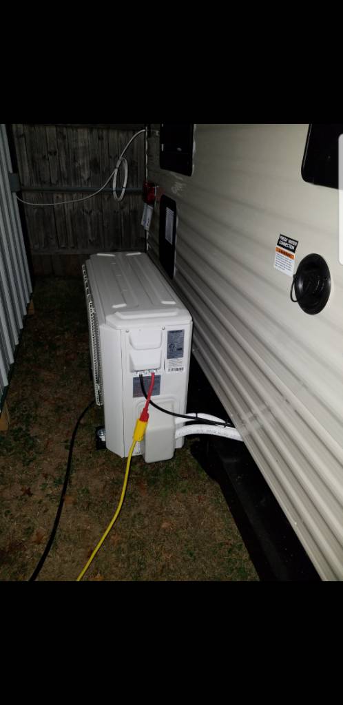

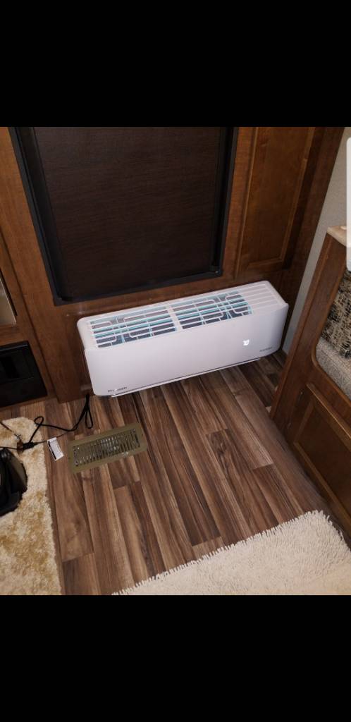

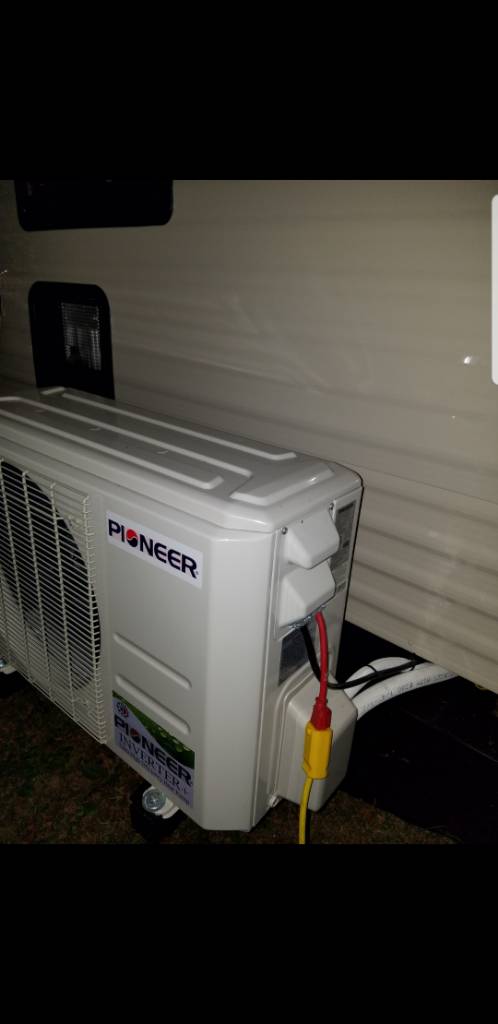

Truckracer, Where did you install the outside unit? I could see that the inside unit shouldn,t be too much of a problem to install. Did you put the outside unit 0n the back or maybe the toung or maybe on the roof?
Put it on the rear bumper with two bolt on trailer hitch receivers and 2"x2" aluminum square tubes

Pics here

I like your air conditioner system. I assume it is an inverter model. I had to get a new window unit and got a 14,000 btu LG inverter unit. The one that wore out was a 10,200 btu and flickered the lights when it come on. This new inverter model slowly ramps up and don,t need a surge to start it, Used less power and cooled my house.

I am a Licensed HVAC tech so I have the micron gauge, Testo superheat / subcool instruments, refrigerant scales etc. Makes the install go quick. This unit is very easy on power. It heats great too. Saves a lot of propane. I have a second home that has 5 of these units. No ductwork. Works well.

I have seen the inverter window units...that's a big improvement.
