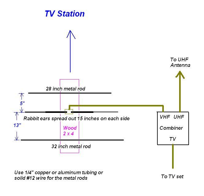

Use the rabbit ears for VHF and the Terk for UHF. You will need a combiner that has 2 outputs one marked VHF, the other marked UHF. Looks like channel 8 is north of you so have the rabbit ears spread out horizontal, one pointing east and the other pointing west. If this still does not bring channel 8 in, you could try a do-it-yourself yagi. Picture attached shows how to make a quick and cheap 3 element yagi using rabbit ears for the center element. A yagi will work OK indoors. I made my own 10 element yagi on a wood boom for my attic and I get a good signal from Channel 7 in Wausau, 73 miles from my house.
