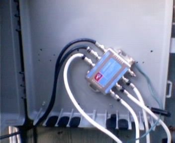

Tech nut tell me what the diffrece between a Diplexor and a multi switch? I look at your site and what yo are calling a multi switch I thought was a diplexor..
I know that Winegard antenna wont work unless it is run thru that multiswitch..
If I decide to get ride of the multi switch which two hook ups in the back of the Voom box gets the dish feed and which gets the OTA antenna feed..Thanks for your helpI could not get any one to answer this question.. Cya Slick

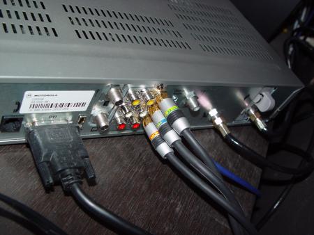

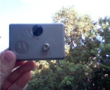

ill add some arrows and post some more pics.
here some, first pic multiswitch, 2nd pic diplex thats attached to back of stb that i removed two reveal 2 seperate plugs , ill try to find a pic to add

Hey Technut now things are starting to come togeather, I never thought that diplexor was connected to the back of the Voom box.. I remember when the Voom guy put those on, now the question is when you removed it, there were two imputs and which one took the dish feed and which took the OTA antenna feed..
I am looking forward to your nrxt picture, unless you just wanna tell me which one takes which.. I love it when the puzzel strts coming togeather.. Thanks for your help I am looking forward to your next post.. Cya Slick

i found a pic of the back of the stb, one of sean's old posts, the two seperately run OTA and sat feeds can be seen at the far end.
I hope i helped.
