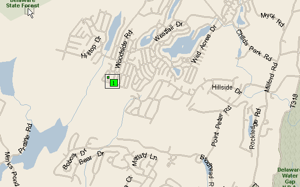

I've triangulated your approximate location from your TVFool report and fortunately you appear to be on top of a ridge, but NYC stations are still 2 edge from your location.

I must be looking at a different TV Fool because the one the OP posted shows a location near Dingmans Ferry PA with most of the NYC stations between 0 and 10 dB. If you pull up that location on a topographical map it is very favorable for long distance viewing(if you are on the high spots of the ridge above the Delaware river). That said you still need a quality antenna to keep a consistent signal on these stations. The first question I would ask is how important is WKOB channel 2 out of New York to you. If really want a shot at that you are going to need a 15 foot monster like the one you were originally looking at. Take channel 2 out of the picture and there are plenty of VHF-HI/UHF combo antennas that may work well for you. If it was me I would first buy a 91XG and do a simple installation on a ten foot pole above the roof and see what you can get. Forget about a tower until you know what you are dealing with. If you are happy with the 91XG then add something like the Y10-7-13 for VHF-HI to the same pole and run them together down one line with a Pico combiner.
My mappoint program is showing this to be his location if the Latitude and Longitude were correctly given to use..
You are within a half a block from the location I used.
I put it in the mapping facility of TVFool to arrive at my approximations.
