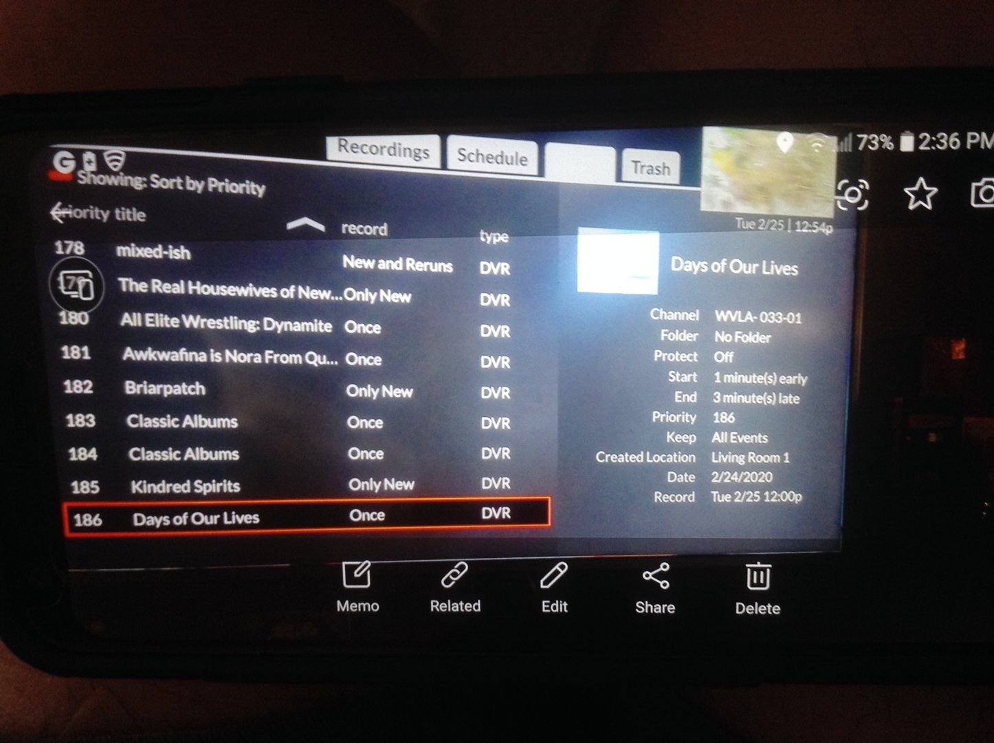

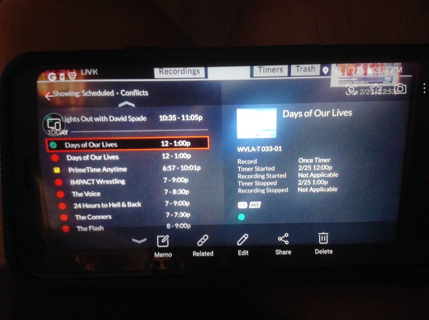

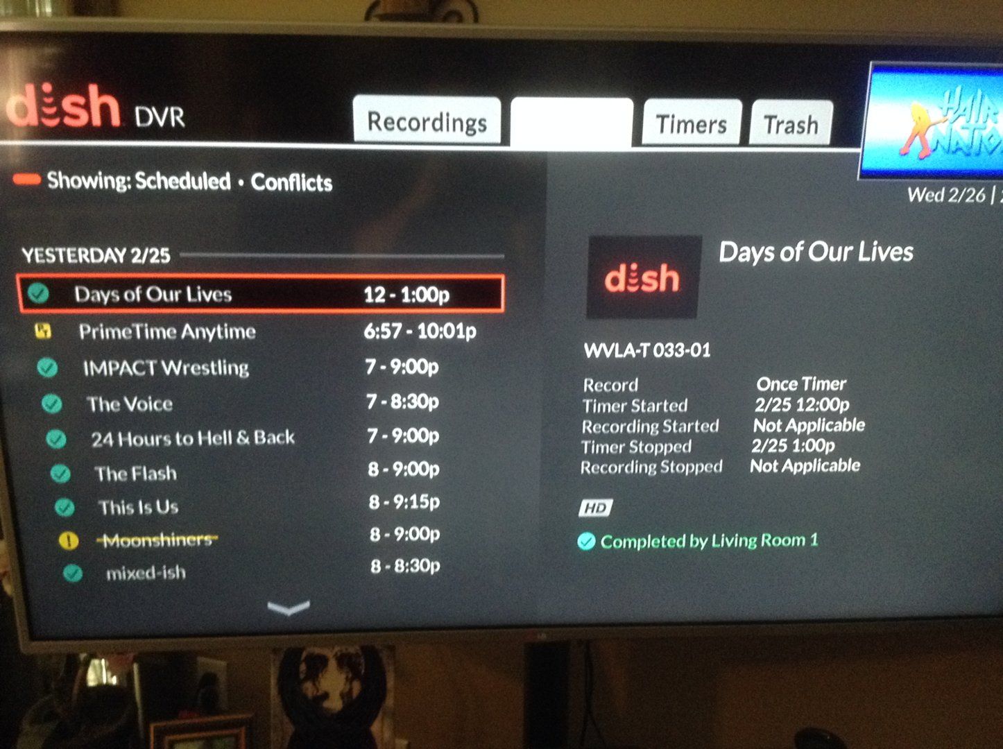

Can anyone actually record ota on the HWS? Every time I set a recording it shows in the scheduled list but never records.

Same here. When I rescan the ota the info is always screwed up until the overnight update.
