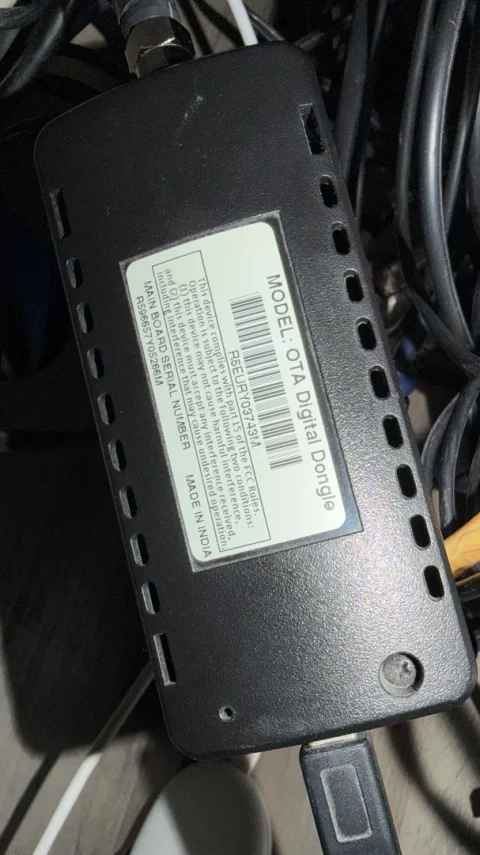

Yes, that is the single tuner OTA adapter. The dual tuner adapter has the usb cable built in.Can you tell me if this is the single tuner OTA adapter? It has a usb cable that can be removed.
That would be extremely helpful. Please keep us updated.Yes, that is the single tuner OTA adapter.

I'll connect one of my single tuner OTA adapters to my Hopper 3 today and see if my OTA signals go away.
With one of my single tuner OTA adapters attached and without re-scanning, the channels are still in my guide but when I try yo tune one it says "the OTA signal has been lost for channel 013-01 KLBK-."That would be extremely helpful. Please keep us updated.
