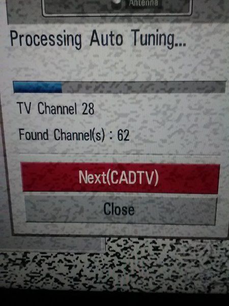

I think I got you topped I normally get about 16 channels In my area I got 60 now. It's not snowing just clear and cold. 25 degrees outside weird.

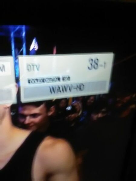

Does anyone know what's going on? No solar events happening far as I know of. I have pickup wave tv from Louisville Kentucky. I live north of fort Wayne Indiana. Indy stations are coming in booming. Kzoo Michigan wwmt is coming in.

It's just a weather event, not solar sun spots. That's causing the Tropos ducting to go crazy.:)
