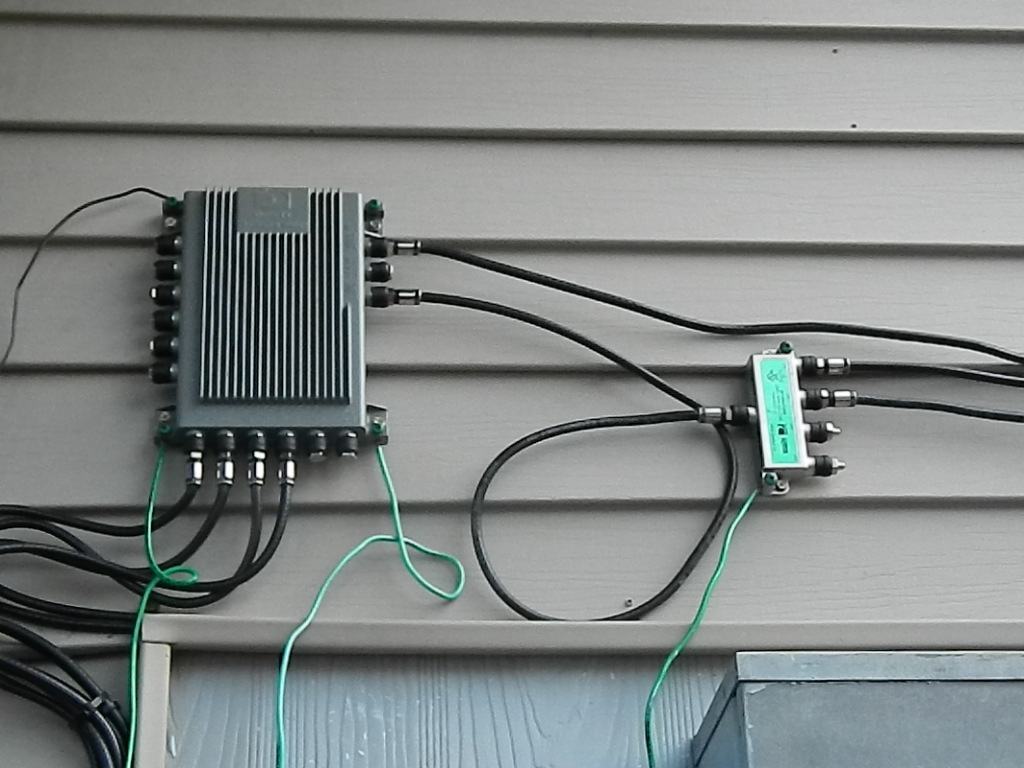

Re Read It makes total sence. My Swim 16 is outside, ofcourse its going to have 4 lines from the dish to the swim, But thats not Inside, and it doesn't have to be.

From the swim outside, I have 2 wires coming into the house, and one of these is connected to the end of each.

Update sorry, They left the downstairs splitter outside next to the swim 16. So I only Have 1 splitter inside .
Then I have 1 wire coming from in the house from this...http://www.solidsignal.com/pview.as...rter-for-SWM8-and-SWM16-(PI29Z)&c=Multiswitch Power Supplies&sku=
To back outside powering the swim 16

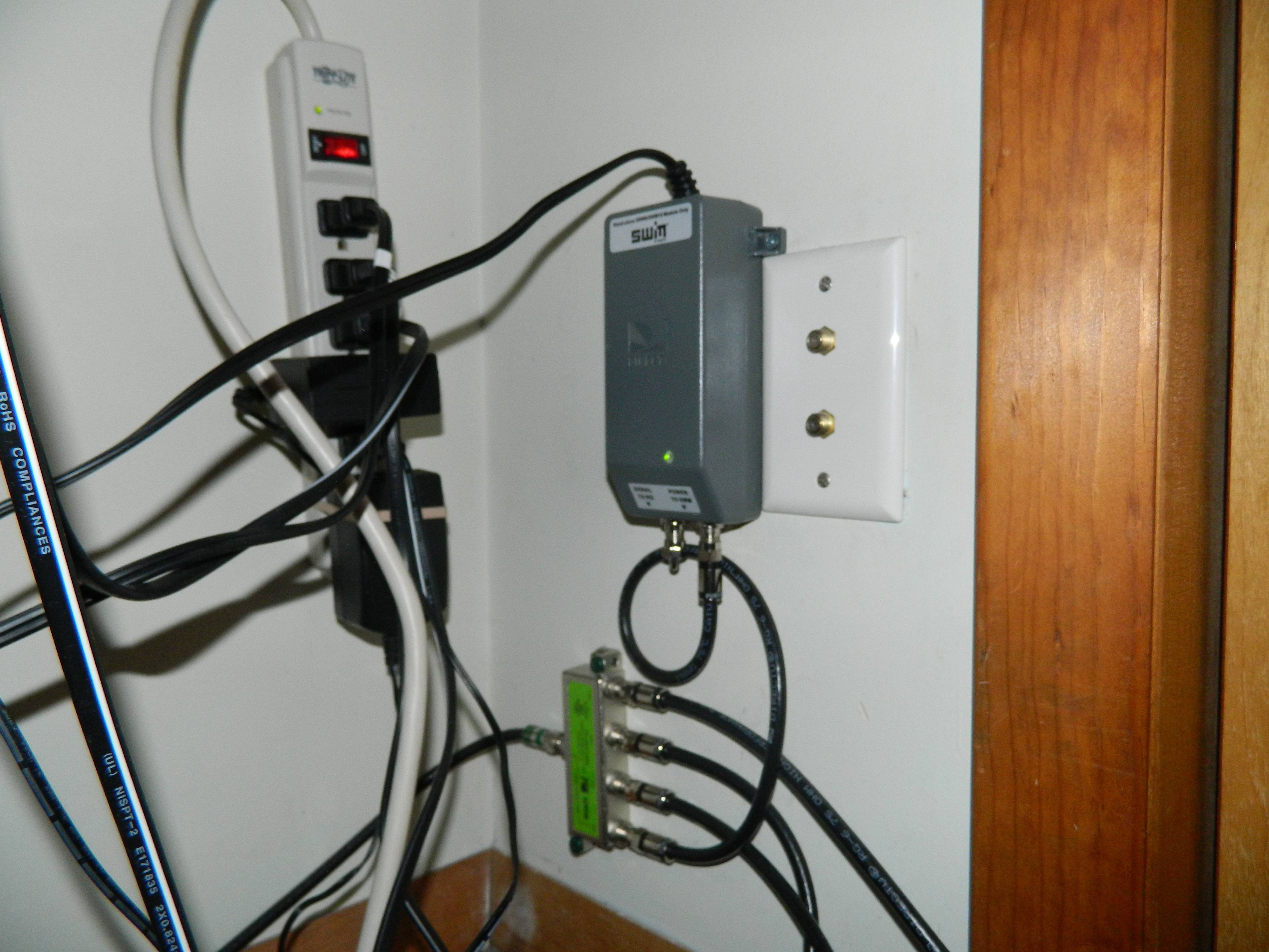

Picture 1 Clearly shows 2 wires leaving the Splitter,(One Goes to HR34 and other one HR23 in Bedroom 2) and one Leaving the Swim Right side to upstairs 3rd floor.

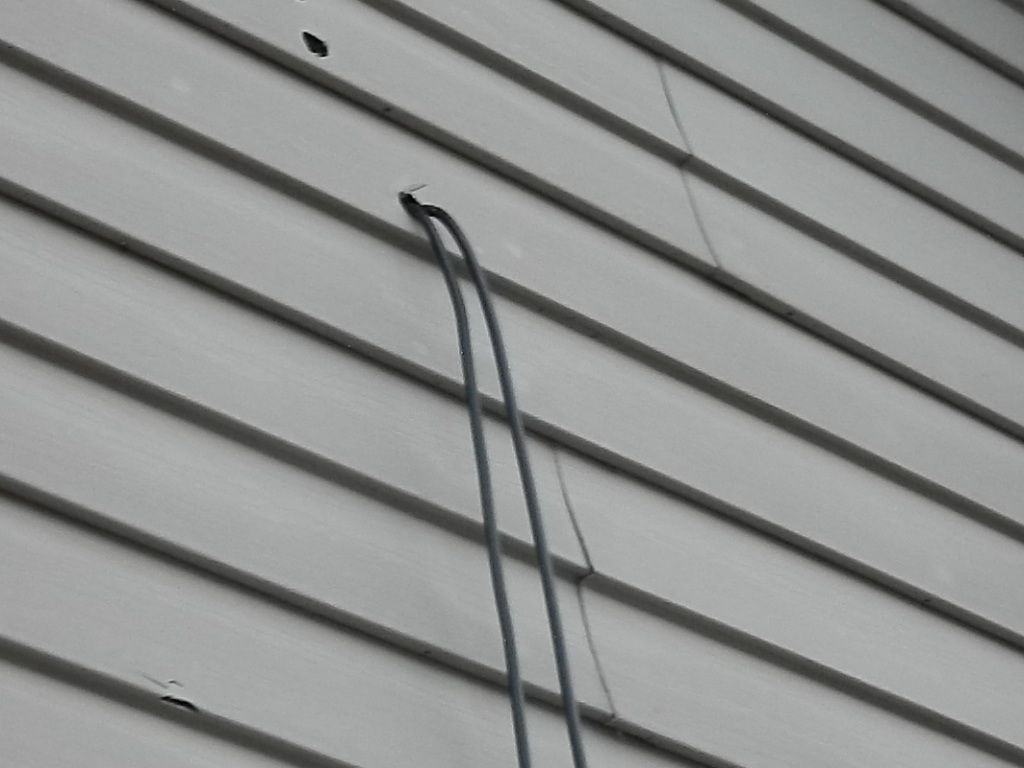

Picture 2 Shows the 2 wires going to 3 rd Floor from Splitter and Swim from outside. One from Swim goes to another splitter in Attic, and One from outside splitter goes Directly to the 2nd Bedroom TV
Picture 3 Shows Single wire in my attic going to another spliltter where it feeds Master Bedroom TV, and Bedroom Number 3. Also Power inserter is fed into splitter as well as the DECA system.
And Yes they grounded the crap out of it, But my house is 40 feet high, so I think he was worried about lightning.
Now they could have done this with only 2 wires, If everything I wanted was on a Single floor.

Are the holes in picture #2 sealed? They should be.
They are now. They weren't when the picture was taken, cause the installer had to do it from the insde out, He didn't have a 40 foot ladder with him..
I do, so I changed the siding there since and filled it.
As you can see above there was another hole that the dumb A$$ cable guy drilled in the wrong spot when doing my Internet.
Both have been fixed since.:)
