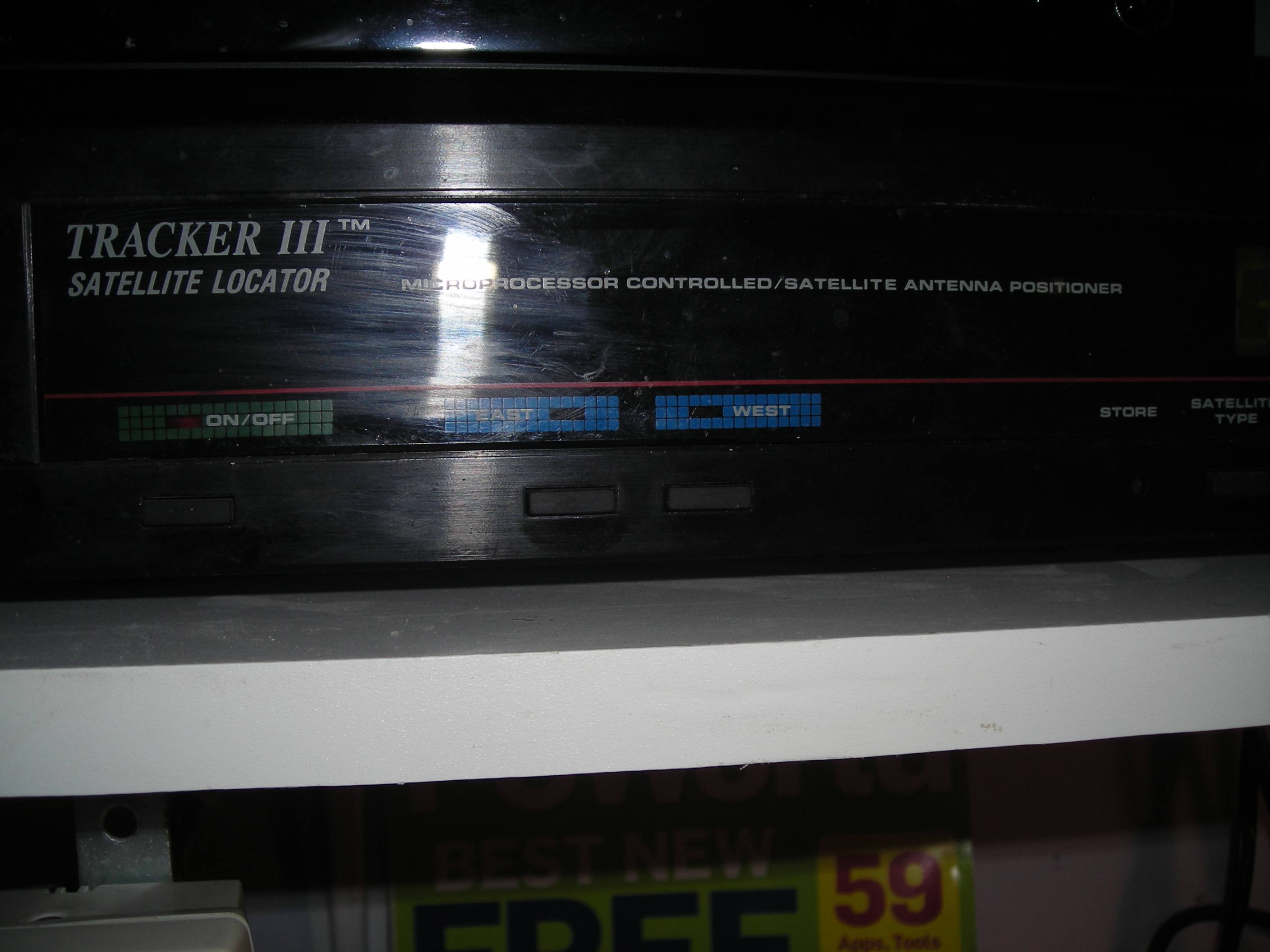

Gee....thanks for the quick response guys! There is no hole in the back of the box for reset, however there is a red reset button on the back but it is only if the unit kicks out from overload (thermal protection).There is a hole for "store" on the front. I once reset this unit a long time ago but forgotten how. It has something to do with the store button. I've tried countless combinations of button holds while hitting the store button in the hole but to no avail. See picture. Anyway, thanks again for the quick response and as always, any help would be appreciated! Mike

I just read your post from several months ago. I have several Tracker III boxes. The way to restore the box is to simultaneously hold the Satellite "LETTER" and "NUMBER" buttons. While holding the buttons insert a small wire or toothpick into the "STORE" hole in the front of the box. The display will begin counting down 10,9,8 etc. to 0 and will then prompt you to set the East and West limits.
