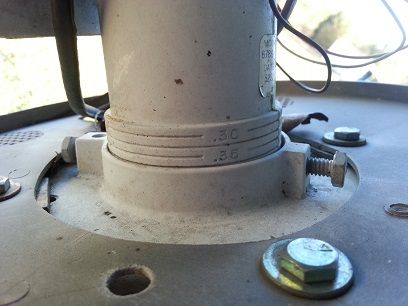

Ok guys i am gonna install the dish on my pole today. I am going to have some question in the process. i will keep all my questions and progress in this one thread. Thanks in advanced to anyone who helps.
My first couple of question are . Can i use the same scalar ring that came with the dish with the new C1W-PLL lite lnb?
Next question is can i use the same focal depth as the old one used? if so what would be the focal depth be on this old one? Also what focal depth should i set it at on the new lnb? pic below
Also does the dielectric slab need to be installed? if so how is it installed inside lnb?

I would use the Scalar ring that came with the dish as it is designed for that dish, and is beefier.
If the focal depth has not been touched since the dish last worked, the new one should go about in the same place.
No on the Di-electric slab, that is only used for circular reception. Don't know how far east you can see, but the satellites over NA are all linear and not circular.
Reactions: bpalone and dl76
Thanks Titanium . I found link as soon after i posted. Guess i should had searched first. Also thanks for the fast shipping on lnb. The dish came not even a mile down the road. So hopefully everything was set right. Just got it up on post.
