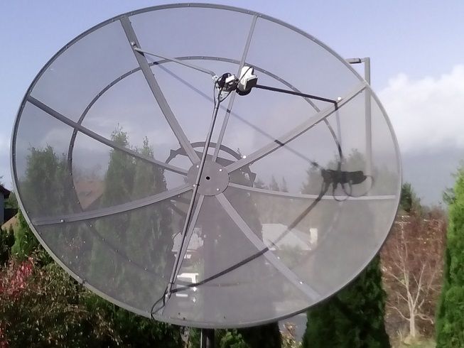

I have the same Unimesh 7.5' dish and am doing well with dual C/Ku setup. I am using a Invacom prime focus Ku in the center and a sidecar Titanium PLL C LNB. I do have a Titanium C/Ku combo making its way in the mail to see how it does.
I am actually pretty impressed with this set up getting pretty much (90%) of everything in Ku and about the same in C. unimesh1.jpg

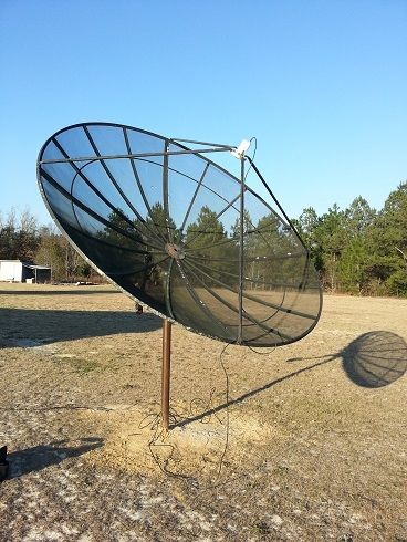

Update . I moved the post. On other side of home. I had some trees. That was blocking satellite 139 west. From behind the 7.5 foot dish it looked like half the dish was hitting the trees and other half was not. Going to start putting 10 foot together in morning. Hopefully the channel master will be up by next saturday. I Will post pics.
