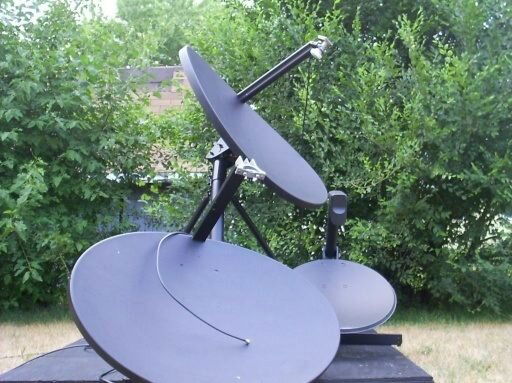

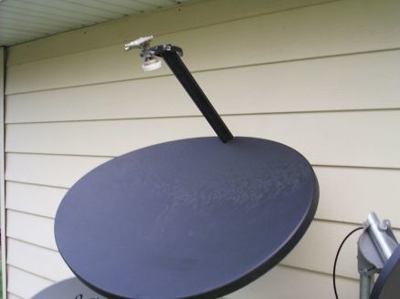

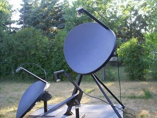

I paint ALL my dish flat matt black there is NO PROBLEM painting a Primestar dish :)
I like black as its the first thing to melt in the snowy weather and it will NEVER reflect any sunlight into the LNBF!
Please post some pictures if you do go ahead and paint the dish!
