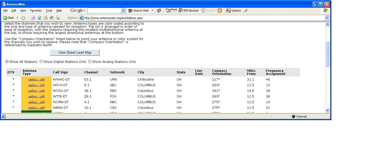

attatched is from antennaweb.org
All stations are digital. I don't know the exact power but I know that cbs is the highest power with nbc a close second, abc and fox are a low power. This info came from my installer though, so take it with a grain of salt.
The reason I didn't mention any of that, was I don't believe the problem to be with the channels themselve, frequencies or uhf/vhf. Direction of ant. You can see from the picture that nbc, cbs, abc and fox are all only a couple of degrees off from each other. A week ago, all 4 stations had a 50-70 signal strength. Now it's only nbc that gives me a problem. The ant has not moved. When i got it right, I marked it to keep track. So a week ago i loose nbc. It's in the guide just a low signal. I take the amp out and boom perfect signal. If it was any of the info that you asked about, wouldn't have been happening all along?

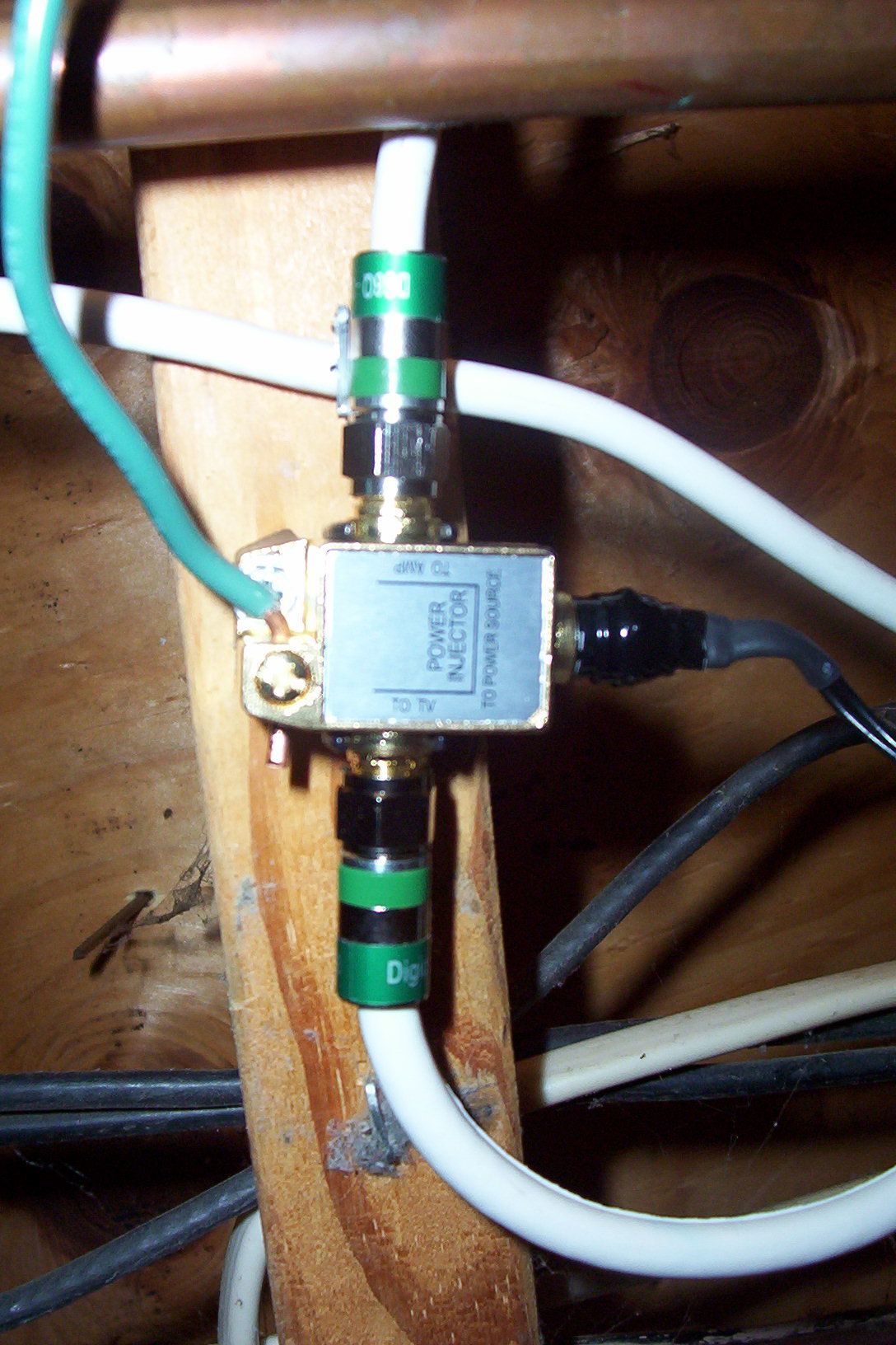

So there is something going on, either with the injector, or the ant amp that the two of them are not playing nice. the injector is a channel master, S037 ant. amplifier. 18v output.
we haven't had any lightening strikes or anything like that. The injector's power supply is not on any type of surge protector, so it's possible that it took some sort of power surge. I am going to bring my multimeter home from work and see what kind of voltage it's putting out.
I took a picture of the amp too. And befre anyone asks, yes it is connected correctly. I have triple, triple checked. :D

Looking at you antennaweb attachment, the NBC is only 14 miles from you and if it is indeed one of the strongest stations, as your installer said, Mike's "overload" theory makes sense. I am not familiar with your OTA amplifier, but I wonder if there is a way to decrease the amplification in it?
If it is an overload problem on NBC, then I would try to use a Radio Shack Attenuator. Attach it inline with your OTA and slowly adjust from Min to MAX attenuation to see if NBC comes in. Hopefully you can find a setting to receive all of your stations.
