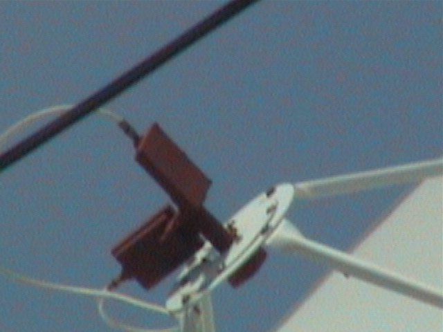

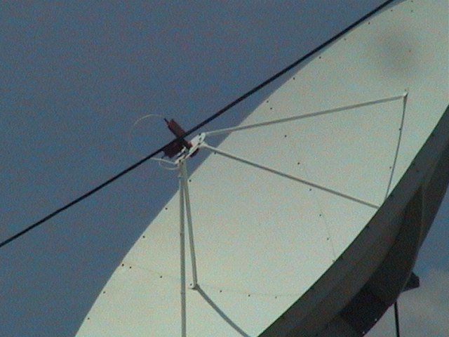

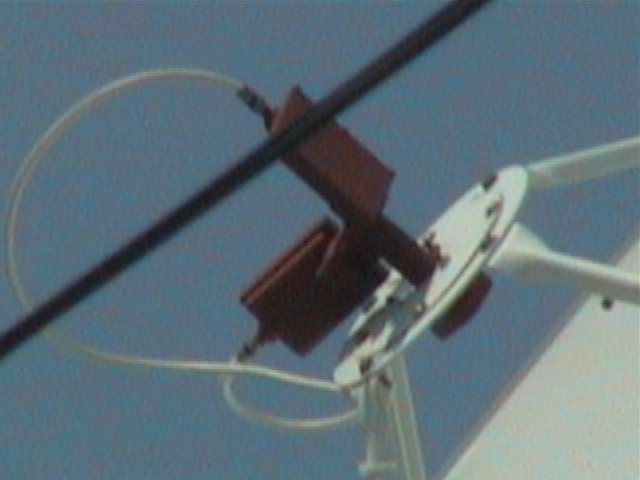

I'm sorry if I bother you, but I was looking around to see the dish installed with that satellite and the LNB is something like two small retangular and thin box puted one horizontal and another faced perpendicular, I couldn't find that model on website, I'd like to have a picture to show you, and maybe you know better, because I don't know what is the degree of that LNB. thanks.
I just take a picture of the LNB (my avatar) that are been used here, have you seen it, if you know where I can find, let me know, please.
I just found some information the Satellite is Panamsat B6 which are transmiting In Ku band, if somebody else knows the LNB like that picture, help me. thanks!

That's a much better picture, but sorry, I don't recognize it. Looks like someone painted it, along with the entire feedhorn assembly? I saved it so I could blow it up, and still can't recognize it. Since you are able to go out and look at it directly, maybe you can tell if it's an ADL-KU-901, as seen in this link:
ADL Ku-Band Prime Focus Fixed Feeds
Al
