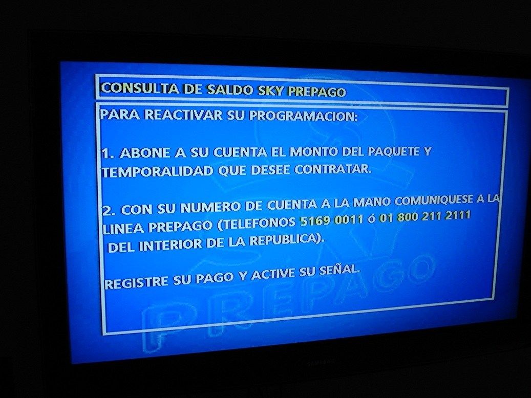

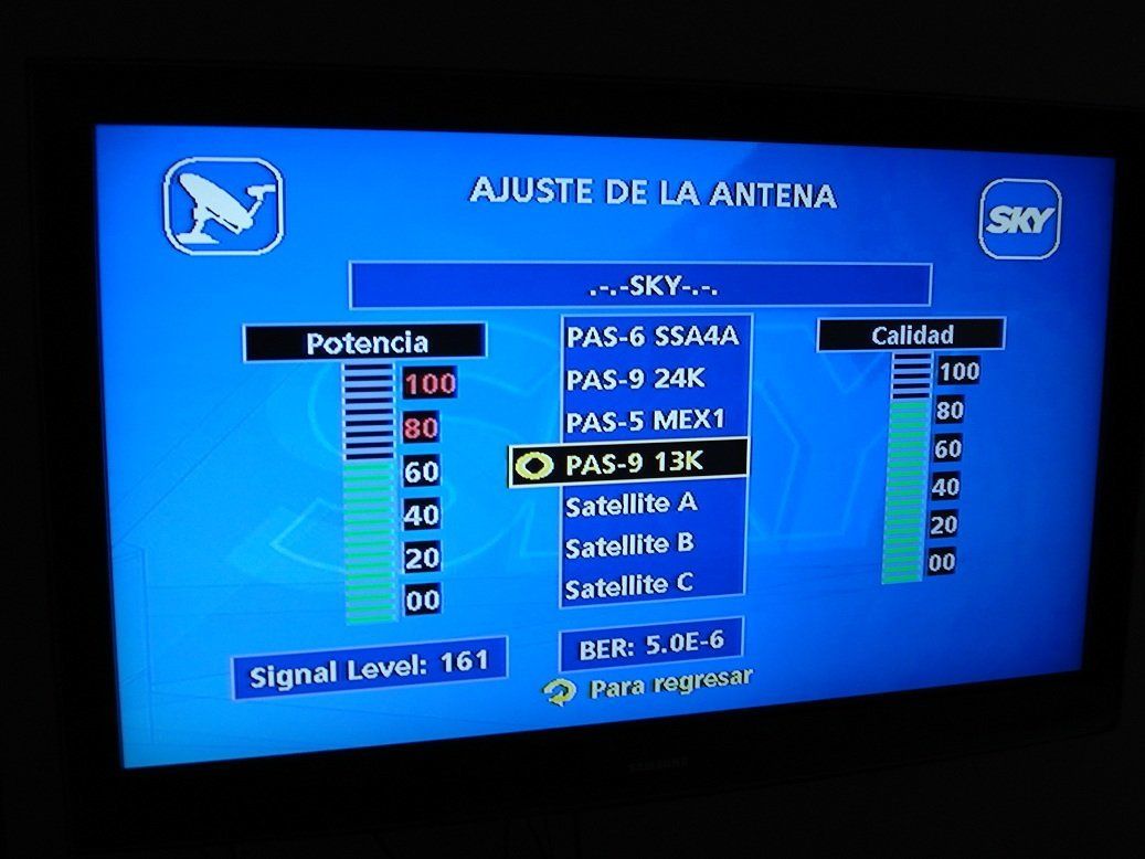

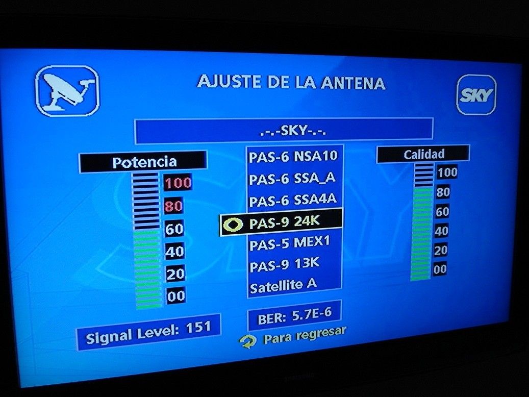

Here is the captures from the Phillips Sky receiver with its signal quality.
Picture one is set as PAS-9 13K
Picture two is set as PAS-9 24K
Picture 3 is the status of SKY PREPAGO
As you can see there is plenty of CALIDAD and looks almost identical with 13k and 24k.
So I do say your receiver is bad only showing 40% max
