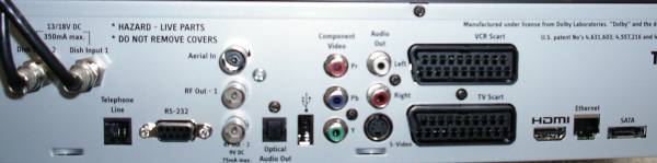

Is your Sky + receiver look like the attachment, if so. you have to run 2
linear feeds to receiver. thats what instructions say.
Back of the receiver doesn't look like the one posted, but that reference to Brian sounds like a jackpot! Thanks. He's north of me, so if he can get Sky, then I should be able to as well.
