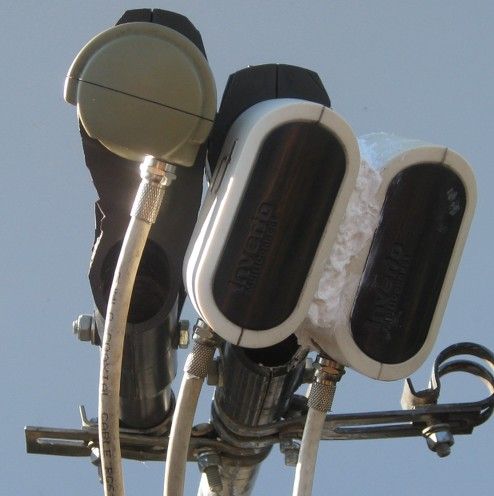

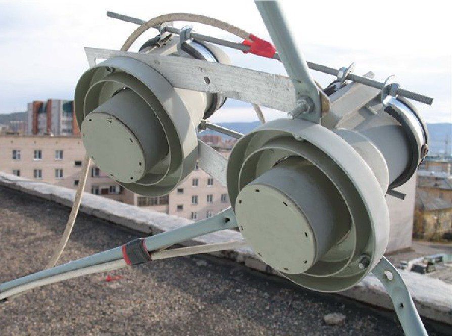

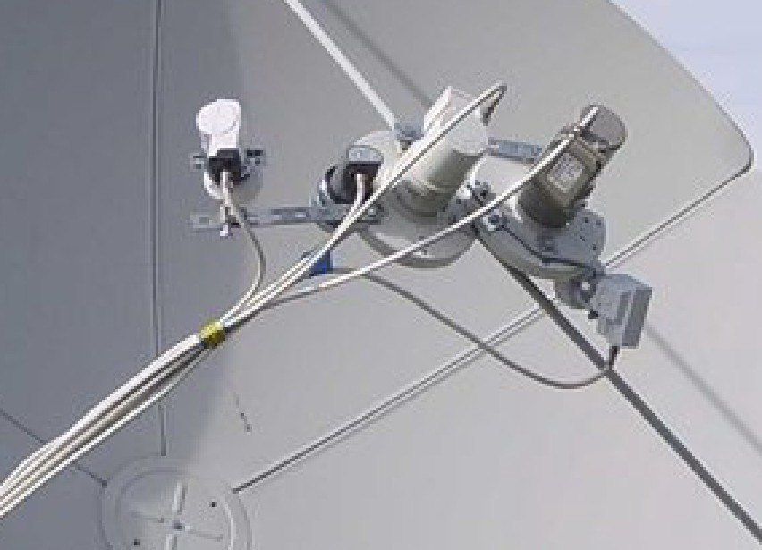

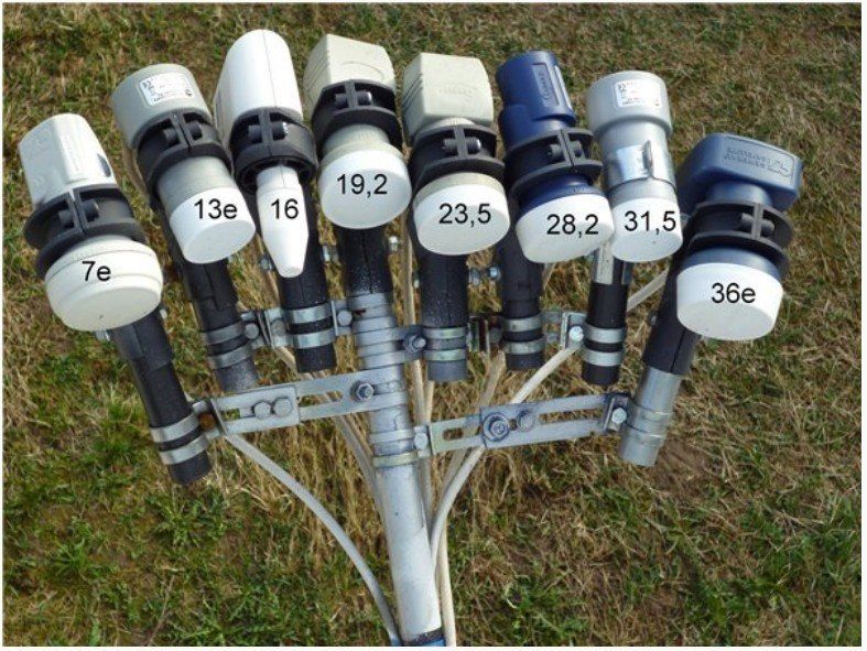

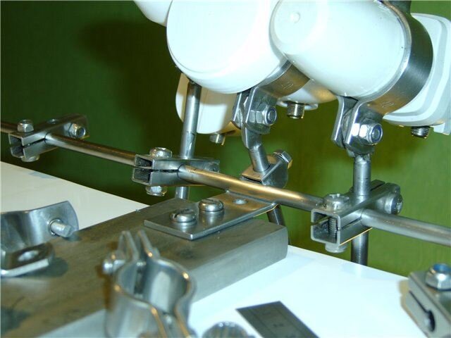

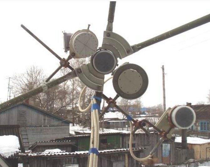

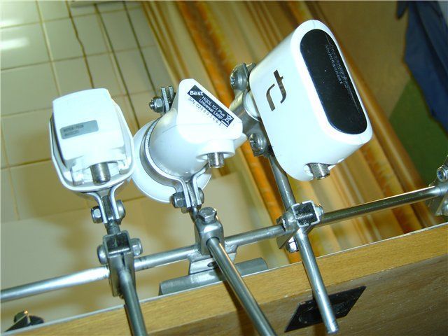

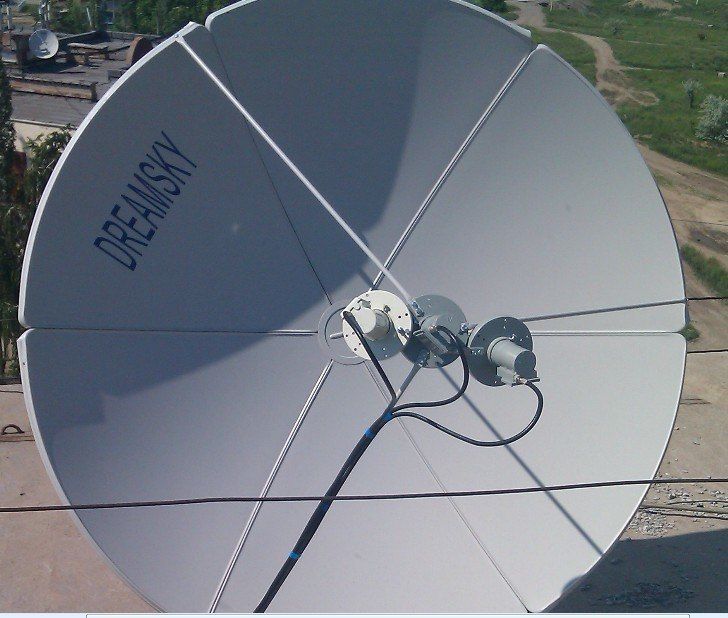

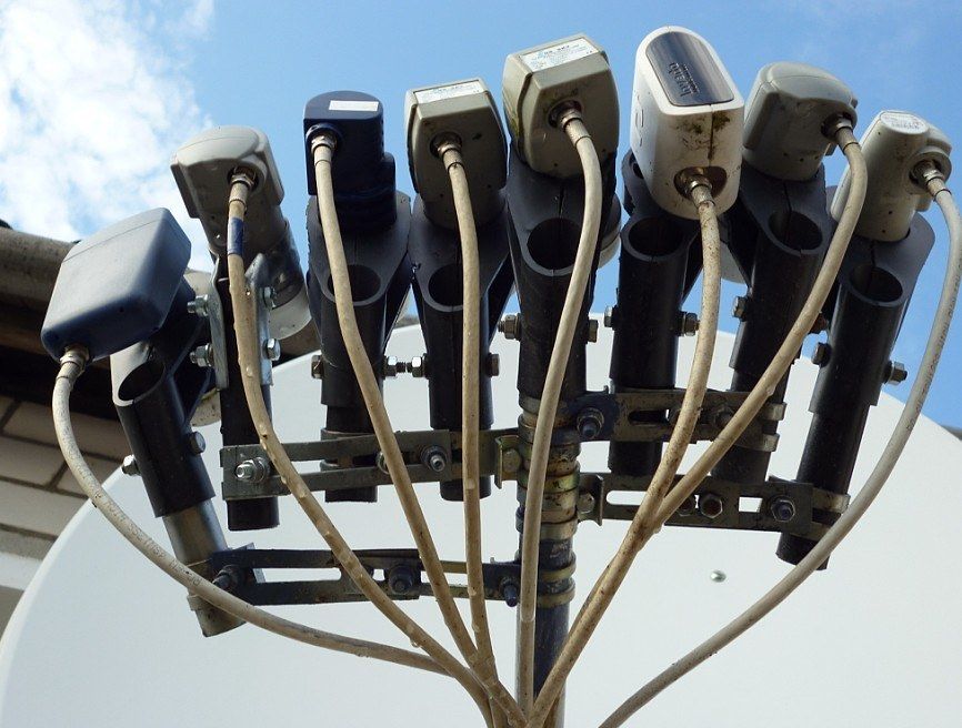

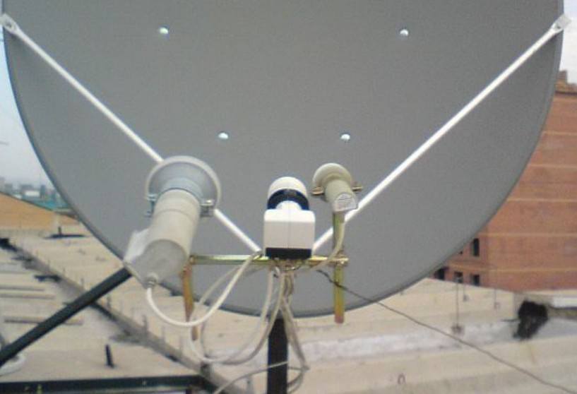

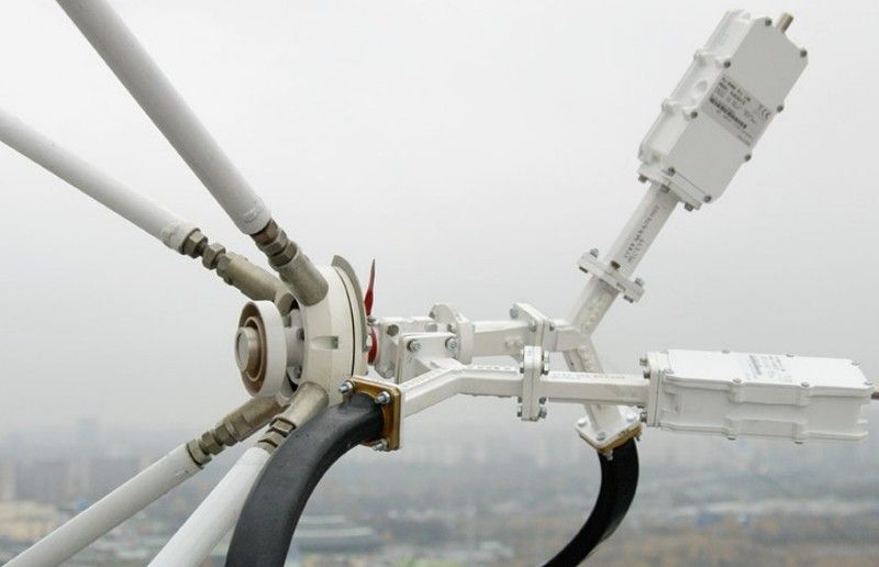

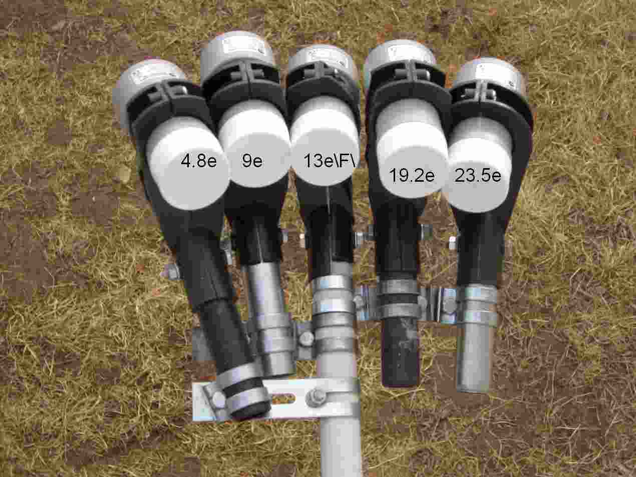

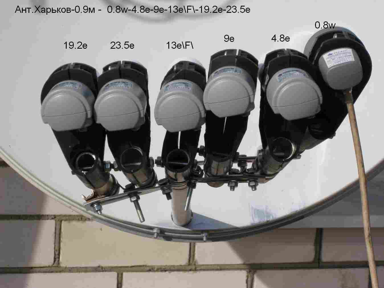

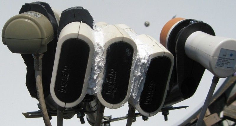

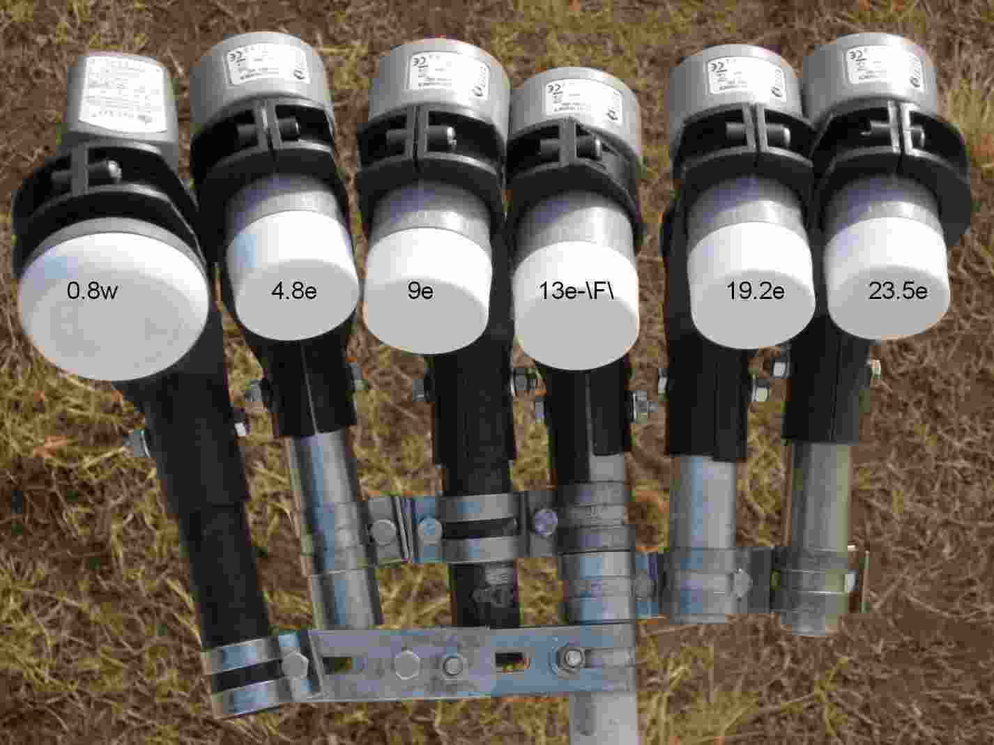

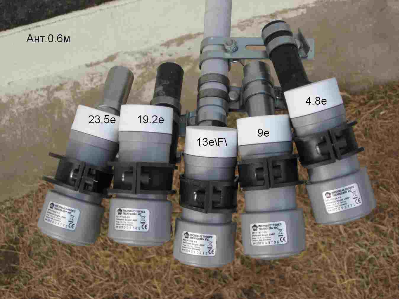

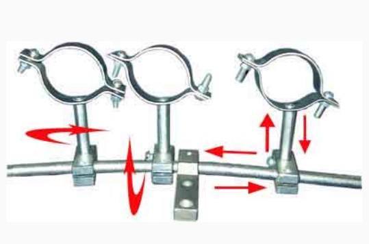

-FaT Air I am-is simple I look at your fans Sat tv much Dish stand with one LNB. I would make to one LNB-F - have added 2-3 LNB. Look it is necessary where live also what signal from the companion. American it is favourable to firms to put a little Dish c one LNB.? us in Europe on another. If the distance between companions can be fixed of 3-6 degrees and a little LNB. I on Dish-0,6 m-strengthen 5 LNB.?? Dish-0,9 m-6 LNB. At me on Dish-1,2 m-ctojat-=stand=-8 LNB.And signal - = quality = everywhere the good. It is all in a KU-range. In-with - a range are popular-2-3 the companion-for them Dish it is necessary-1,2-2,4 m.

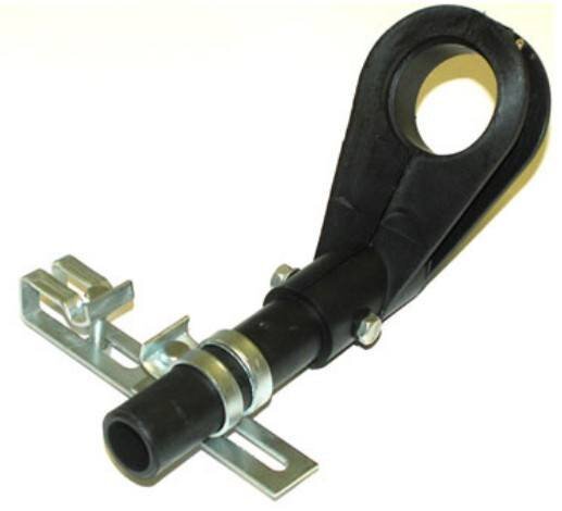

And LNB I apply what fixture. A photo more low.

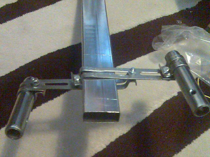

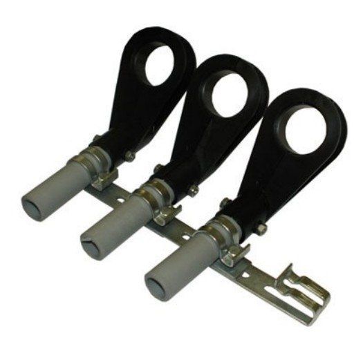

And samples of fixture LNB with-KU - and-C - LNB.

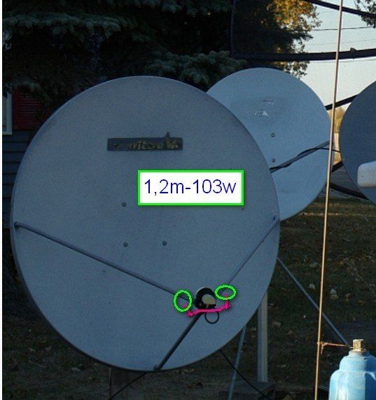

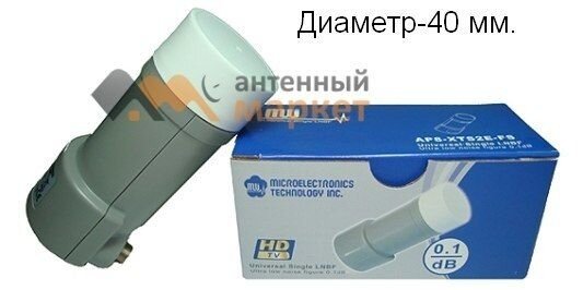

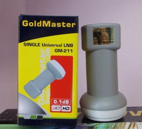

I see they also hype noise figures on the LNBF's there. I don't think .1db NF is possible. Haven't seen a microwave transistor with a NF lower than .3db. Although, it's possible to have 1 in a manufacturing run that measures lower. But what manufacturer can afford to test them all to find them for an inexpensive unit?
I did have 2 LNBF's on the 1.2s for a while, worked well, but once I 'motorized' the 30 inch by mounting it on the BUD, I didn't necessarily need it any longer.

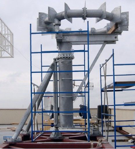

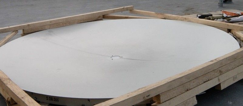

Hello. At you is old Dish, it is not necessary to throw out it on dust. We do from it original drawing.????? and other drawing.

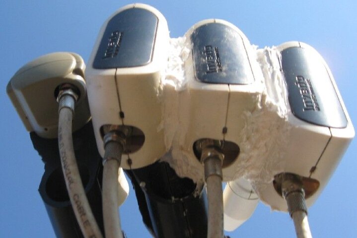

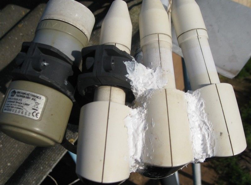

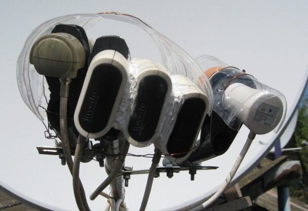

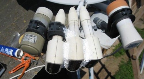

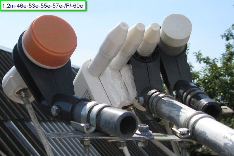

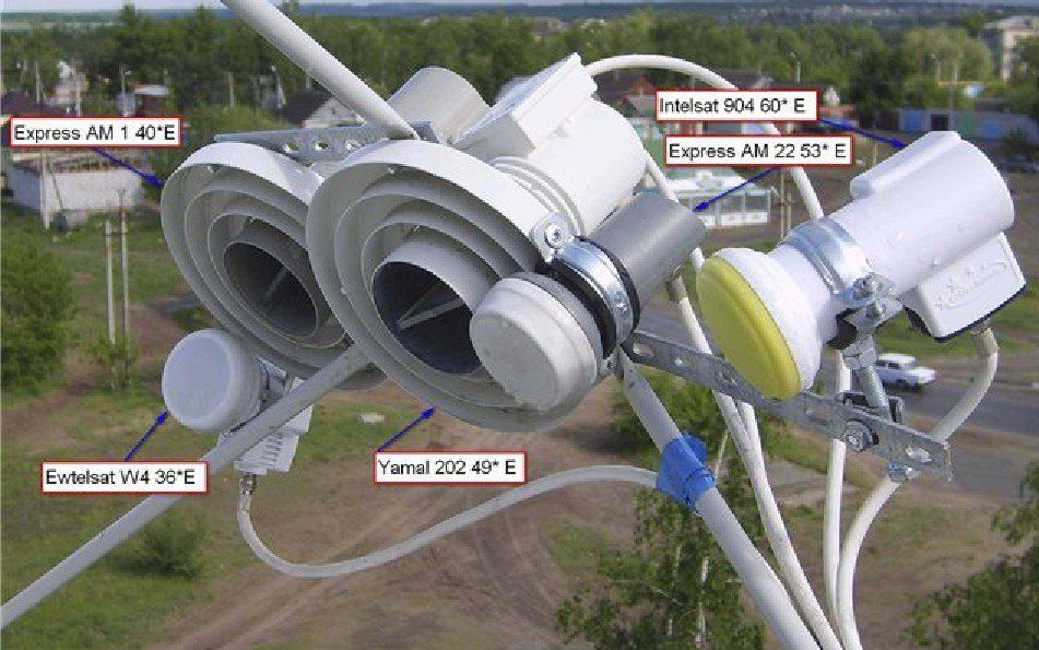

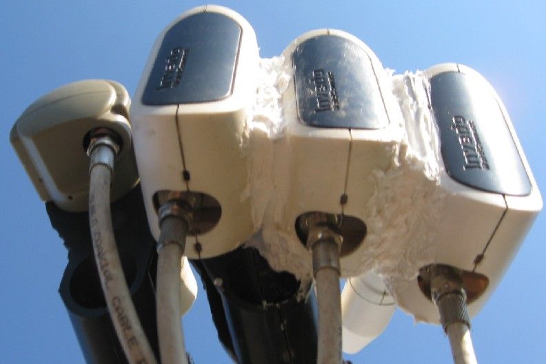

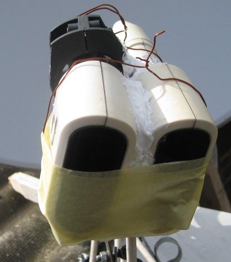

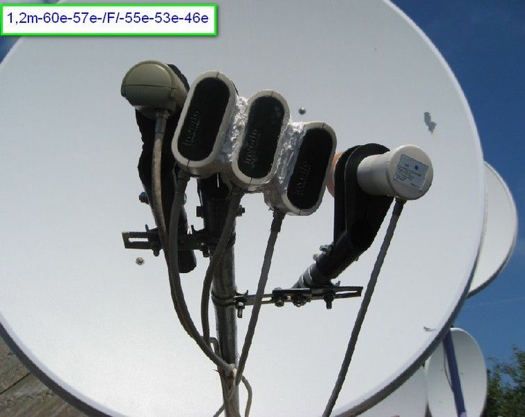

46,0e-53,0e-54,9e-57,0-/F/-60,0e-Dish-1,2m.

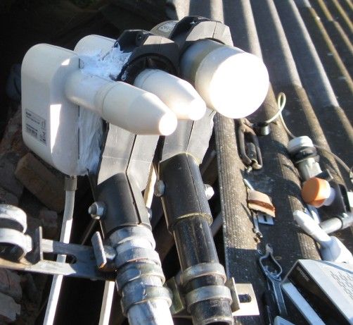

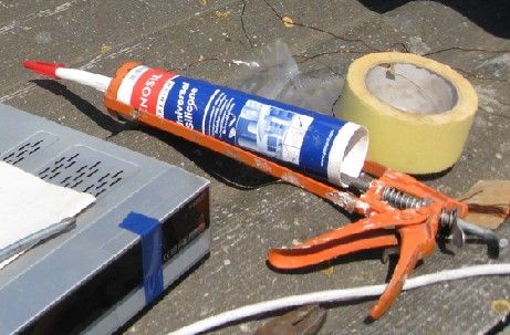

Here such ?????????-46?-53?-55?-57?-/F/-60? has just for fun made at home.

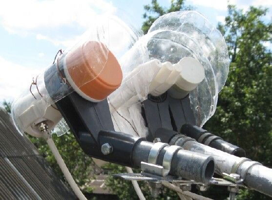

That for this design, took.3 LNB on 23??., 40 and 55??. A pistol with silicone-/for of external works/, I took still an adhesive tape painting and copper ??????.2 a receiver for adjustment. Plastic.????????? LNB for focus, in it rigidity edges lateral nippers to clean.
Has squeezed out silicone on the parties on LNB on perimetre and minutes 5 held LNB that silicone was a little took. And to hold a signal-quality - the maximum
Has taken a copper wire and an adhesive tape-/lipkaja the party from above/.podpravil LNB and 5-10 minutes held that the signal was maximum
In such position of 30 minutes, has allowed to fall asleep to silicone.
Has cleaned an adhesive tape and a wire. Has adjusted the companion 60e-/LnB-40mm./
While has adjusted 60? and silicone has fallen asleep in an hour. Adjustment 53?. Has put silicone on LNB 55? and for 53?. Actions as above at adjustment 55?. To paste silicone-press down-take of 10 minutes
Has allowed pair of hours to fall asleep to silicone. Has adjusted the companion 46?.

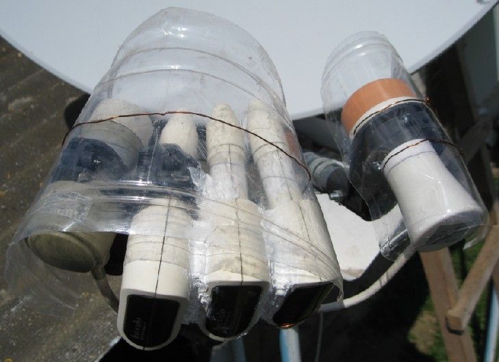

And as it is necessary has established a peak. And that these LNB on 23?? very much ???????????? on dampness various, a rain - snow. To business have gone 1,5? and on 2 l of a bottle plastic.

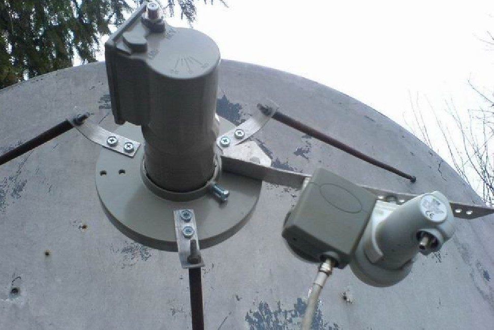

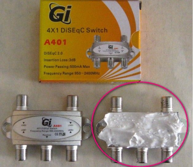

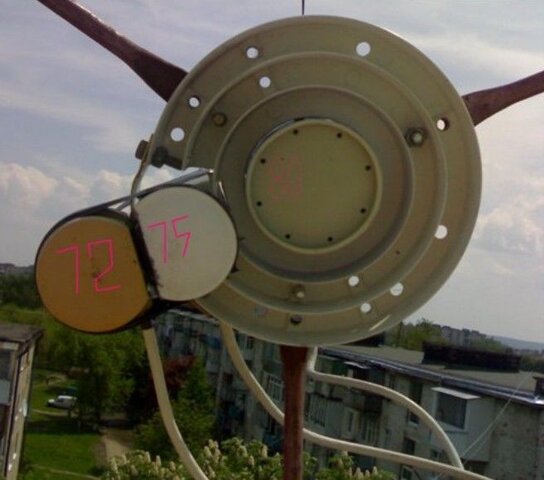

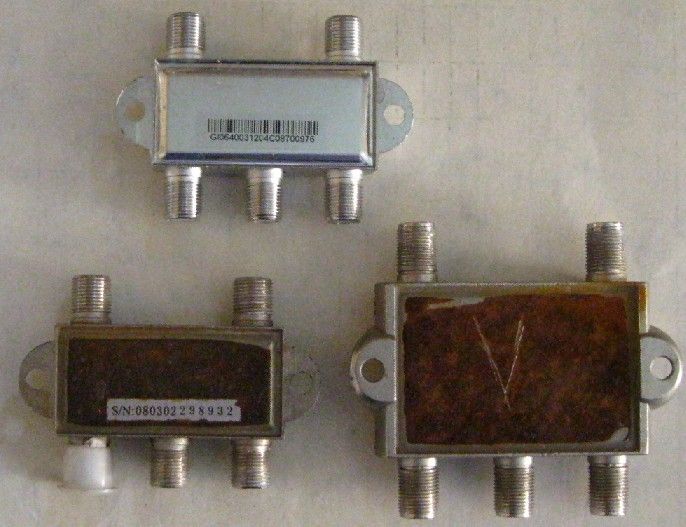

Good evening all. Still my homemade product with DisegC Switch. The thin part of protection of the switchboard and quickly rusts from humidity-water, snow. And it will be after a while signal loss. And that I did not rust DisegC I smear with Silicone.
On it a photo, new Switsh and after 1-2 years of work on air.

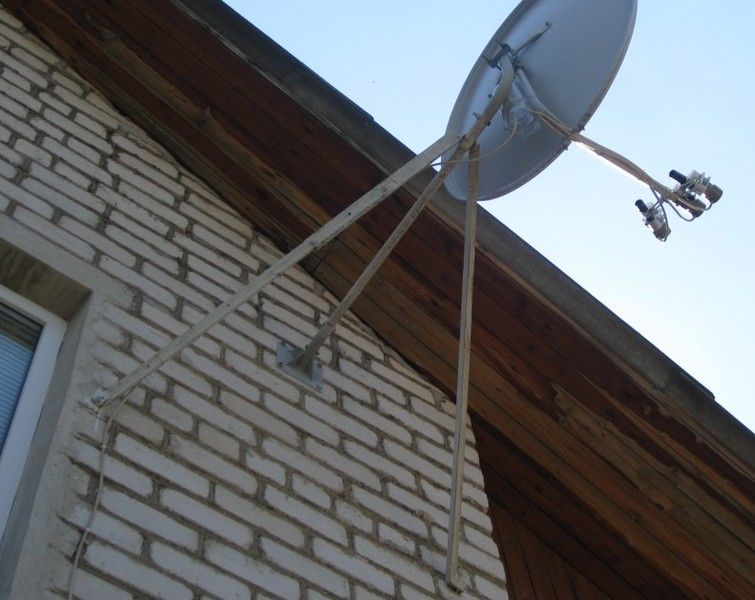

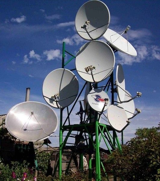

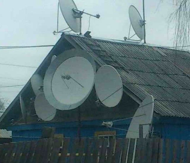

It is my work, to the neighbour has established on 2 floor of the house. The roof stirred, it was necessary to extend with metal corners.
It is a photo not mine. Here it is more than at me. At my place only 7 Dish.

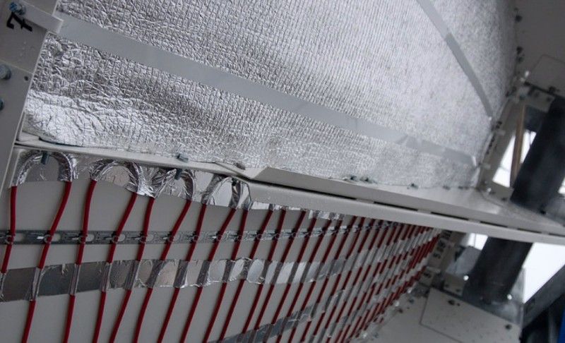

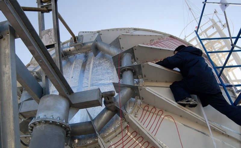

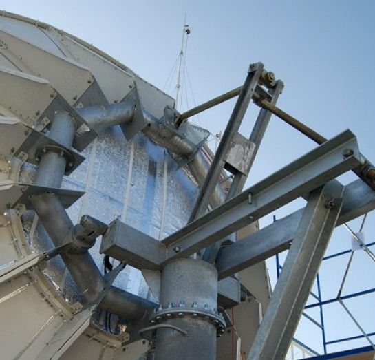

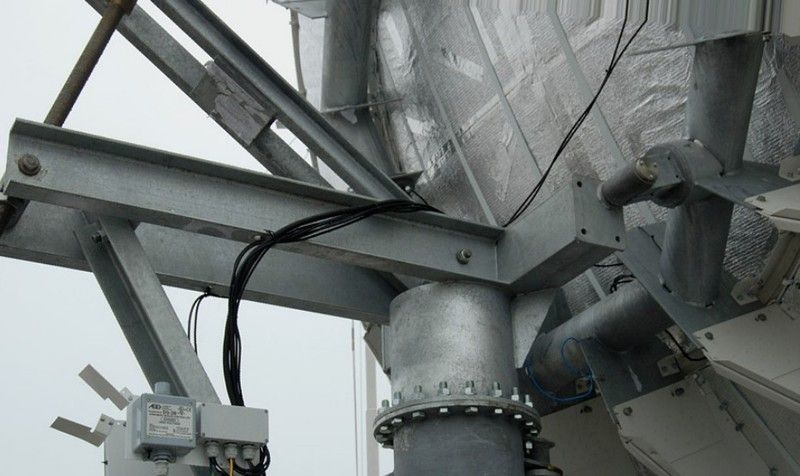

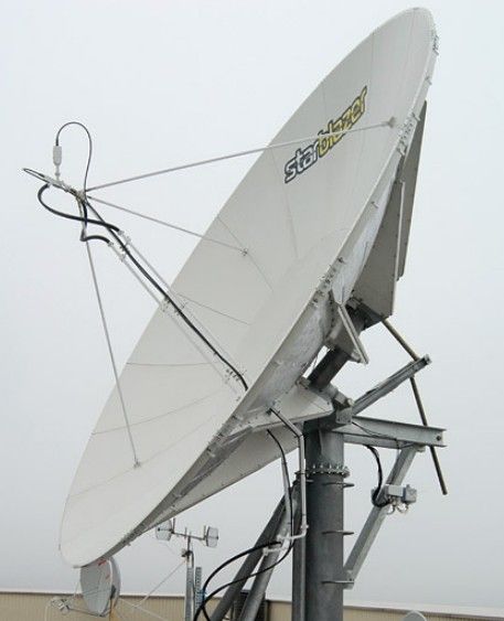

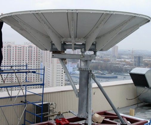

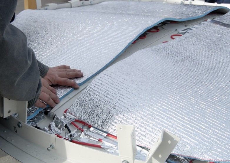

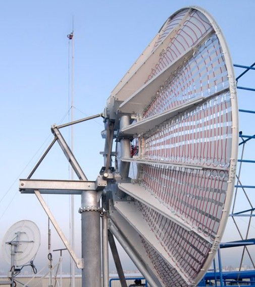

Dish 5 m with heating. Siberia.

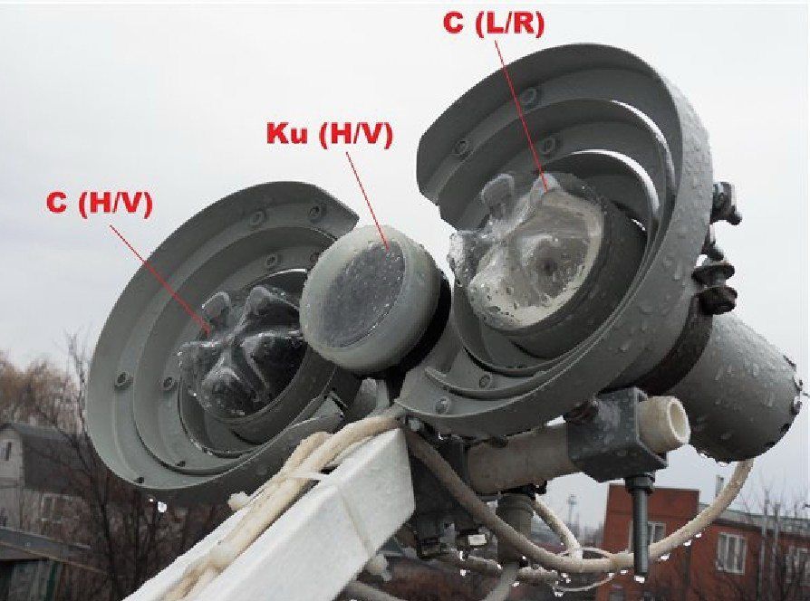

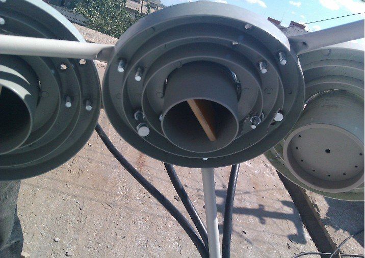

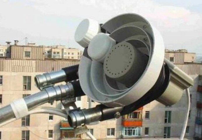

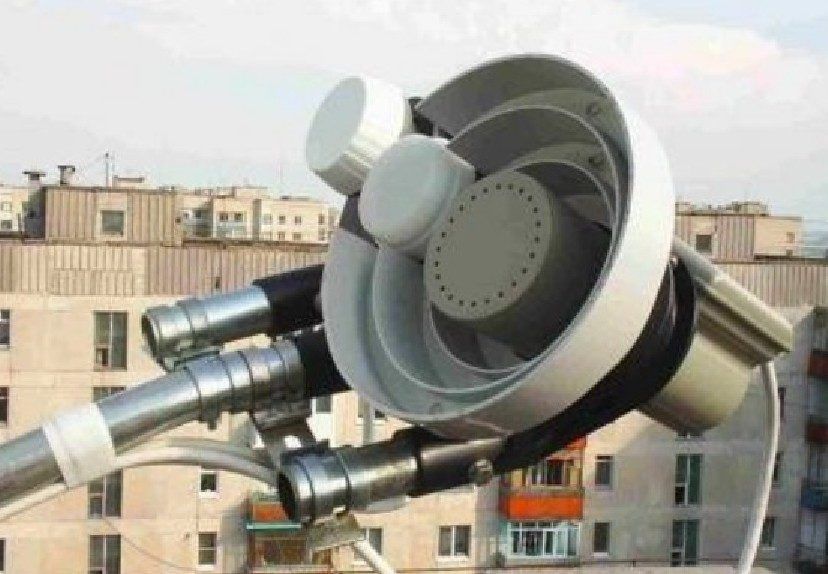

Interesting... Where does the black tubing coming off of the feedhorn go? To more LNBs?
