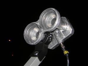

The SC LNBF is a twin eye LNBF called a monoblock and it contains two LNBs fed by co-located feedhorns spaced for 3.8 degree satellite separation. The SC is also not perfectly spaced for the 4 degree spacing, but is very close and the difference will not be noticed by most viewers located in the main footprint of the satellite. Glorystar used to distribute the SC dish and monoblock solution, but the cost of this dish and twin LNBF with shipping was extremely expensive. Very few customers ordered this system.

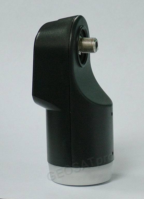

1. A fixed 4 degree dual LNBF clamp with adjustable skew, 2 mini bullet linear LNBFs (the smallest LNBF available in the world and boasting a 0.4 NR with 65 dB gain), two 1 meter RG6 jumpers and a 2x1 DiSEqC switch. The scaler (cap) size allows for resolution under 3.5 degrees if used with adjustable LNBF clamps (see attached LNBF photo).
2. A 4 degree linear monoblock containing a built-in DiSEqC switch. The focal distance has been developed to work with the the 30,000+ GEOSATpro type dishes that have been distributed for Glorystar, Hope Channel, Loma Linda Broadcasting and 3ABN customers. This will make the addition of the 2nd satellite very inexpensive and easily accomplished by the self-installer.

Update with Photo..... GloryStar 4 degree Monoblock with built-in switch
cable
The center one is AMC4, IA5 is offset since the LNB is to the right of the main one, that is what satellite is to the east
The monoblock test mules have 22K switching as it is more reliable than DiSEqC. We will be changing for final production run to DiSEqC for compatibility issues with future upgrades using universal LNBs. Since we also distribute outside of the US we need to think of other markets that will use this monblock.
The rotating 4 degree LNBF clamp with mini bullet LNBFs will be available the first week of June. The monoblock will start shipping in July.
It doesn't really matter which feedhorn throat is mounted on the LNBF clamp. There is a slight loss on the offset feedhorn, so it would make sense that the satellite with the weakest transponder be placed in the clamp. In the case of the Glorystar, we will recommend that feedhorn 2 (IA-5) be placed in the feedhorn clamp since IA-5 transponder frequency 11874 is the weakest transponder of the Christian channels and could benefit from even the slightest gain!
