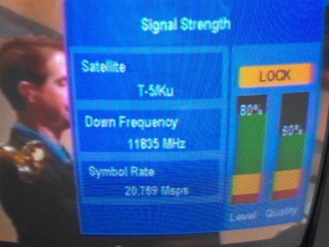

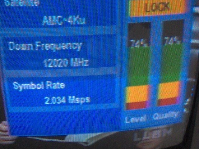

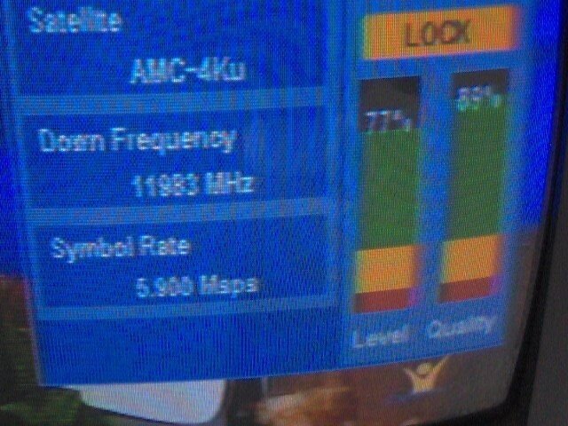

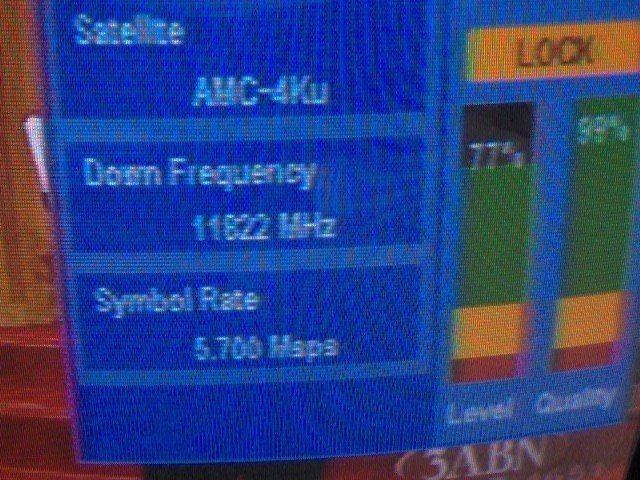

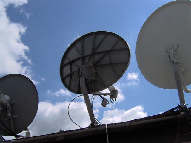

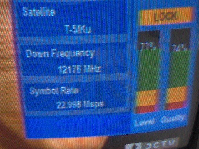

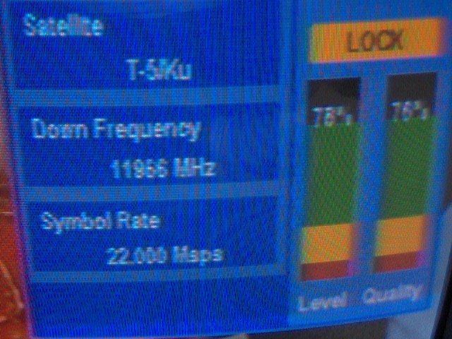

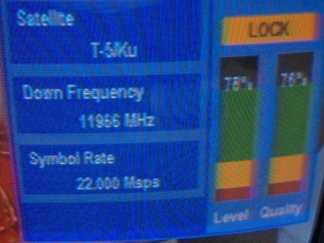

Took my SC 75e dish (37x27 inches) and aimed right at 101. My numbers were
38 elevation
188 or so azimuth
+6 skew
I just went to Sadoun's site and put in 99 as my satellite (1/2 way between)
All TP's on 101 (religious ones) between 75-99
The TP's for Religious programs on IA5 between 60-77
I tried to get the best of both as the LNB is separated by 3.8 degrees, not 4 :)
Pictures in order
-the Dish aimed at 101/97 here in Minneapolis
-quality for TP with 3ABN (AMC4)
-quality for TP with Esparanza TV
-quality for TP with LLBN
-quality for TP with Daystar (IA5)
-quality for TP with Word & Miracle Net
-quality for TP with the TBN mux

cablewithaview said:
I take it the white wire was for re aim? Nice job, o' BTW the question I asked on your receiver setting.
yep. The old 25 foot cable...been used way too many times :)

Setup is as such
101 would be
LO 10750
22k on
97 would be
LO 10750
22k off
one cable needed and you can easily switch between channels with no extra switches needed :)

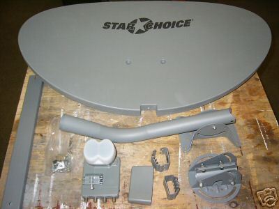

Iceberg done a demo on this and posted it. This was something I was asking about in a previous post which got spinned over to here. I think it was GloryStar or one of those selling a FTA set up with the single dish for both satellites but I wasn't for sure which one. But if you can't get one, then E Bay has some StarChoice dishes on line for sale time to time. The newer SC dishes for F1 & F2 would be what you would want, size 75cm. I uploaded a picture of a 75 cm SC dish, notice the lnb in this picture. Something like that is what you would want. Follow the settings Ice gave and you should be set.
