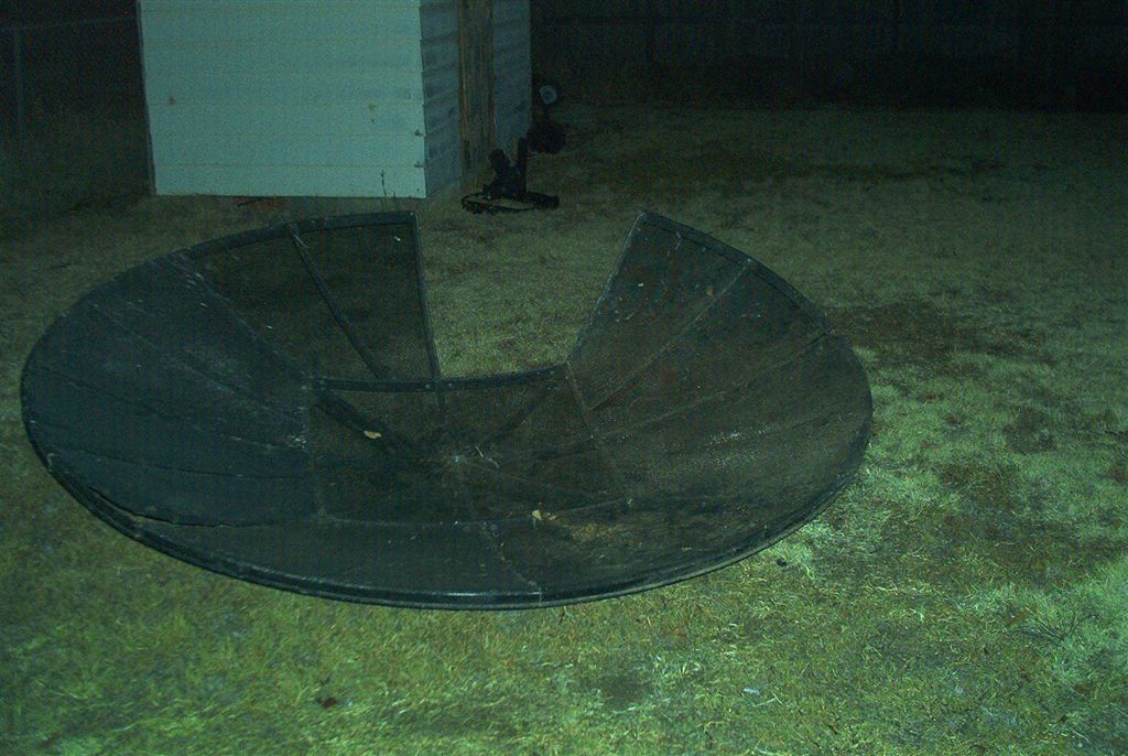

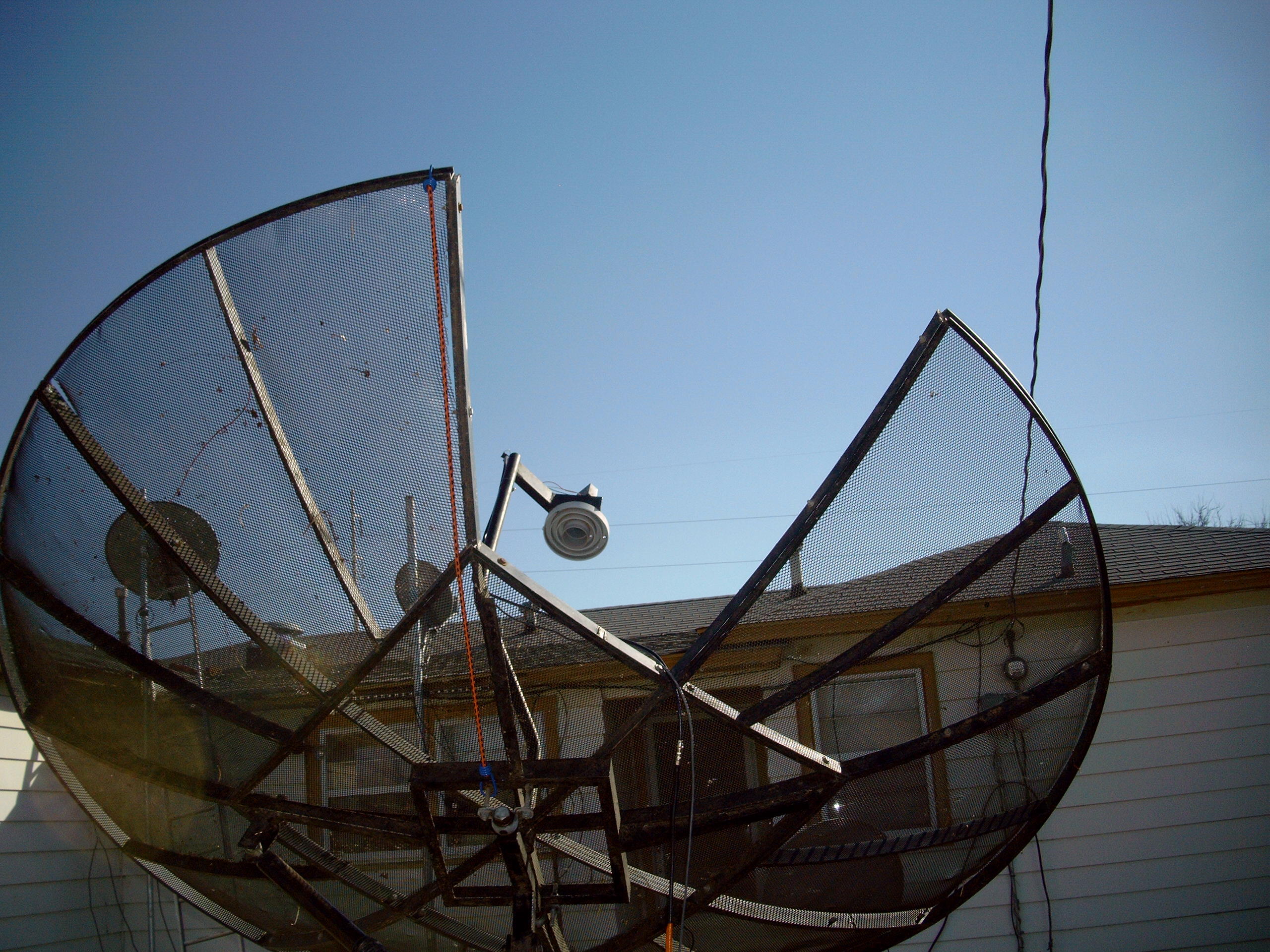

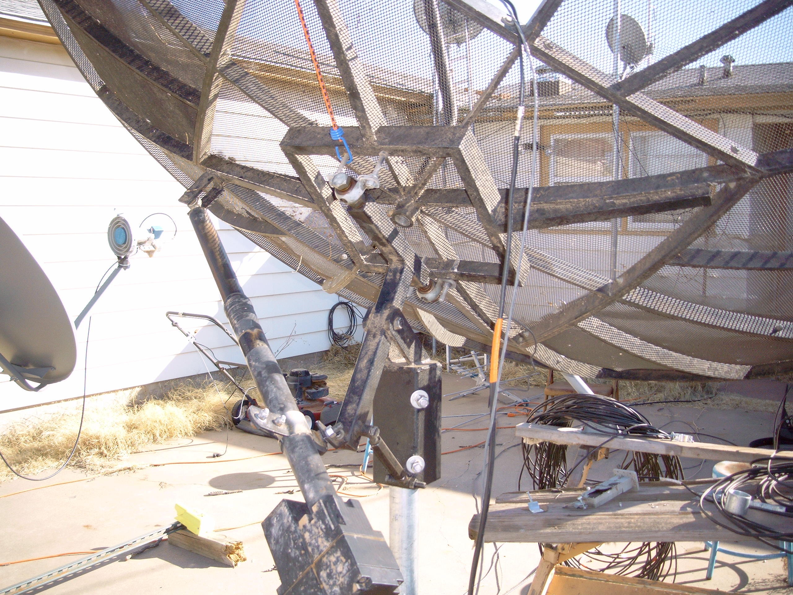

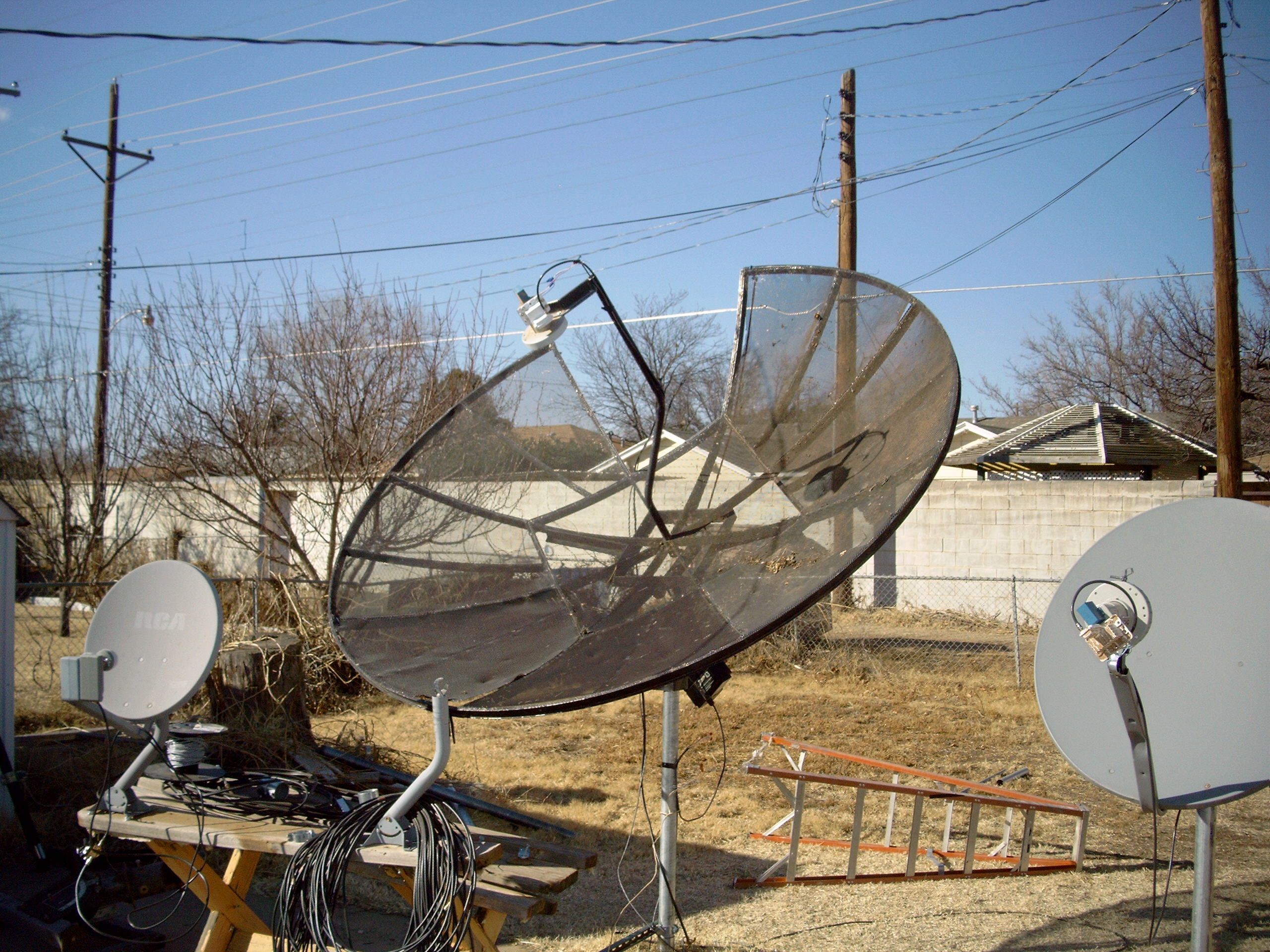

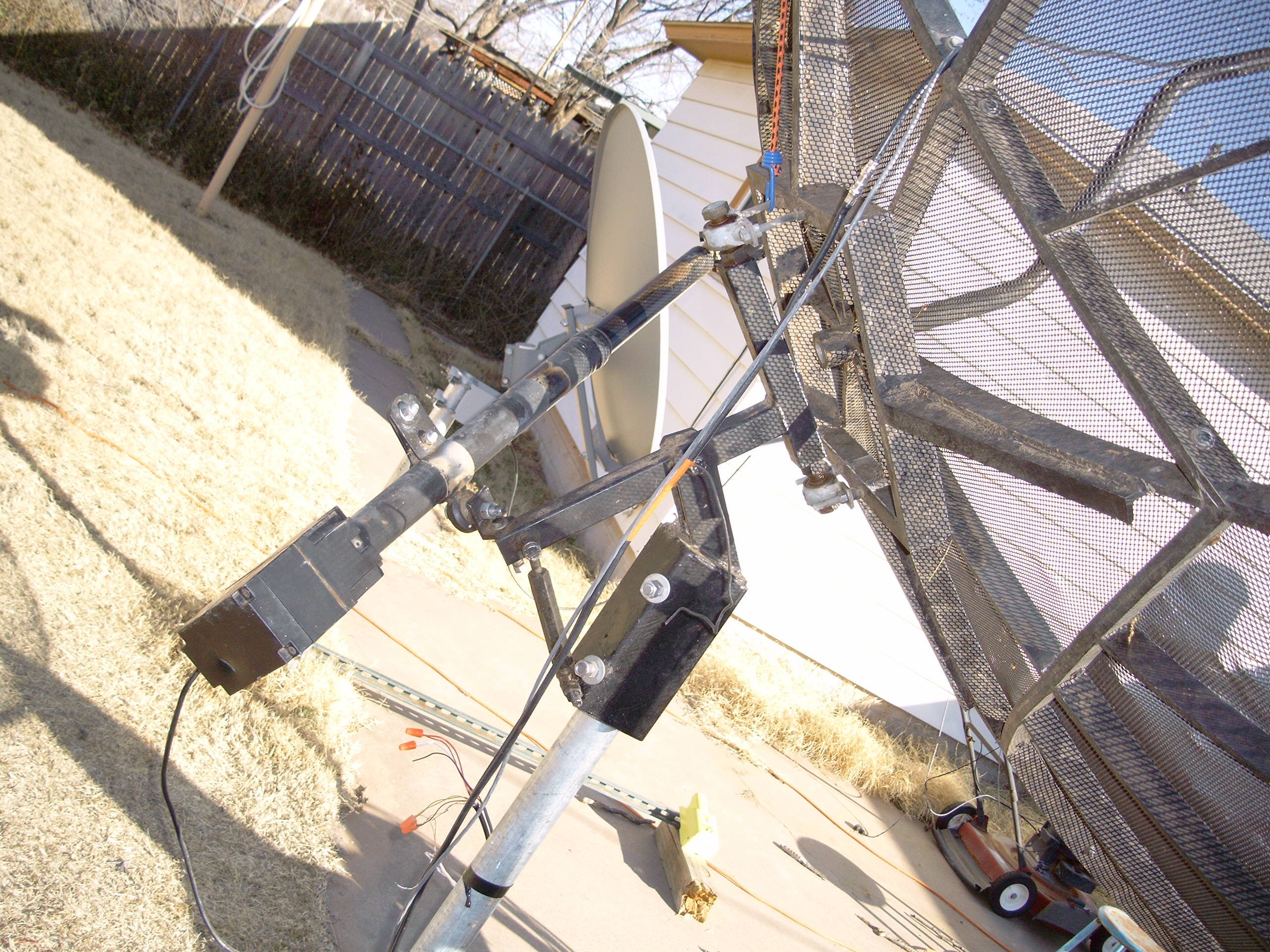

Thanks for all the help and advice . This is just a temporary instalation . A permant instalation will come as soon as I get a chance . :-)

Good to see you have it up. I would find some stainless steel wire and tie across the gap at the top and in the middle.
Good luck with it.

If you look on one of the photos , you may see a bungie strap on the broken rib . Need to make a couple of brackets on each side of the break . Then bolt/screw/pop-rivit the brakets in place .
Then make a part to replace the missing part of the rim . I have some galvinized roofing flashing sheet metal that I may use to fill in the gap .
Thanks to all for the help figuring this out .
